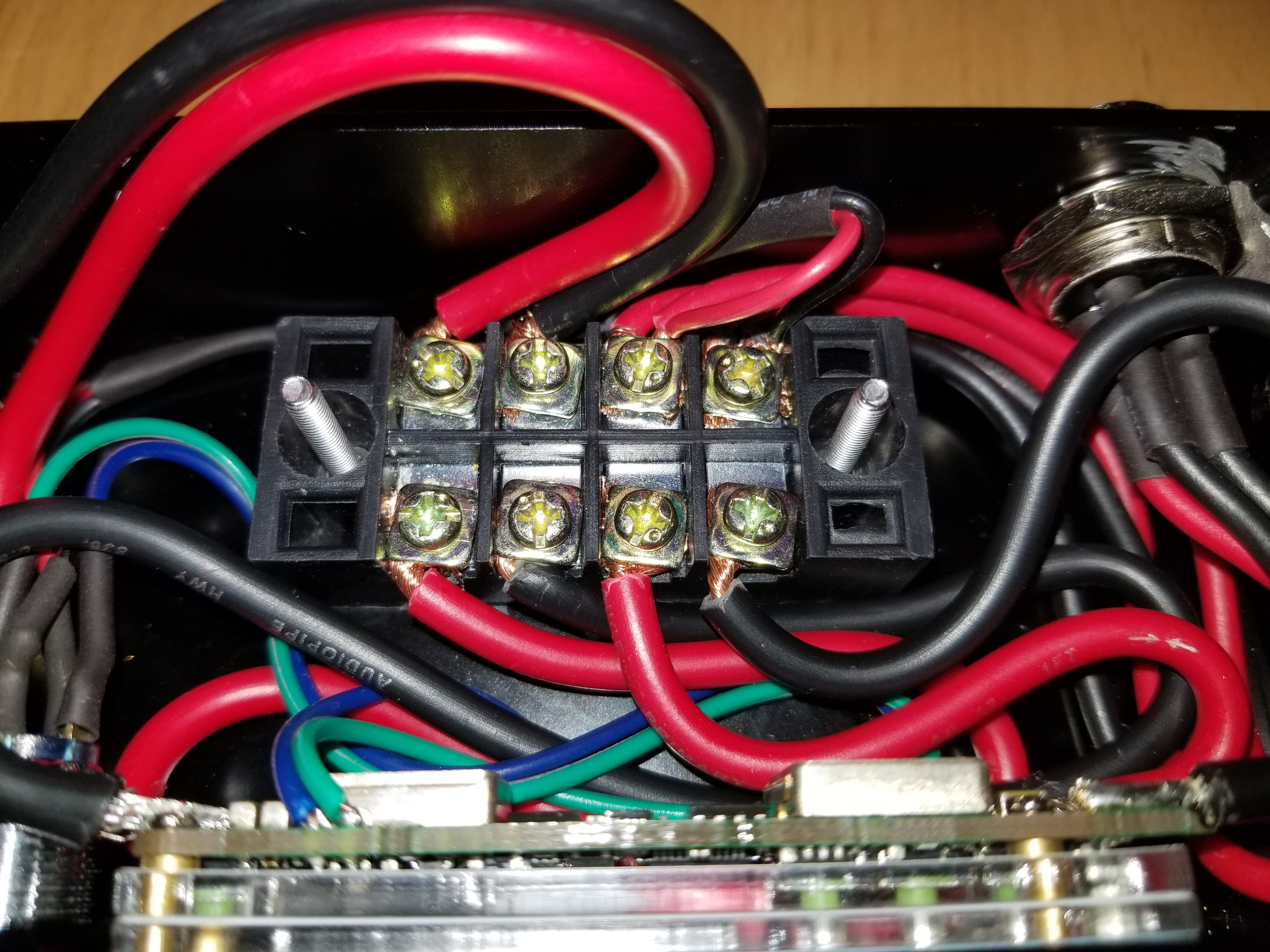

I completely agree that post is horrible and long because of the pics. I just missed the edit deadline lol. Solid idea, hadn't tried it. It reads 6.37 volts when set to 9 volts. Exactly 3 volts below input. Which is what 9.38 was to the 12.38 volts I was running to account for Vsag during firing, exactly 3 volts low. While I don't have a picture of that I was able to get my witches hat probes from my o-scope and hook it securely so as to make contact with the pad and cable. Its a solid connection. (as we see from above it's likely not a connection issue). That Meanwell supply doesn't sweat this. I fired a 100 watt load into a ceramic resistor for about 20 seconds and it was rock solid at 0.16 sag (not bad for these supplies). It didn't budge at the 45 watts I asked of it for a true load heh. I gave it a visual inspection and connected it to a breadboard to test functionality out of the box. (didn't think to check this) After that I used fine tip to add the remote firing wire, put it in the sled and treated it with great care. I just disassembled it again, (thanking myself for putting in that terminal block) the board itself looks day-1 new sans the resin from my soldering. I inspected the ICs nearest the pads for burning and the like and everything looks good. I didn't rest the iron on a capacitor after all lol (phew) FW: Yeah, pretty sure when I first fired up escribe there was a message saying there was a newer firmware version and I let it go first thing. Firmware Version: 1.1 SP33.2 US Revision Code: 311103395 USB Vendor ID: 268B USB Product ID: 0419 USB Product Version: 3.0 If it's just a reporting issue or mis-calibration (which it seems to be as it feels identical to my other chip at the same settings) then ill just keep this one for play and buy another for the final revision... One without a terminal strip. Thanks. Crit. (the final one will probably still have a terminal strip heh) -

Alright. So I 'read' the manual. And I googled around for a while hunting down others voltage issues but everything I find is battery related... I think my case might be a little more specific. So let me preface this by saying i like to tinker. So decisions were made to ensure that I could change things around often. This should take care of things liked "dude that is a-lot of wire" and "Why in the f**k do you need a terminal strip". Since I am also a fan of over-building everything we can avoid things like "Bro; but it's barely 4 amps!" or even the occasional "you can get cheaper better built ones online". It's just a simple passthrough box (screenshots attached) with a terminal strip to terminate all connections. Easy to take apart and put back together and modify. This is far from its final form, just a proof. I'm coming over from a GENE chip (the drag) because it's time to leave batteries behind. I got the 250c because I can't help myself, easy enough to justify with a "just in case" --right? I got the giant case because I have big clumsy hands and limited to moderate patience when the lower back starts to ache from hunching over to work on tiny things in smaller places. The power supply is a genuine Meanwell LRS-150. Will be connected to a LRS-350 for the full 30 amps when in final use. So that I can use all of 45 of those 350 watts... That out of the way lets talk about 9.38 volts. And why the DNA chip seems to think that's what its getting. * Plug in brand new chip. Apply 12.25v. * Plug in USB (5v). * Download and push latest firmware and reset * Generate custom material profile based on COMPLETELY TRUSTWORTHY(tm) Reddit information. (screenshot attached) --- TC/r value. To: 0.00240 --- Temp sensing (of course) * Set the custom values in the profile. (Screenshot attached) --- 45 watts --- No preheat --- Temp cap 525 --- No replay --- Locked resistance based on new coil 24 hours at room temp. * Push to device * Satisfaction (until i check the diagnostics) Wiring is 2 runs of 16 gauge for power and ground from the PSU to the block. I would love to have used 2 runs of 12 but the aviation connectors wouldn't have it. Speakon for V2 if this proof of concept works. 12 gauge for everything else. Seriously disappointed in the stock pad-soldering solution for a supposed 400 watts. That's it really. Thing performs flawlessly at these settings and feels exactly like my GENE chips at the same (converted) settings. I just don't understand why the chip is reading 9.38 volts. Doesn't behave like its under powered, still need to get my shunt and ammeter in the loop to see whats up in that regard. I understand every time you add a link in the chain, another connection, another length of wire, another terminal and so on you add resistance which can effect voltage at high power levels. I scuff-buff-n-clean all my connection points and solder joints. Clean all conformal coating off and pre-tin the pads and wires. I also fully admit I solder with the dexterity of a ham-fisted gorilla on methamphetamine. I have tested every link in the chain repeatedly with a multitude of multiple multi meters and displays of varying known offsets. I know beyond a shadow of the doubt I had the 3rd time I de-soldered EVERYTHING and re-soldered it; those pads are absolutely mechanically and electrically connected. Thanks in advance. Hope I just dun-goofd' a setting somewhere. I'm worried I cooked it during some of that professional soldering..... Had fun writing this up and getting the screen shots though 😉 -Crit (bonus points for why it thinks it has 3 cells when i didn't even so much as solder on the connector)
