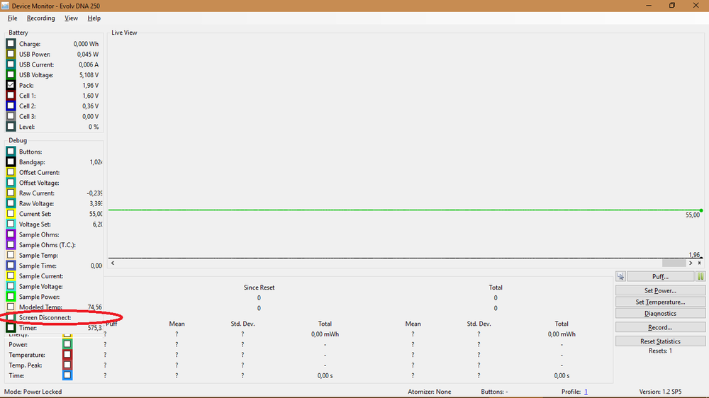

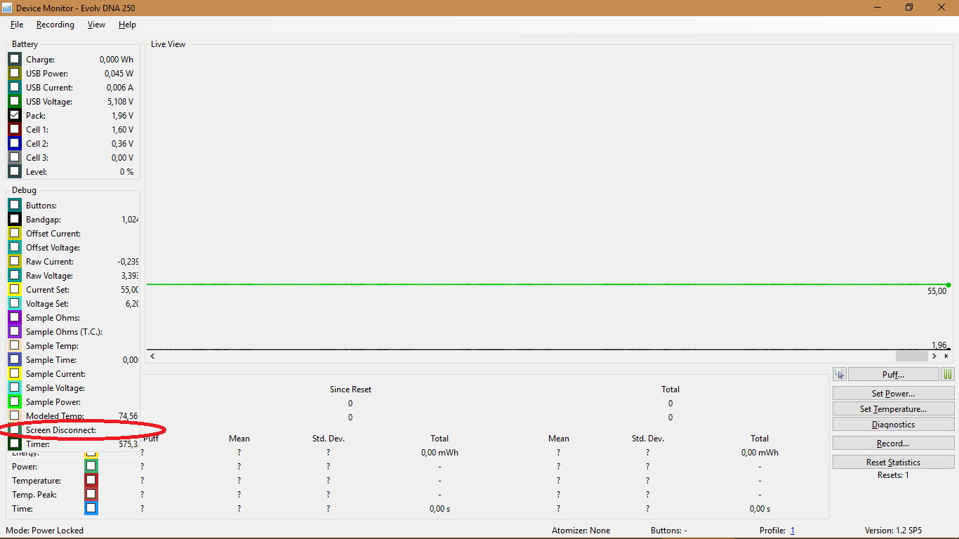

  4. But my other one turns on when connected to the USB...? Even when both have no batteries, why would one's screen be on (albeit really dim), but the other's not? Yes, none of them have batteries in them. Isn't it the case that each unit draws the same amount of power? (The batteries are currently charging as they are new.)
