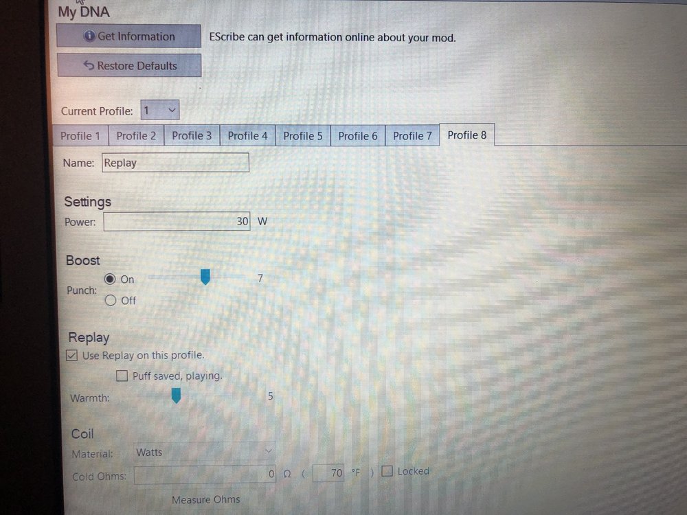

Ive uploaded the Generic DNA Enhanced Theme with Replay. It shows profile number 8 labeled Replay, the Replay box is checked as instructed. On the device there is a empty box under the text Replay where Cancel or Playing normally resides which does not change with a puff. I went to the Theme Setting then Theme Designer and then went to File Save as... now what? -

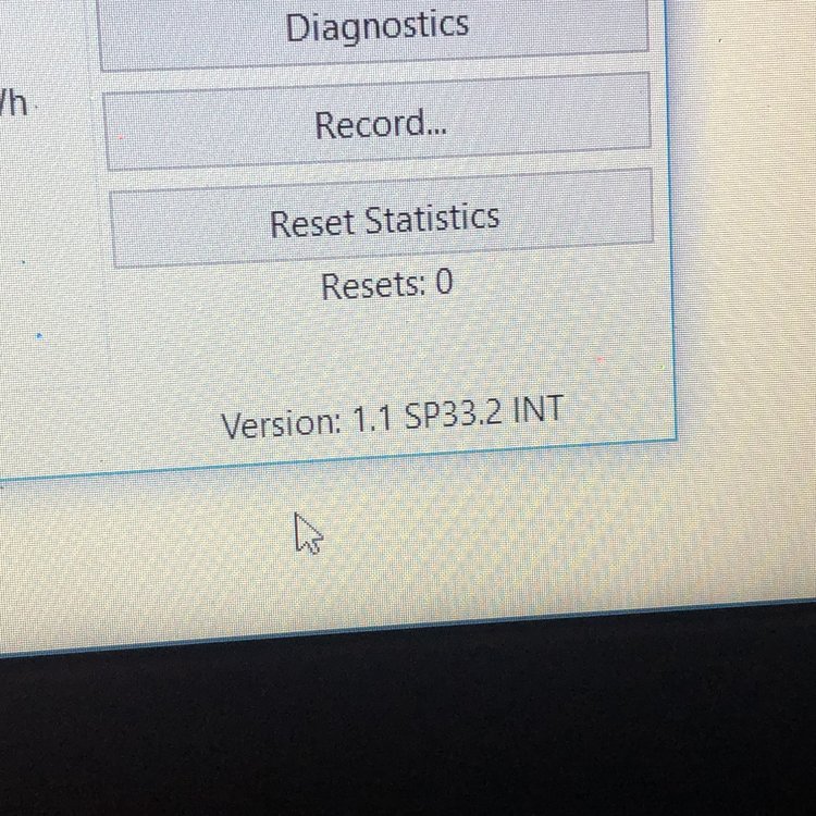

Ok sorry to getting back to you so late. So the device firmware is version 1.1 SP33.2 INT and I’m using the Lost Vape Therion DNA75c Theme with Profile 8 labeled as Replay etc as instructed. Uploaded to device and no Replay that I can find. Im sorry but I don’t know how to do a screen shot. -

1. I have 2 Therions and a Paranormal all of which were upgraded last spring to include Replay without any issues. I now have 3 Mirages and 2 Thors all with DNA 75C none of which have Replay on them. 2. Id love for all of them to have the same setup 3. I'm on SP 19 INT firmware 4. I reset to Evolv Default settings but Replay isn't even listed in any of the option in Current Profile 1, Profile 8 5. I have all the settings checked the way its displayed in your response. Should Puff Played, Playing be checked to on? 6. I did jiggy last year but I don't remember what I did when Replay became available except upload a Theme that included it. 7. I can use TC without needing Replay but its nice to have the same vape each draw instead of having to adjust it Thanks for your help -

Hi Wayne, I have several Therions and Paranormals that I Uploaded Replay successfully last April but for the life of me I cant get it to work now on 3 LV Mirage 75C and a couple of Thors. International Version V2.0 SP19 I tried downloading the SP33 but it just comes back to this one. Maybe I should uninstall then do a clean reinstall? Ive tried several Themes that include Replay like DLBs modified, Franks Mirage w Replay, and Clean Colors which all include Replay. The Replay box shows uo but it is empty and unable to select it. Ive uploaded Replay previously on my Therions and Paranormal so I'm stumped . You mentioned sending you file. Let me where I find it Thanks Sara -
