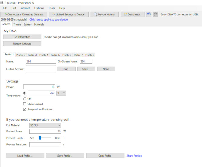

  3. I remembered I had a spool of Titanium from before I started using SS. I thought it would be a good idea to eliminate the material as a possible source of the problem. So I setup a Ti profile and so far its working perfectly. The real test though will be overnight and a few days to see if the problem has really gone away since its intermittent.

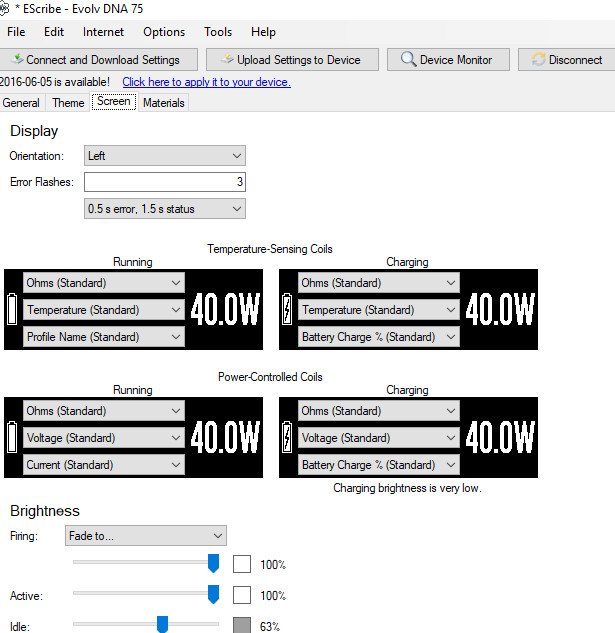

  4. The screenshots are from different times, and I made all the profiles the same to rule that out early on. It seems to be intermittent. I had TC working before I went to bed, woke up and it wasnt with no changes to the settings.

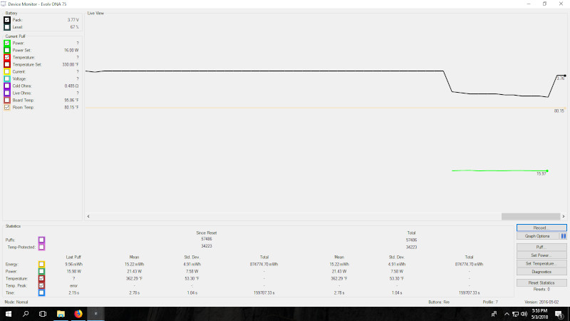

  5. Clicking on the atomizer check its fluctuating a little on the third decimal place. Its also reading Kanthal. I know its SS.

  8. Mod - Jac Vapor Series-B DNA75 Coil materials 304 and 316l have been tried, same result. Restting Device to factory has been tried. I have a mod that I dont think is working in TC mode. I cant see the temp in the device monitor. It also has the Power screen and not the TC one. I was using the Linux escribe software newest version, but changed to a Windows 10 computer and reinstalled Escribe to rule it out, then rest the device. I have tried multiple atty's. Pressing the button while in the profile with Temprature dominate the temp changes to OFF. I hope its just stupid user error.
