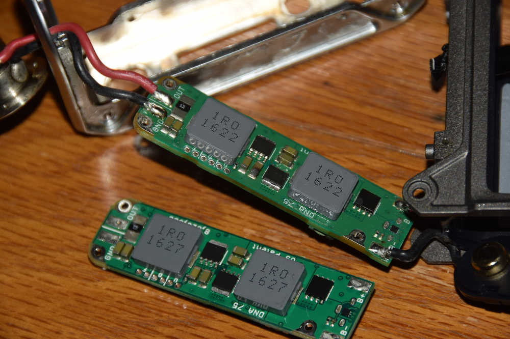

Gents, I just bought a 2nd hand Therion BF and I'm pretty sure its stuffed. Just looking for input or other ideas. it works and hits fine, but it is CONSUMING the battery at pretty high rate (like dropping a percent or two PER HIT) and the faceplate is damned warm. Im running a Goon LP on it at .25 ohm, with an LG HG2. eventually it started giving me a "too hot" message and wouldn't fire anymore. This was after 2 hours of normal use, and the battery was then down to 40 percent or so. SO I swapped in a VTC5A and left it alone for an hour, and that battery lost 8 percent just sitting at idle. And its still pretty warm despite not having fired.
	So, batteries are out of it and I am deciding what to do. FWIW I also have an old normal DNA 75 Therion so I know this hot faceplate is abnormal. I run roughly the same .2-.3 ohm builds in it, with 2 HG2's and just about always have it last all day (and usually only just below half full on battery by the end of the day).
	Looks like there is something wrong with this new one. Explains the price. (no I cannot return it, bought it thru online classifieds). So has anyone run into this before? sound familiar to anyone?
	I am debating between ordering a dna75 chip and just changing out the board, or taking apart my old Therion and swapping the boards out (my old one looks pretty rough) I'll give it a few more days of playing with it to see if I had a bad (or fake) battery in there, but everything is pointing to it draining the batt all the time and warming up as a result.
	edit-
	Just tested it again, by putting a fully charged LG2 in it and leaving it sitting with no atomiser. an hour later its warm and the batt is down to 93%. Buyer beware I suppose. Looks like I'll have to take the damned thing apart and most likely replace the board. I'll still come out ahead, and its in immaculate physical condition, but that doesn't make it any less annoying. Still, if anyone has run into this in the past I would be all ears as to what to look out for.
