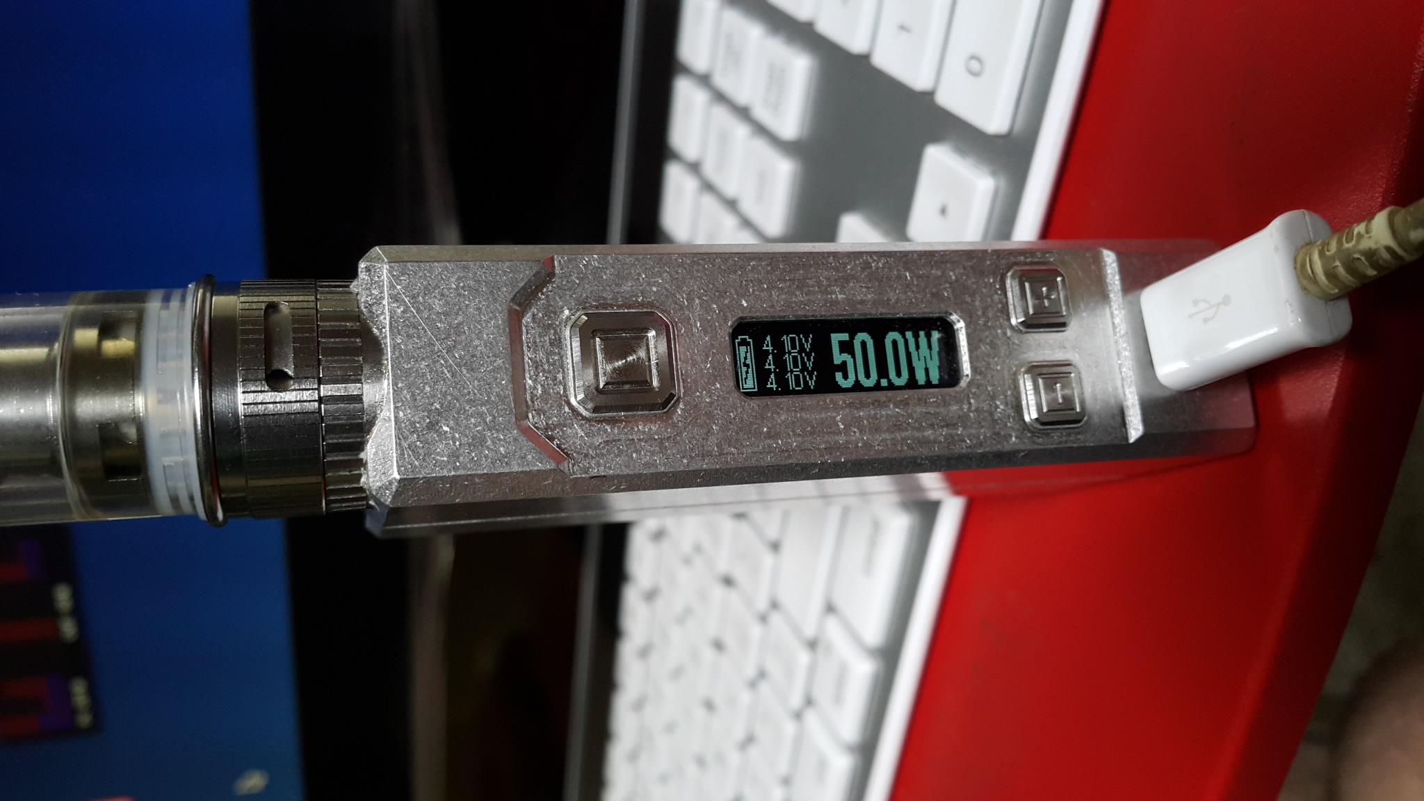

  3. It took me 6 cycles to get my battery to fully charge. The #2 cell would only get to 4.1v and would discharge faster. On each new charge it would increase and finally is now getting a full 4.2 on each cell. With this now full battery on a dual coil 26g Ni, .06 ohms at 460F and 60 watts I am getting around 300 puffs which is less than a normal day for me. Preheat set at 100w midrange. I take very long 6 to 7 second direct lung draws. Not great but I can live with it. My Mamu boss with a 2200 mAh lasts all day and still has a 25% reserve.

  6. Have you tried jump starting the low cell. If you do not know how, find a RCer to help you. Escribe has a program to jump start a bad cell but it did not work on two of mine. Still had to do it the old fashion way. Test the cells with a meter and see if you really have a low cell. Balancing chargers will not start charging if one cell is below minimums. To jump start you have to hit that individual cell with a 3.7v charge for about 10 minutes to bring it up over minimum and then the balancing charger will recognize it.
