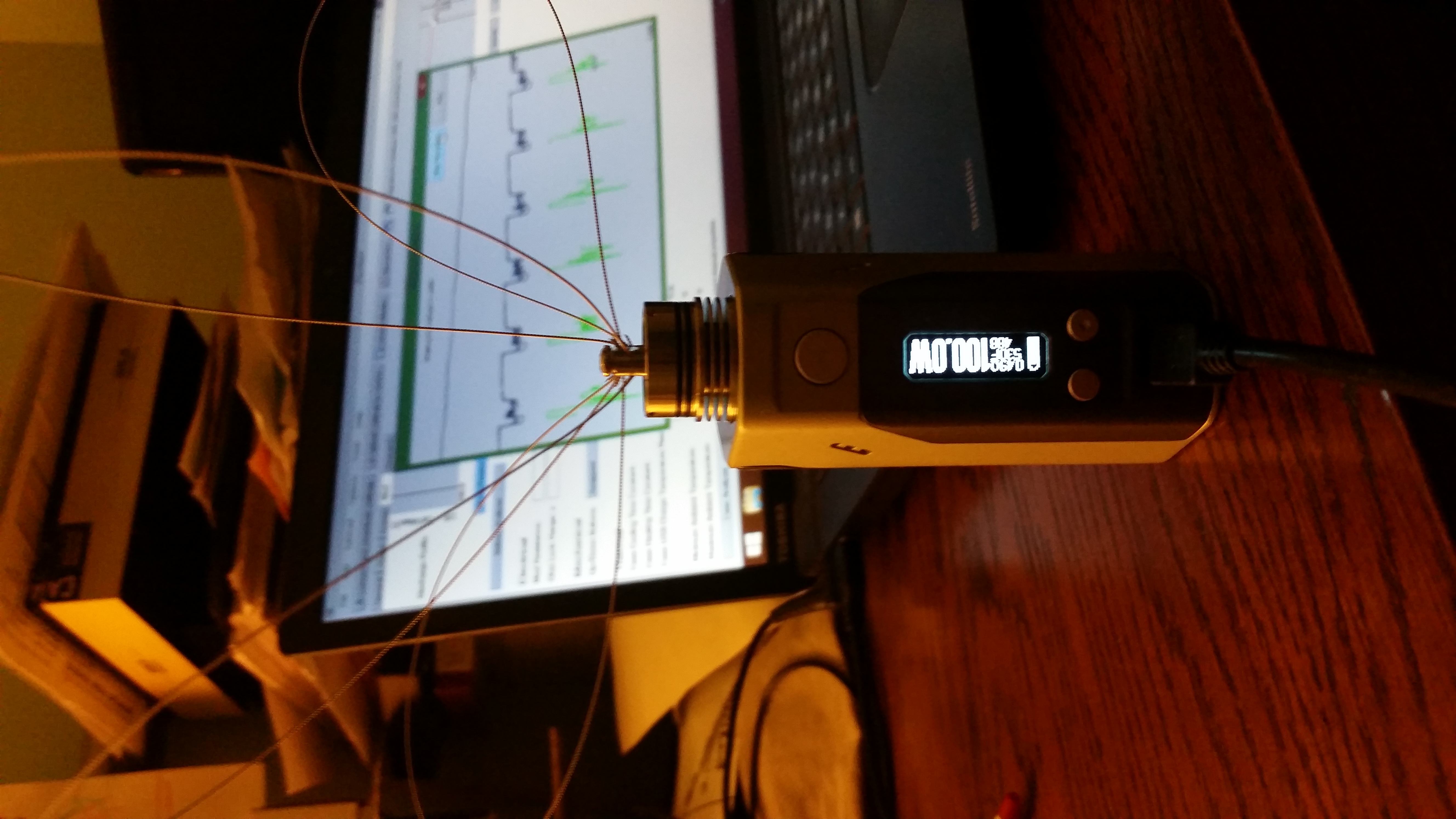

Hey so in escribe (while the mod is charging via usb inside escribe) i notice when my reu is sitting on the table as it should the temp was ever increasing to 98*F when i couldnt take it anymore and flipped it upside down and immediately the temperature began to drop (finally resting at about 73*F). I recommend charging the batteries in this device with no atoizers connected and sitting upside down with the 510 connection flat on the table, exposing all air holes better. 1.)Did you notice when connected to escribe when you reach a ful 4.2v charge instead of remaining charged the batteries begin to discharge? 2.)Also when i input usb amp i set it to 1.0A why does it only charge at ~0.5A on escribe, does it do this at the wall also? (with a 1.oA wall charger does it only receive ~0.5A?) When the mod is connected to a 1A charger at the wall (not on escribe but through usb wall charger) it will charge to 4.2v and remain 4.2v
