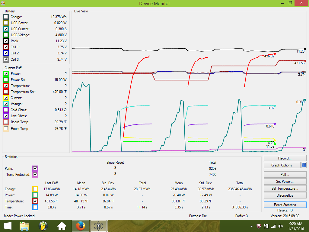

  5. Im planning on getting a silicone case so If i drop it the batts don't fly out. What would suck equally breaking a glass tank or distorting the 510 connection threads

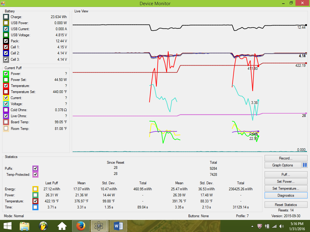

  7. So i received the new batteries today and charged them externally, married them, and ran the exact same test as before except for one thing i changed the mod resistance from 0.0016 to 0 The new batteries are 23.82 wh so wow very close to the original results way to go i did notice one other thing over the past day and now somewhat verified through this test: when the mod was firing 100w it was reaching temperatures of up to 542F to maintain the 530F temp setting and i have changed the screen to display last temp instead of watts and it showed when firing at 530F (up to 542F) last temp was showing on average 486F why? the test results were so similar, as you can see the files are very similar samsung25r_23_82wh.txt

  11. so don't you do case analyzer to find the mods internal resistance? the internal resistance didn't change when i ran the test. i had it set to something (0.0016) i figured it would change to the correct one. or is there somewhere else to do the internal resistance?
