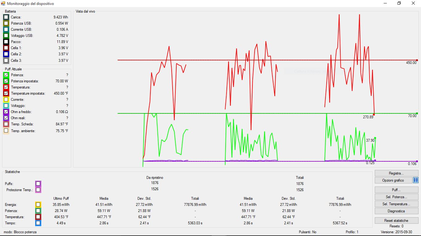

Got my 2nd DNA device (vtbox 250 fullymax 1500mah 3s, 25c) and I noticed that while charging, the device turn on to active mode randomly, and this is happening many times during the charging. In that scenario, USB current drop down to raise up again very fast, as like as I removed current source. I also noticed that this doesn't happen while charging to my PC at 1A, but only with a 2A wall charger. Tried to change it with another 2A charger but nothing changes. I confirmed all this situation by monitoring the device with escribe: 1A current, usb voltage sometimes go down, but in this case (PC charging) my display won't turn on from idle state and doesn't show usb current drop down.
Anyone can help me to understand is this behavior is normal for DNA charging mode? Thanks
