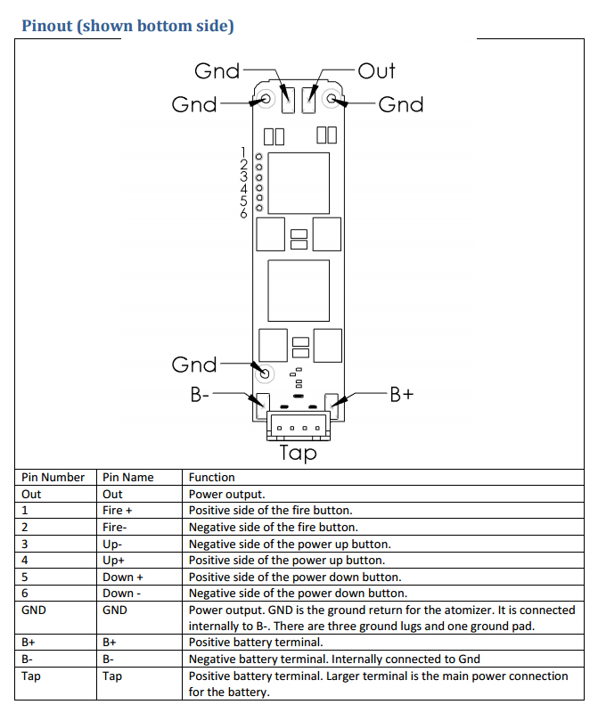

If you want to add external buttons, here is the info you need I hope you can connect the light directly to the OUT with the resistor btw ! -
