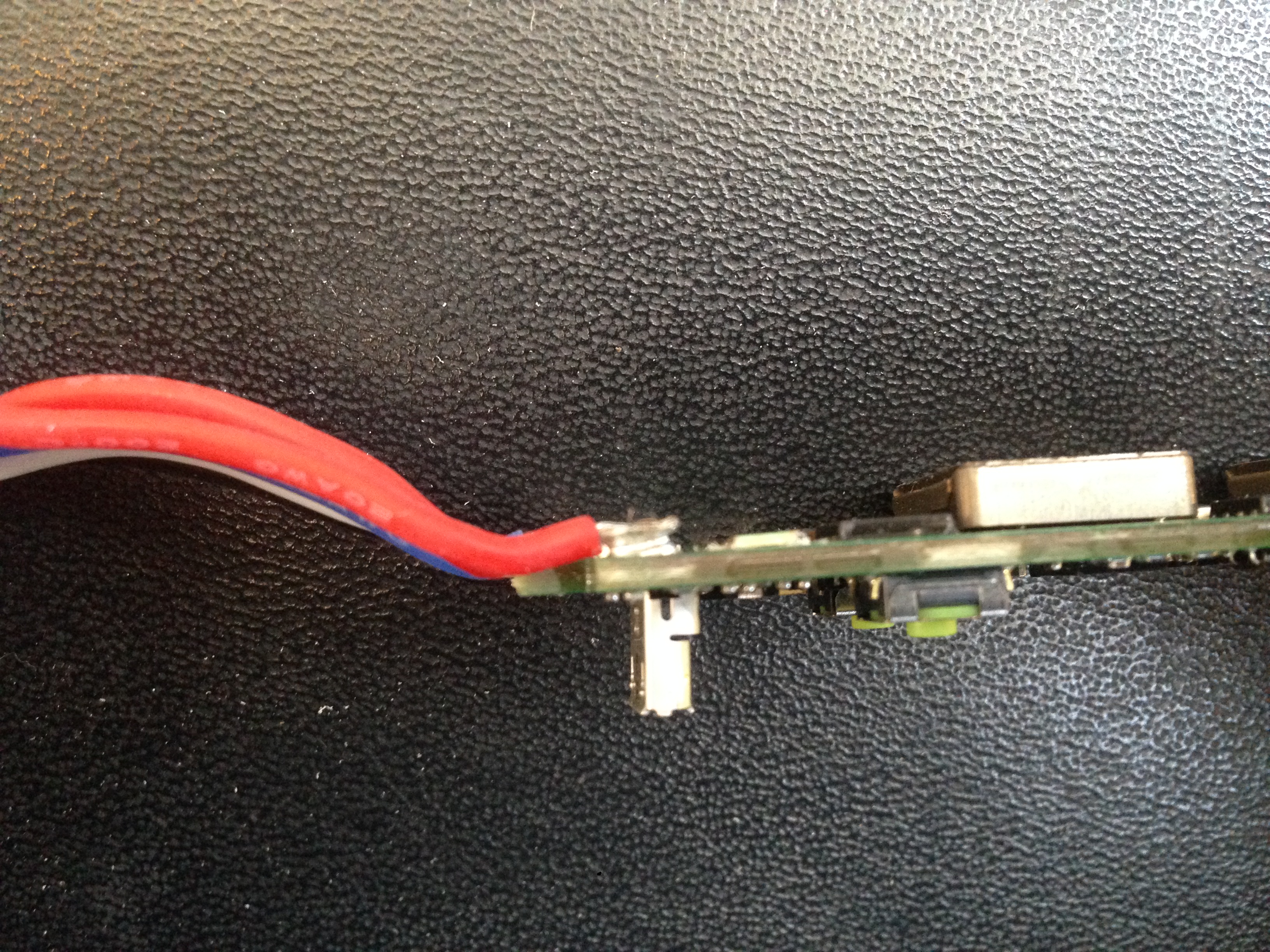

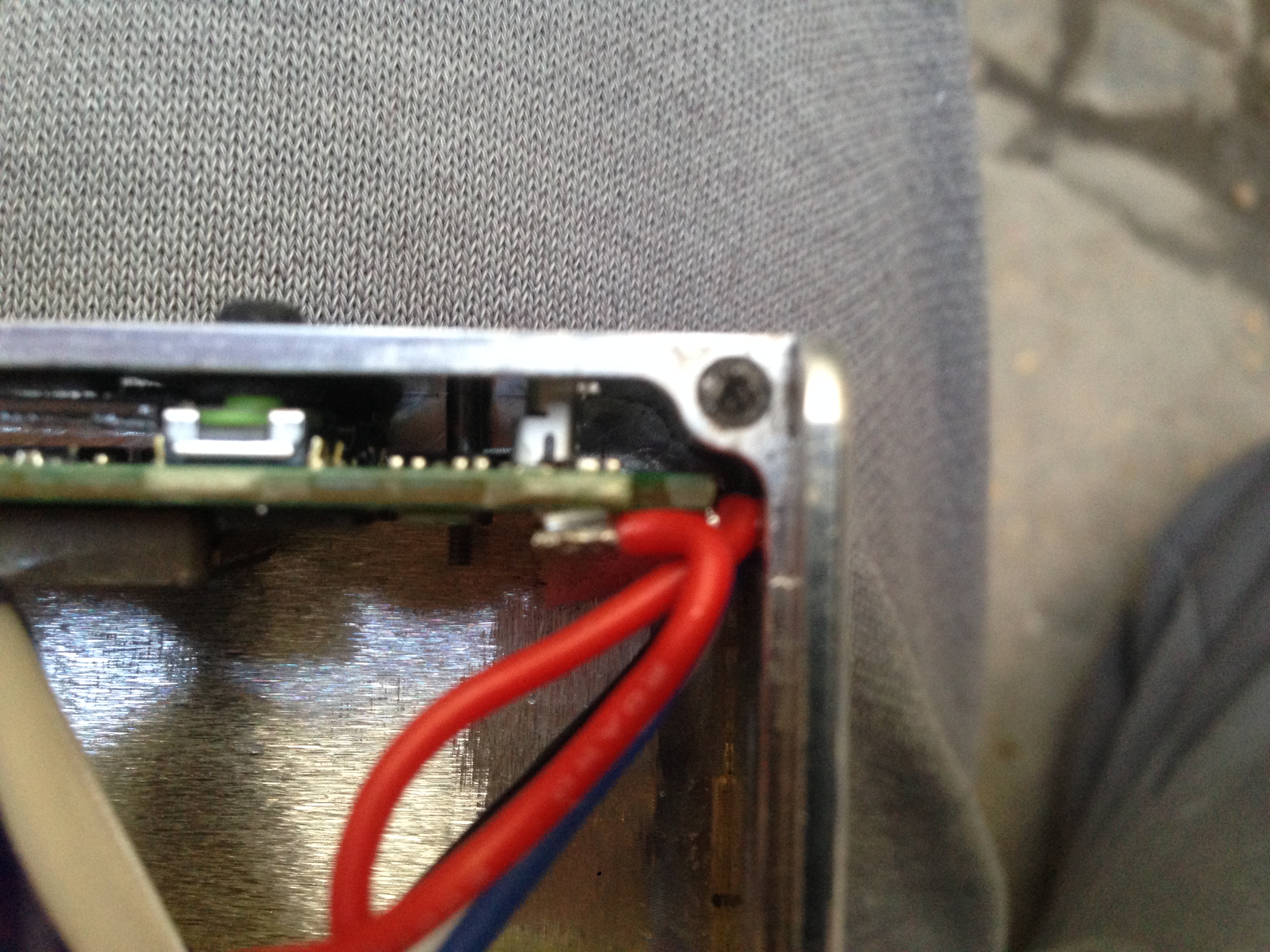

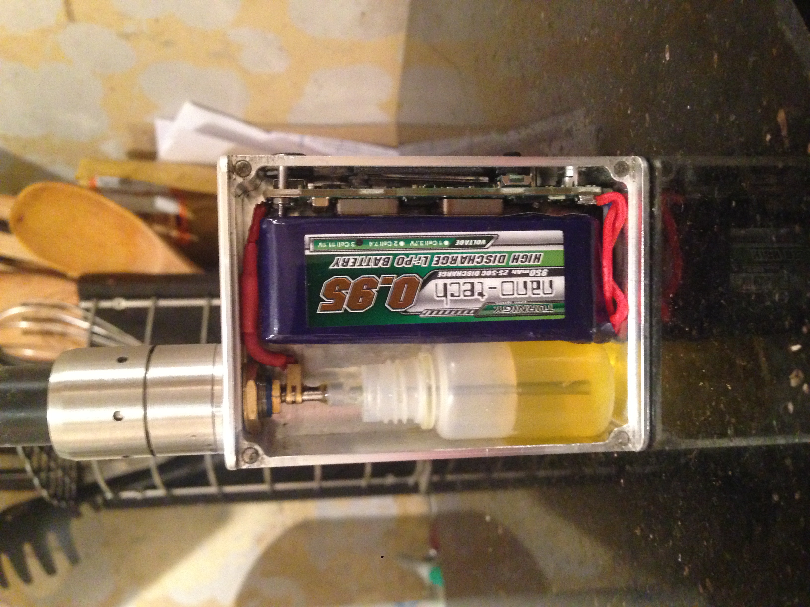

Hi thanks for all the help, as you can see in this pic the positive is sitting above the board no touching Regards David -

Thanks for your help Nick nothing has shorted I no I'm not the greatest of solders just like to no where it's gone wrong before I buy another board m Thanks David -

Hi Nick thanks for your reply so what your saying is this mount shouldn't be earthed to the case ? The screen is held in automotive double sided tape and I pre-tinned the wires and pre-flowing solder onto pads Regards David -

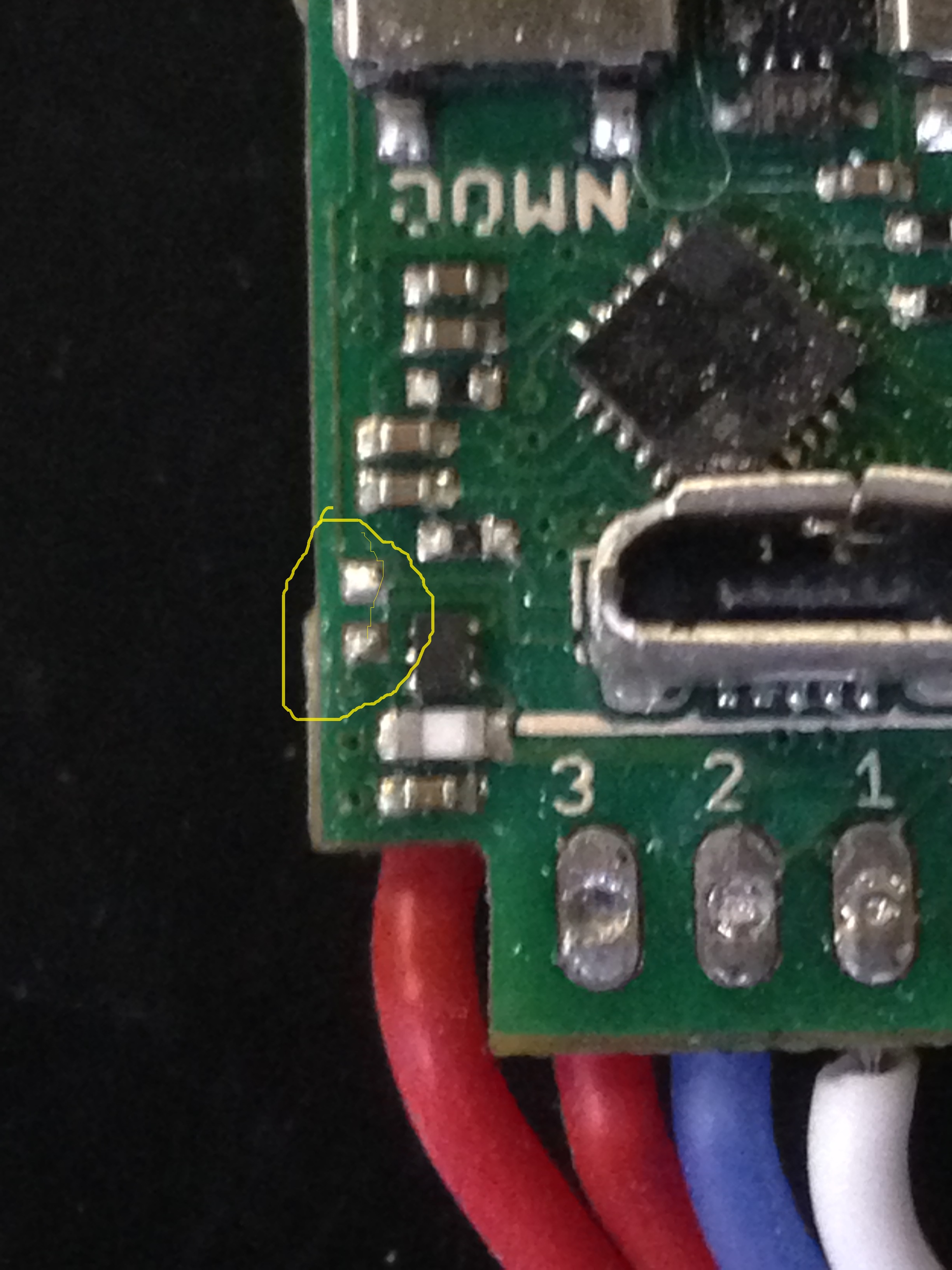

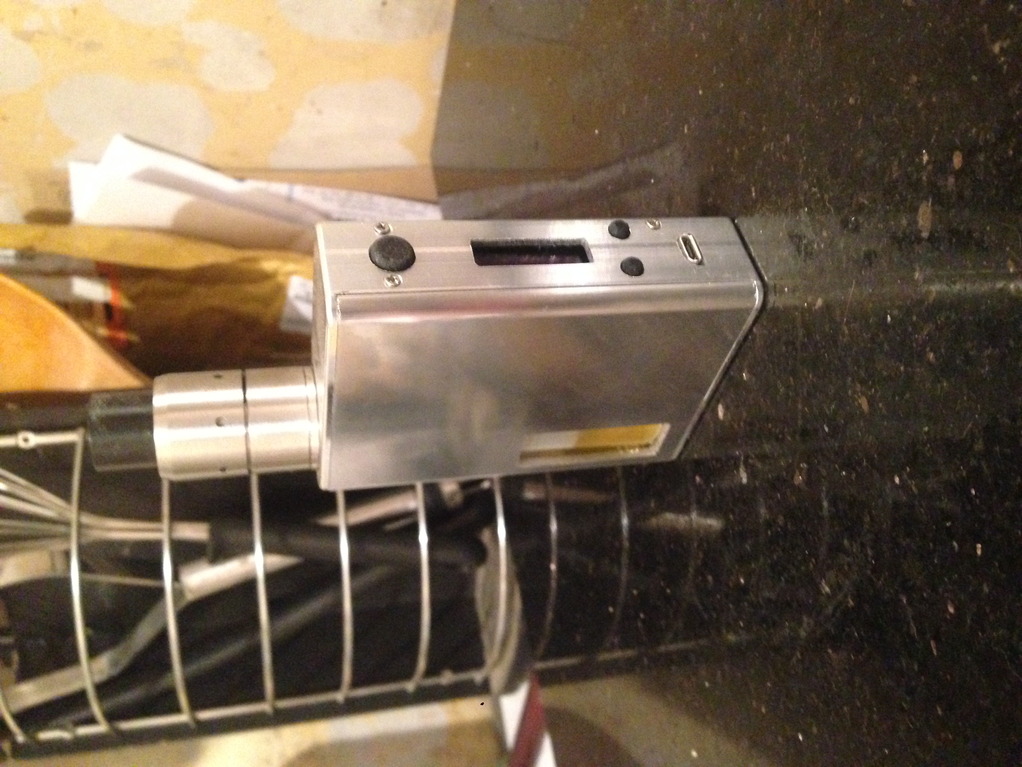

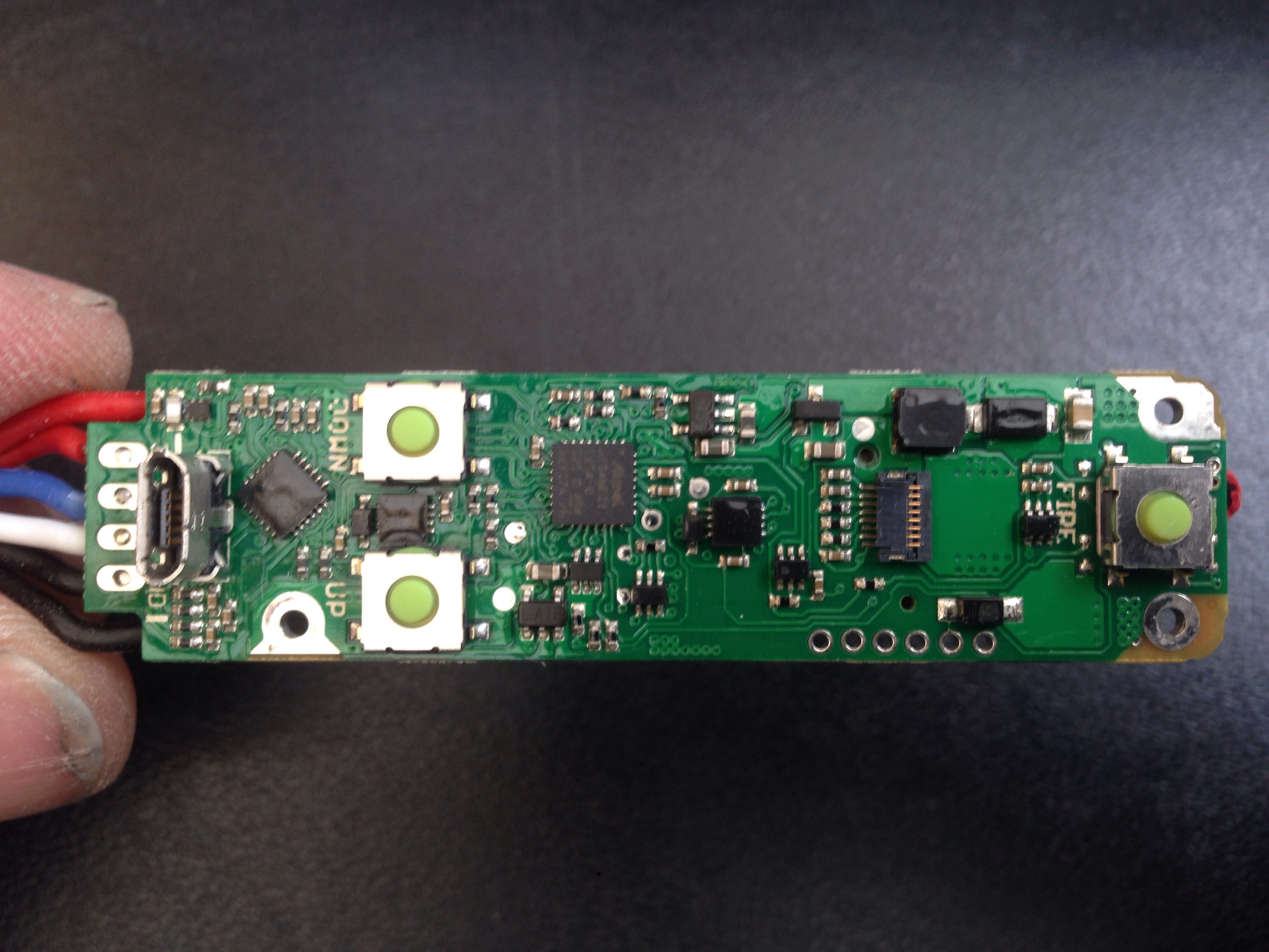

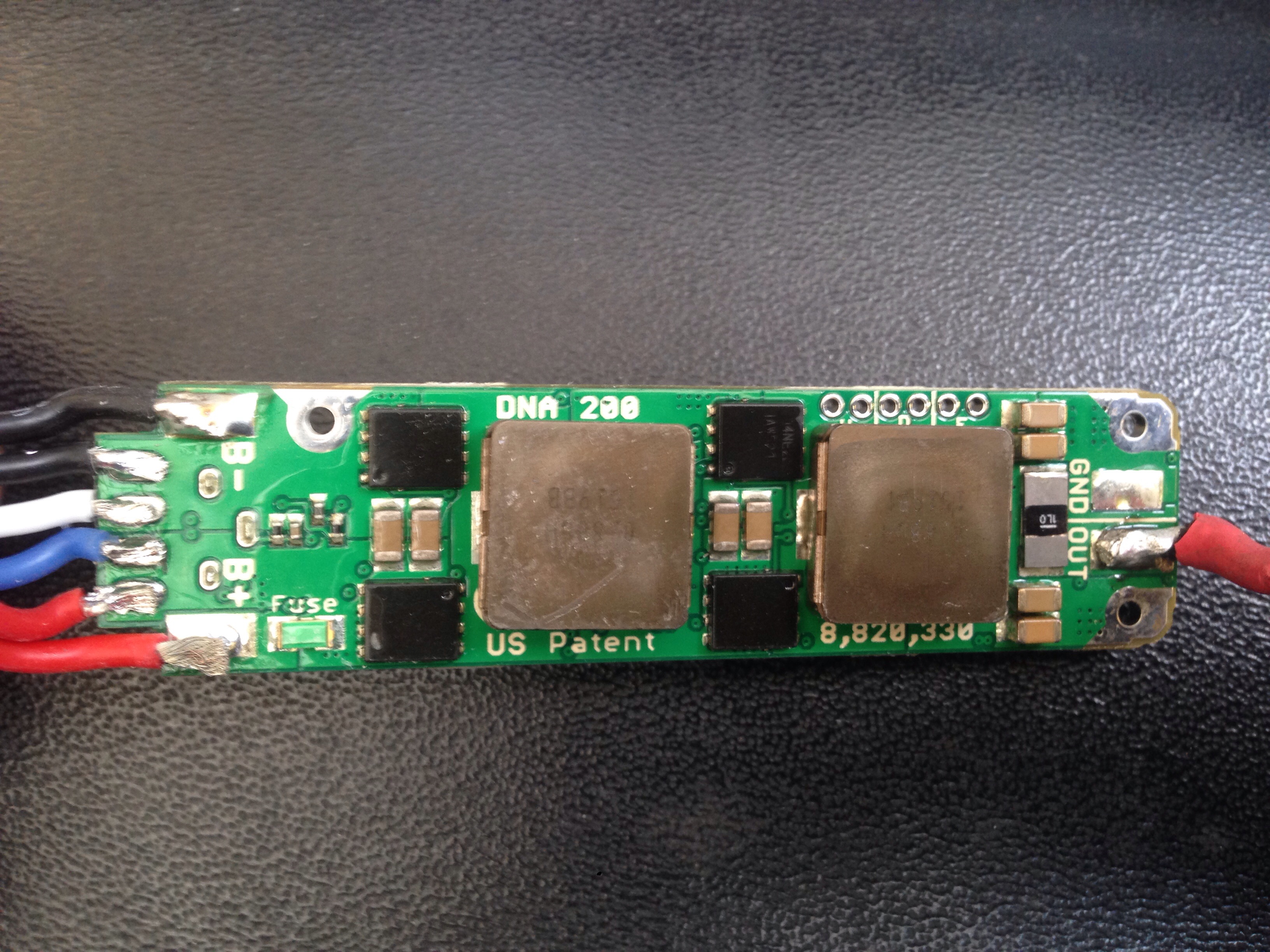

Hi Whats the reason why the board becomes dead ? I have had two now while vaping no errors messages. I put the same atty on my sx mini m class and work fine so it cant be that. This is my mod 36 hours of vaping gutted /topic/65689-topic/?do=findComment&comment=889338 Thanks David -

Hi this is what I have experienced so far, programmed June board blown fuse which I changed then two weeks later completely dead which I can take being a early adopter, July board part missing of the board could of been me or missed in quality control. My third board is programmed in August and comes tested this is the box. 36 hours later dead no blown fuse! After the time and money I have spent building my last mod im so pissed off right now, time to come clean why these boards are dying evolv

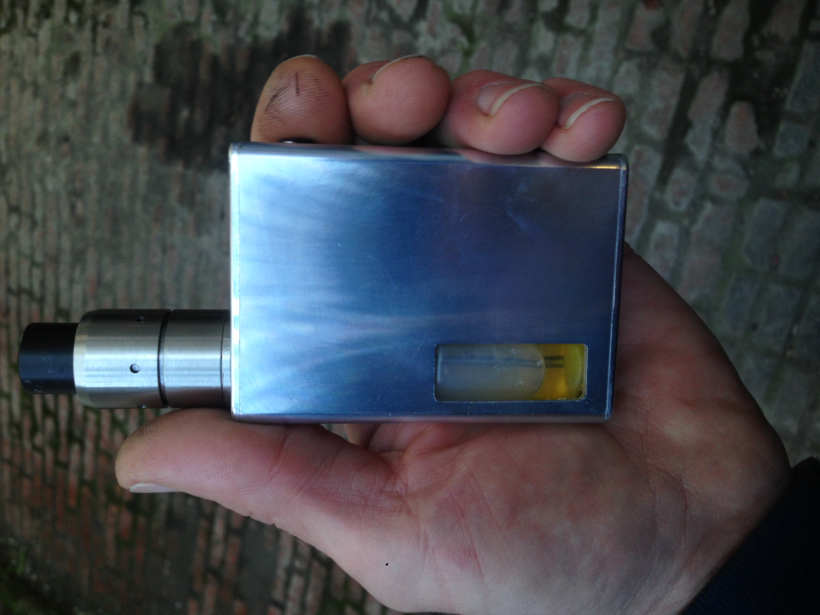

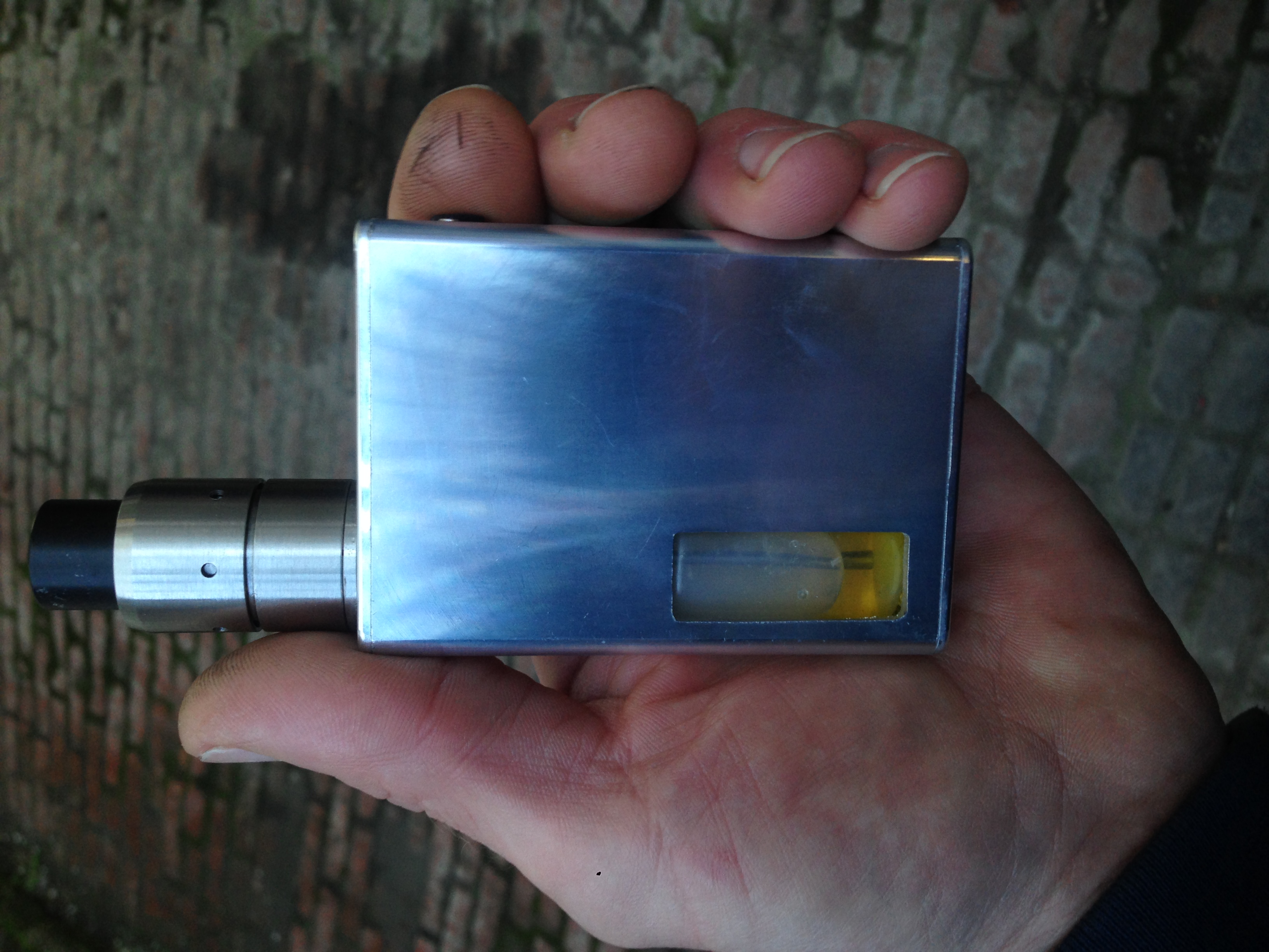

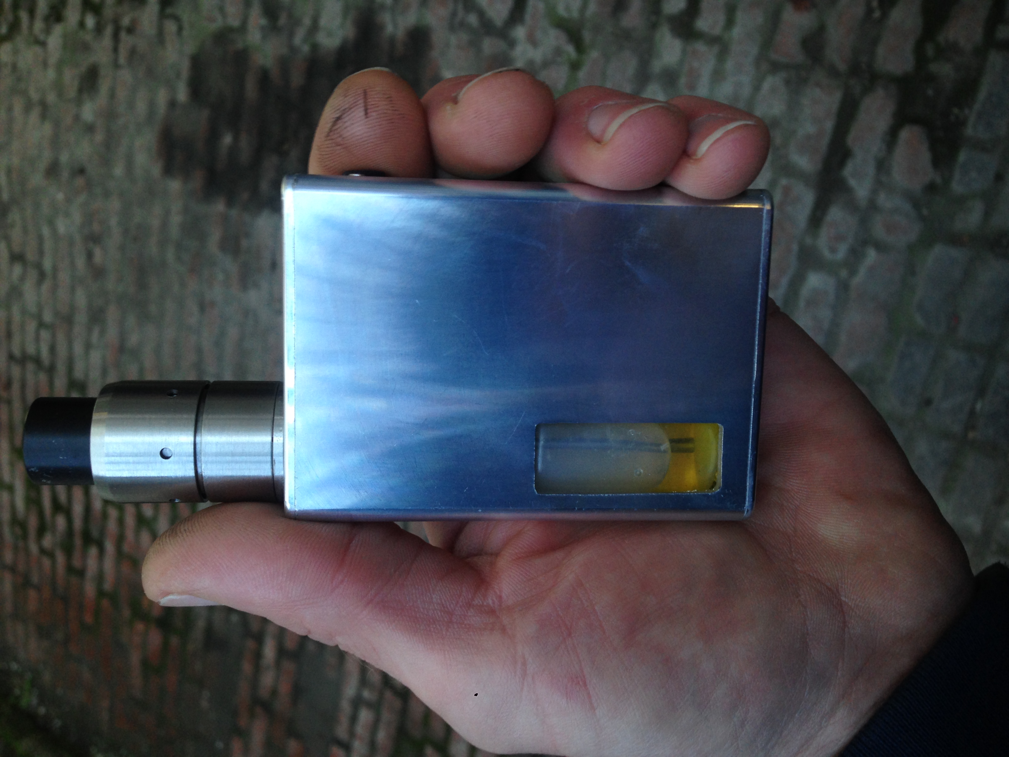

Thanks for that, I just waiting for a chip back from evolv and your design will be used! Always wanted a squonk box , shame about the battery size, but I have a 2200mah 3s in my original dna but it is a bit of a brick! What buttons did you use there? And is that the squonk kit from mod makers as well?[/QUOTE] Hi I will add the parts that I used for you later Regards David
Nice. Very well done. Where did you get the box? It looks to be exactly the perfect size for a "snug" fit of everything.[/QUOTE] HI its this one http://www.modmaker.co.uk/Mod-Making-Supplies/Enclosures/ModMakerBox-Enclosures/ModMakerBox-WideBoy-Natural-Aluminium Regards David
