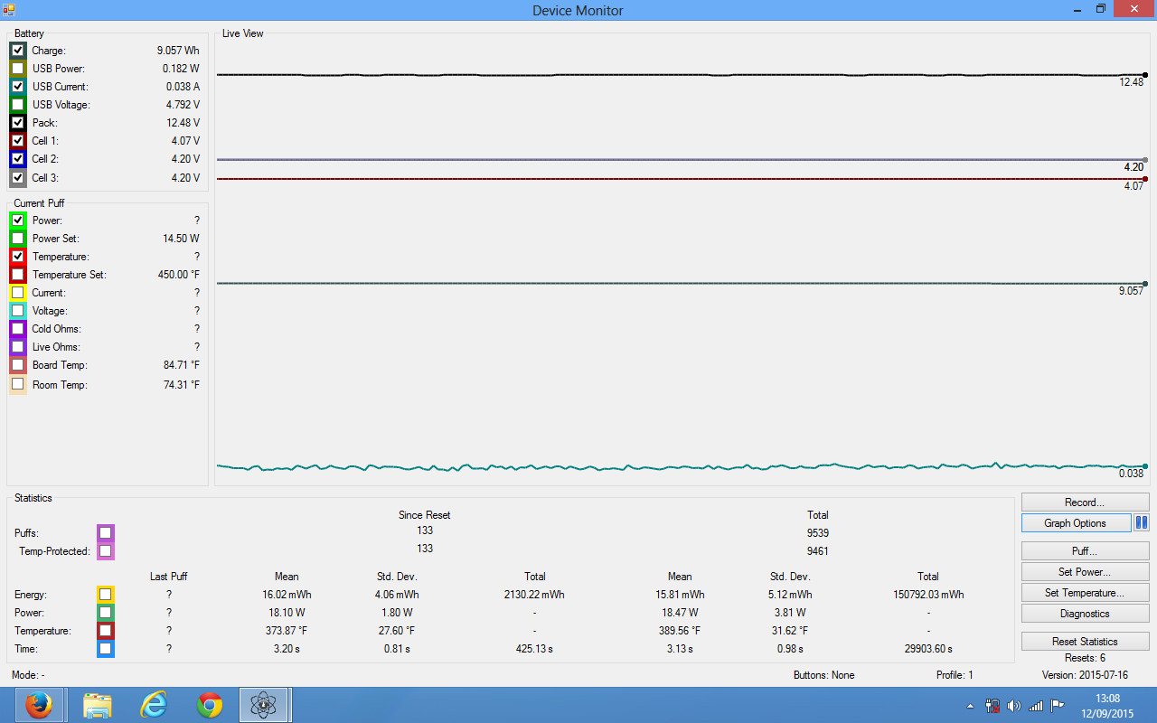

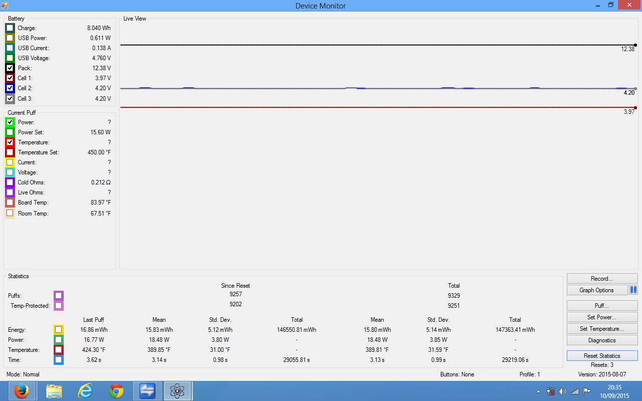

Hi got a unbalanced cell after changing the fuse it was 3.85 yesterday after a charge up to 3.97 any ideas to get it back ? Thanks David
