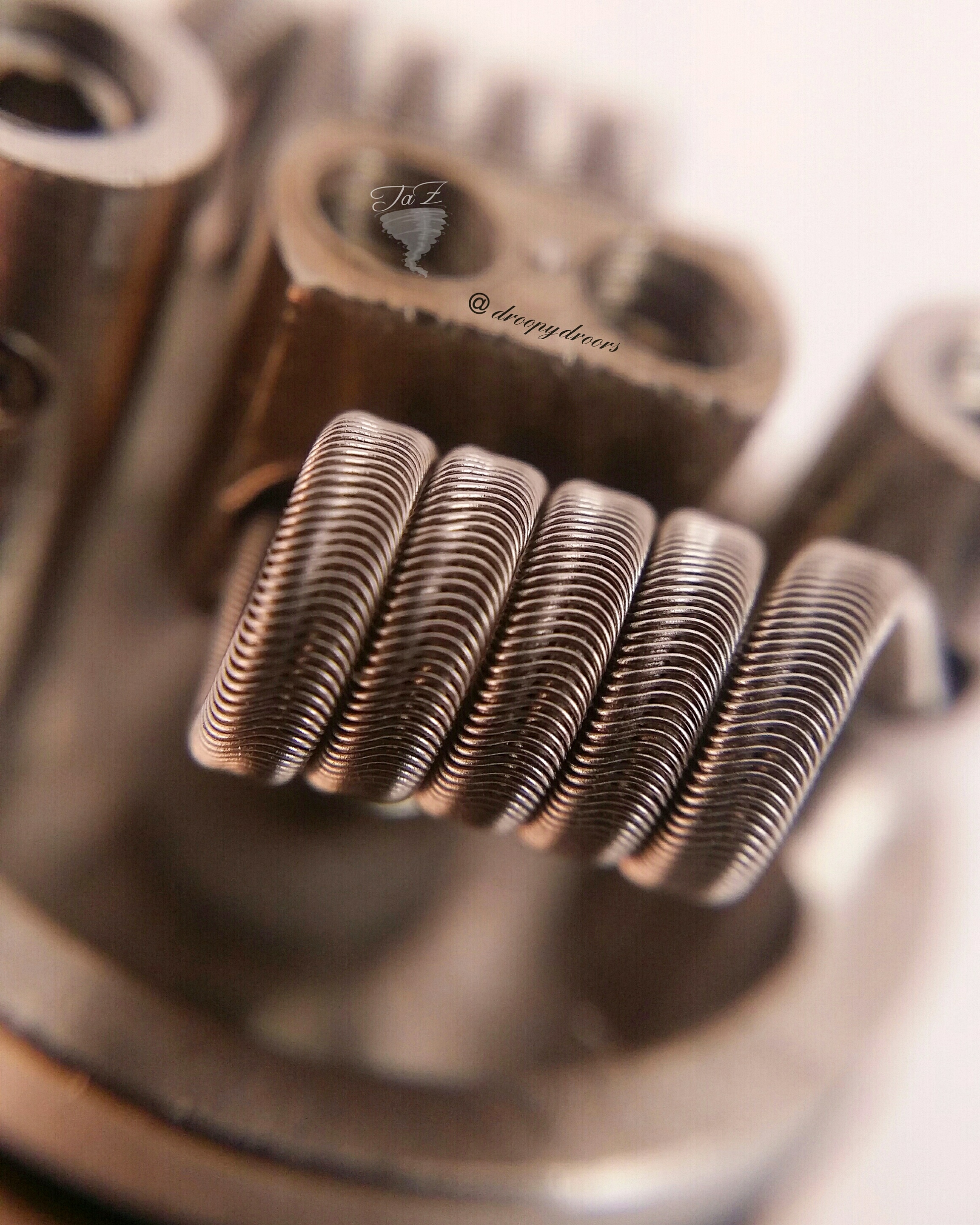

This is the coil I am running in tc at the moment. Mostly all the bugs are worked out. Specs on Dual coil 2x22g SS 316L core / 38g n80 wrap / 3mm id / 4-5 wrap / .053? Escribe settings .053 ohm locked 380 F 90 watts Preheat 150 watts for .8 sec Punch 5 Custom TCR Video to come.

It seems as though the resistance lock fixed the problem. For the most part. Right now my settings are. Resistance reading .05 locked 90 watts 380 temp 150 preheat at .7 seconds 5 on punch The coils are dual 2x22g ss 316L elite core / 38g n80 alien fused wrap / 3mm id / 4-5 wrap / Custom TCR uploaded. It is running very true to temperature and running very steady at the 380 mark. Since ss does hold temp alot more than ni200 and Ti the preheat seems to only kick in when the coil is down at room temp. Which is exactly what I was expecting and wanted. It makes sense that if the coil is still warm, from being in the middle of a little vape session, that the pre heat isn't needed due to holding the temperature. As you can imagine these coils are quite large so the preheat is such a nice feature to have. But only if it is set correctly and works as it should. So I'm very pleased with this aspect of the chip. And is why I'm trying this little experiment. Prior to this point no device could do this in temp control and I believe that's why there is an option for 200 watts available in temp mode for this device. -
