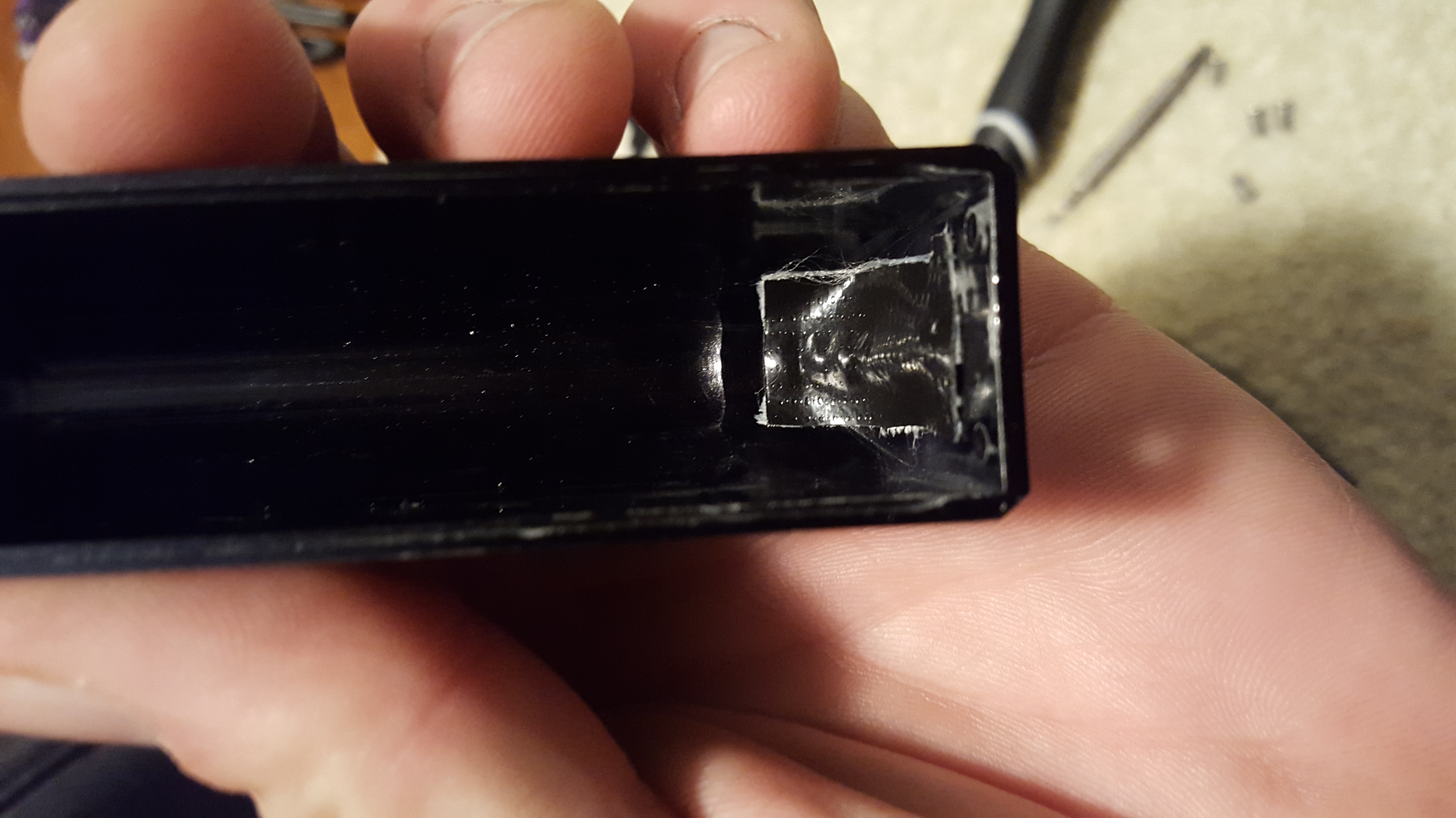

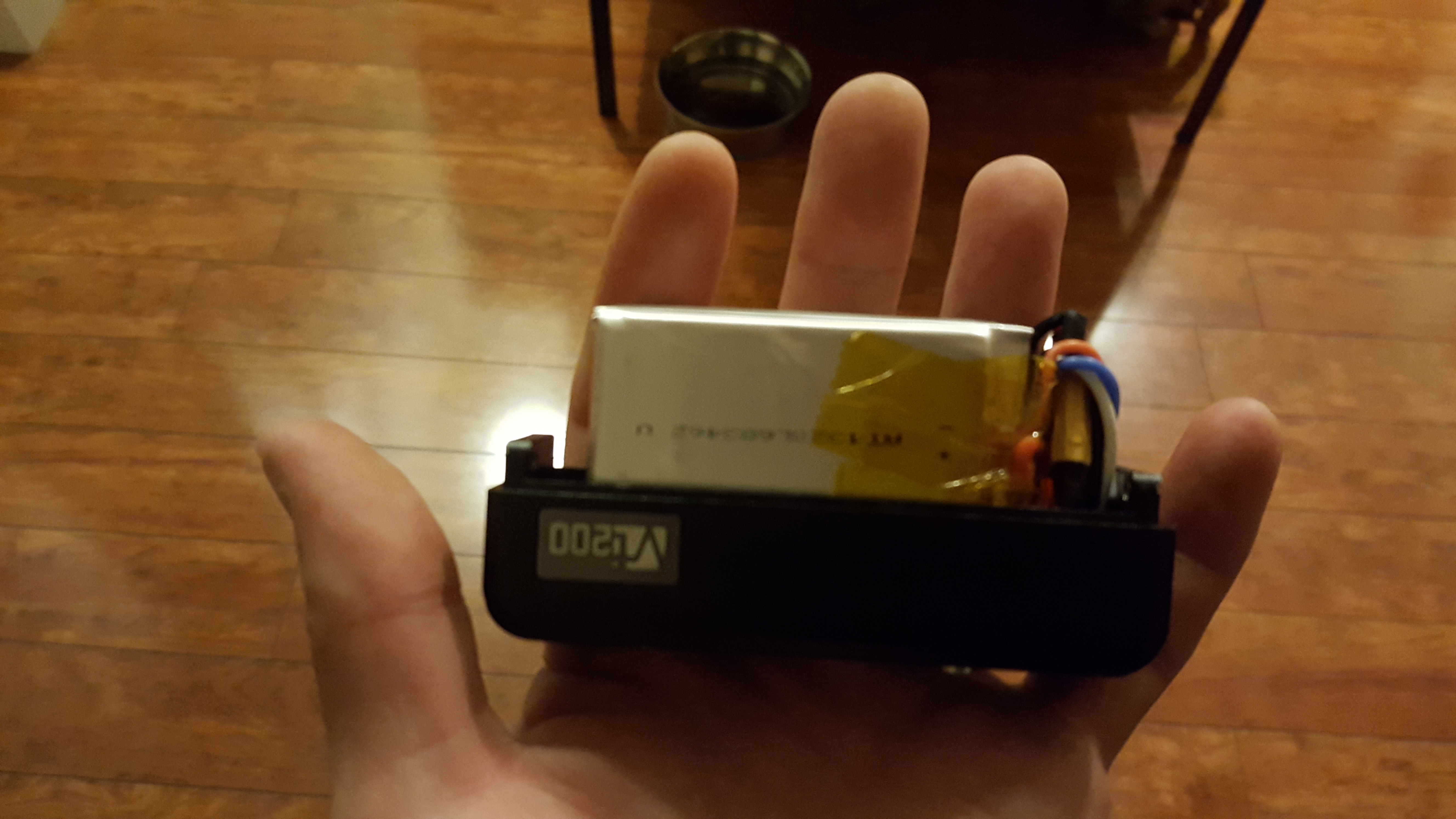

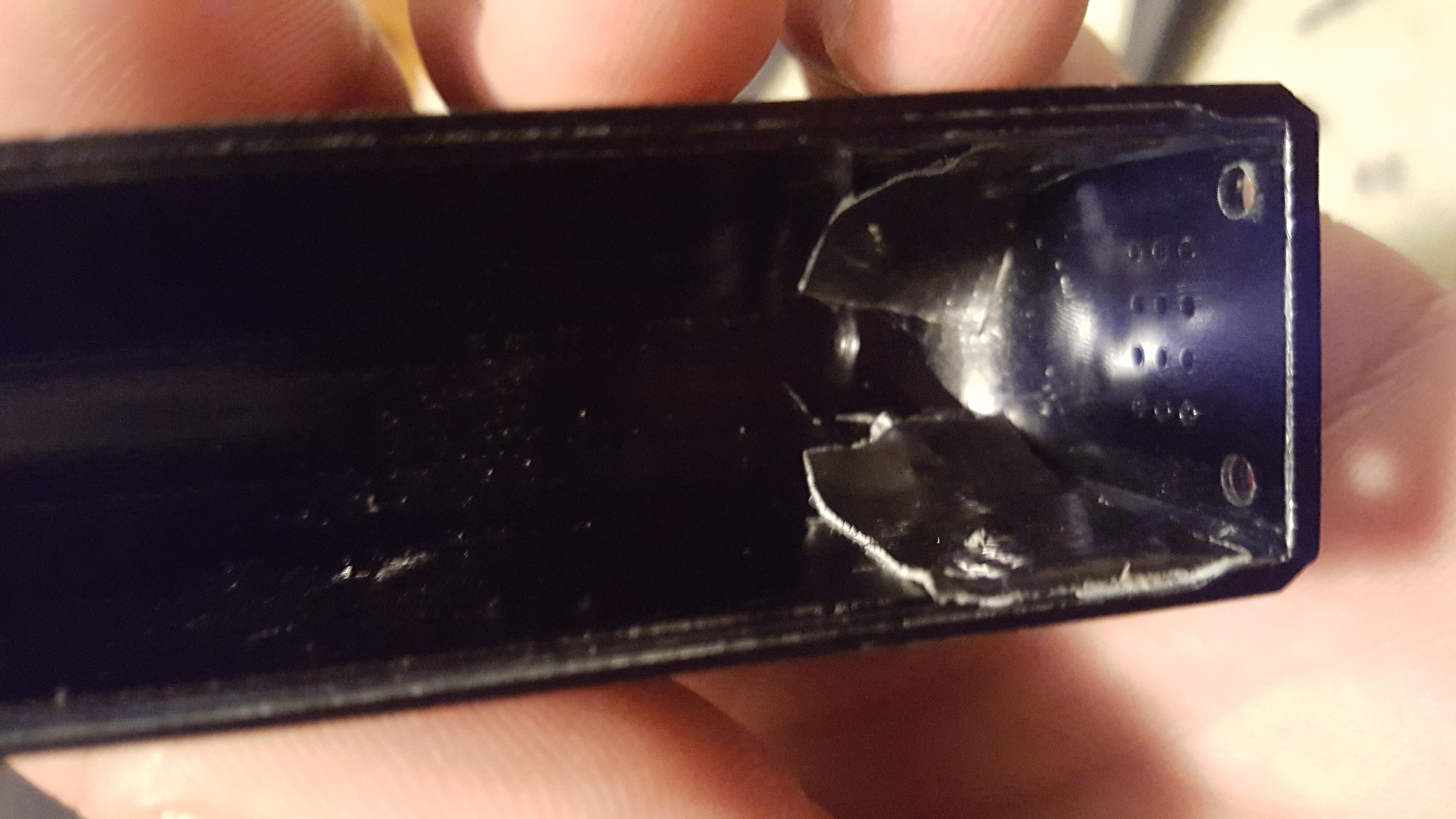

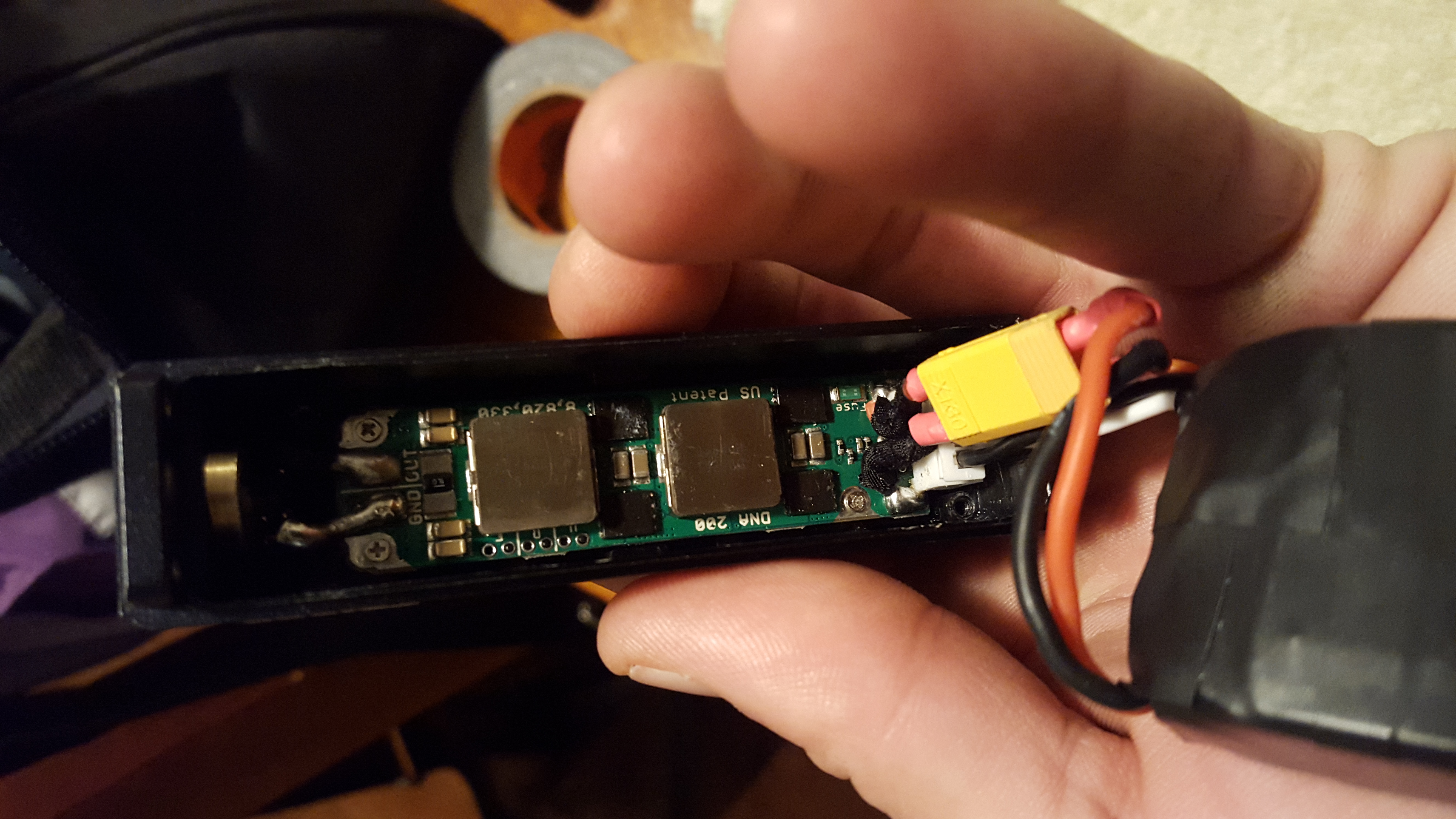

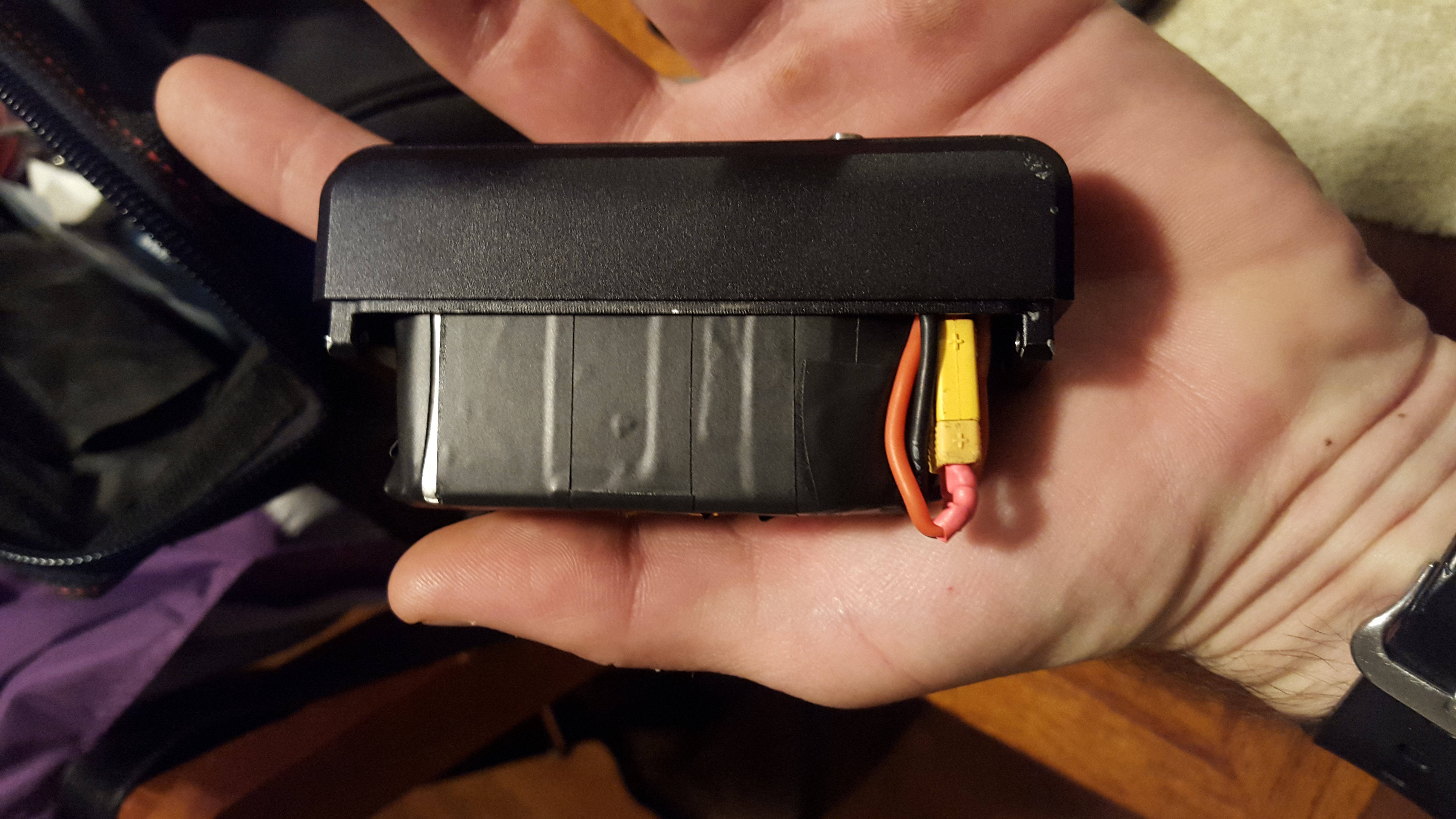

i just installed the thunder power 1350 in my vt200. had to remove the plate separating the chip and battery compartment . had to shorten the leads from the chip and change the plug on the battery. i removed the tabs on the battery side of the case also. i removed the lipo wrapper and rewrapped it with electrical tape. fits good and i got 14.23 for the first analyser test

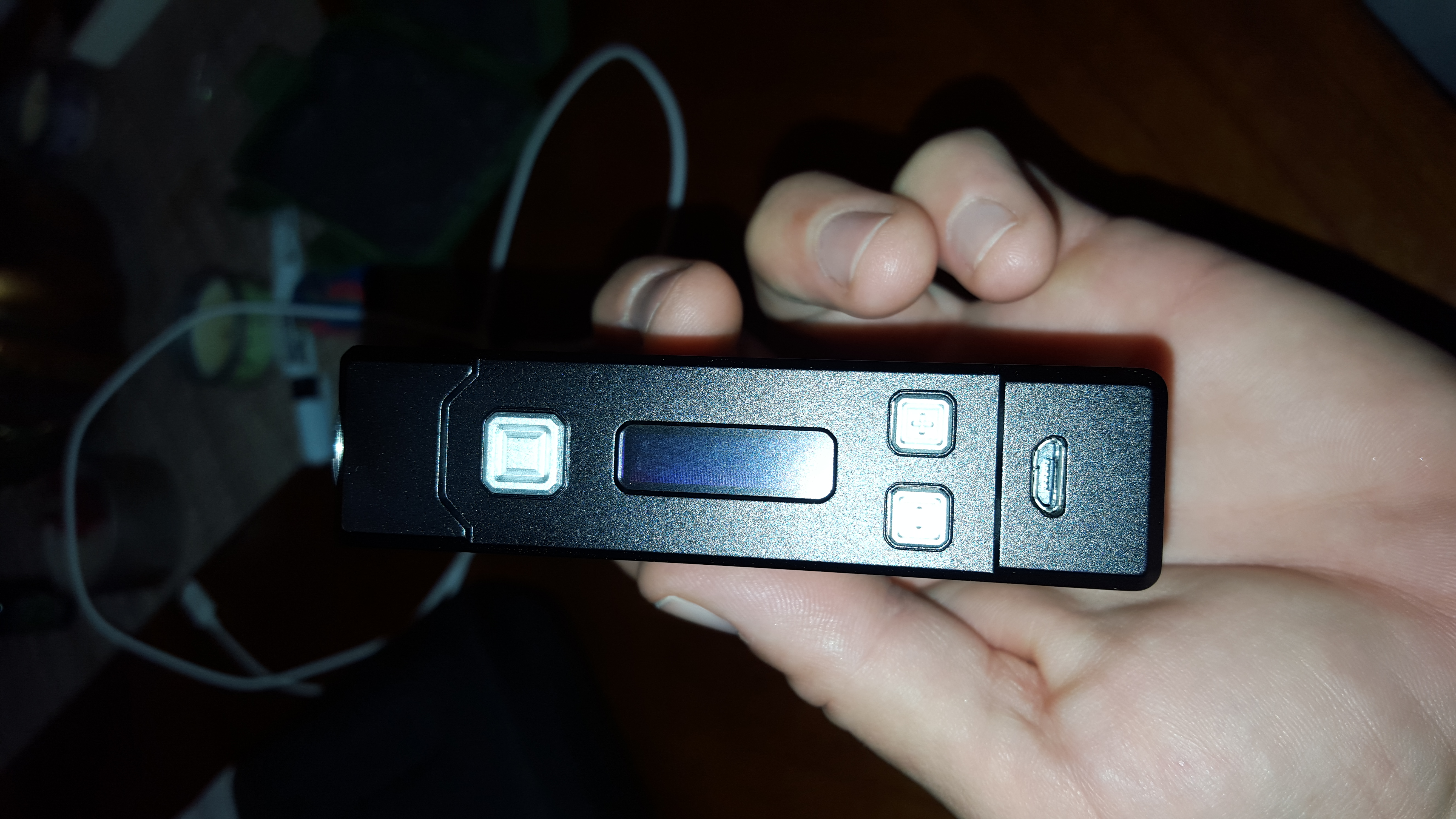

yeah buttons too. havent tried turdigy. glacier is away better battery in my opinion and available in usa for 15 bucks. i think size is 71x35x20
dont get me wrong if the same size 3d print wasn't 80 plus dollars i would have got one. but since i found these boxes for 55 bucks 68 shipped with tracking i had to go this route . the guy is great to deal with . i bought the black box prebuilt for 170 minus battery. took about 1.5 weeks from philippines . i put a 45 c 1300 glacier lipo in it for 15 dollars. i ordered another box this week for 55 it comes with the case and all the screws to mount chip and hold both halves together. its identical to the evolve case i believe except that its bigger on the battery side to fit the bigger battery. and the notches for the grip. i wanted an evolv box and this was the next best thing. hoping to grab one like u got soon. i have the vt200 i use as a work beater . but the reference box is one of my favorite designs. i love the one you have. i liked them raw but that black is sick
