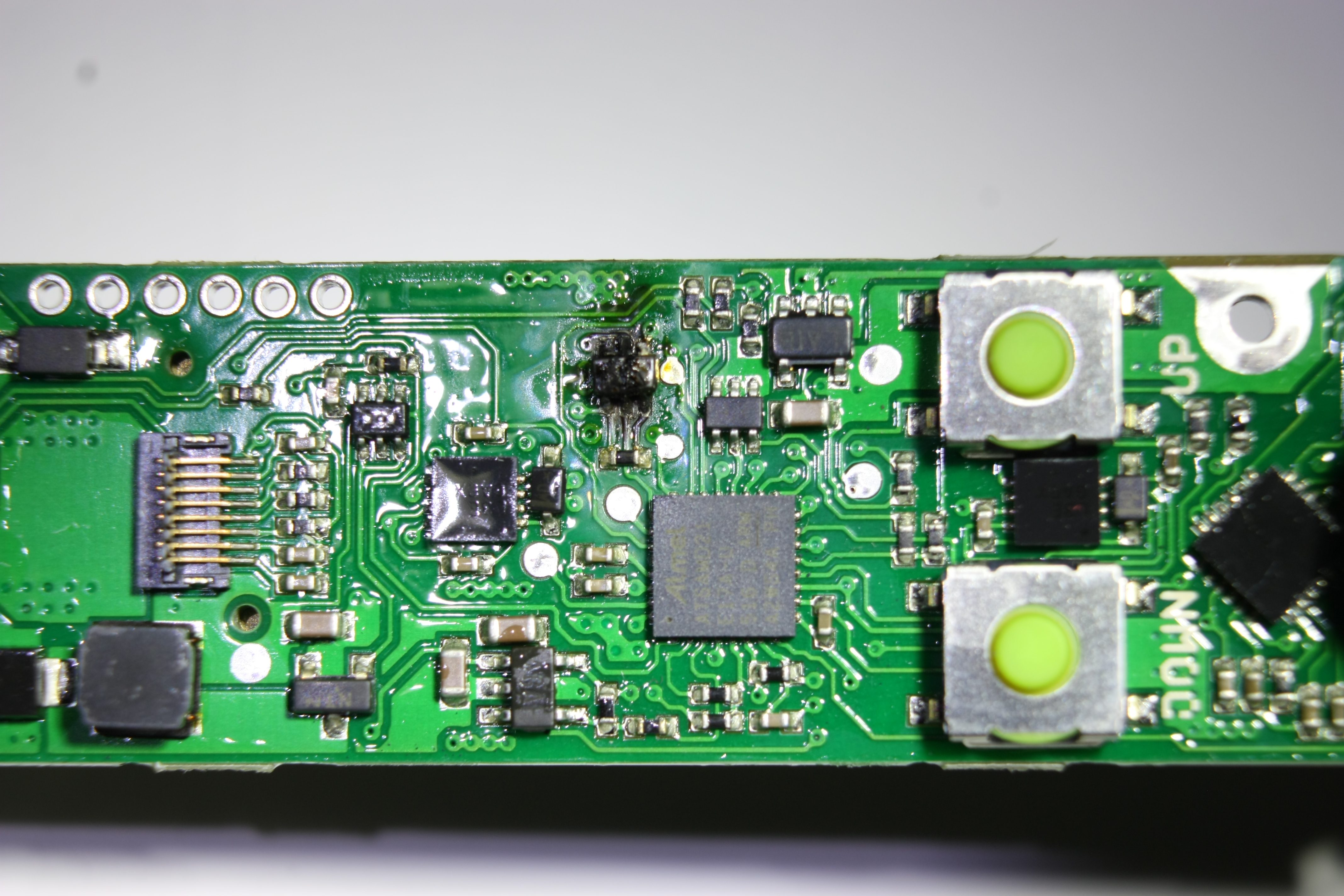

My mod quit again this morning. Good thing I bought a second board so I can just swap them out and return the failed one without going without my favorite mod. What I want is some feedback from Evolv on possible causes. I see some minute difference between the new board I bought a few weeks ago and the replacement that was sent around the same time. This leads me to believe that it might be an issue with the boards themselves. I just want to make sure I am not doing something wrong. I've built a couple of mods before and this is the first that has had these issues. Maybe I'm asking too much to chain vape at 90W. Here are the four tickets so hopefully someone can look them over and see if there is a common problem and if there is something I need to do different. 394-ZHL-Y6TR (Ticket number: 2042) W5P-L5W-J7A6 (Ticket number: 2700) M9L-H3J-TZ8E (Ticket number: 3104) PQS-XGR-68VR (Ticket number: 3431)
Well, replacement board #2 just died. I went for a quick vape at lunch and it worked fine for a couple of hits and then nothing but the unmistakable smell of the magic smoke leaving a component on the board. I took the battery out just to be safe but before I did there was nothing on the screen and no response to any button press. I sure hope this trend doesn't continue. The first board just quit, vape... Vape... Nothing. The first replacement let out a pop when it died. I hope the next one doesn't go up in a ball of flames. I'll have to inspect the board when I get home and see if anything sticks out as a cause.
