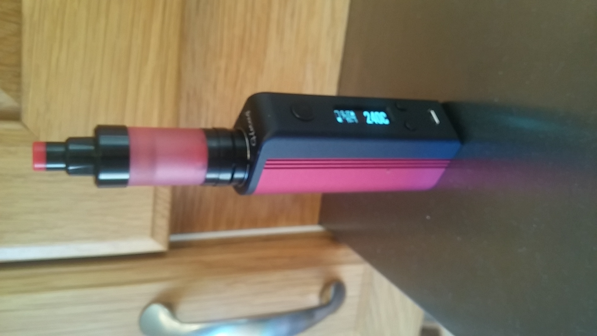

  11. Doing some matchie-matchie!
  12. That's what I've been looking for! Do you wan't to share the design files?
