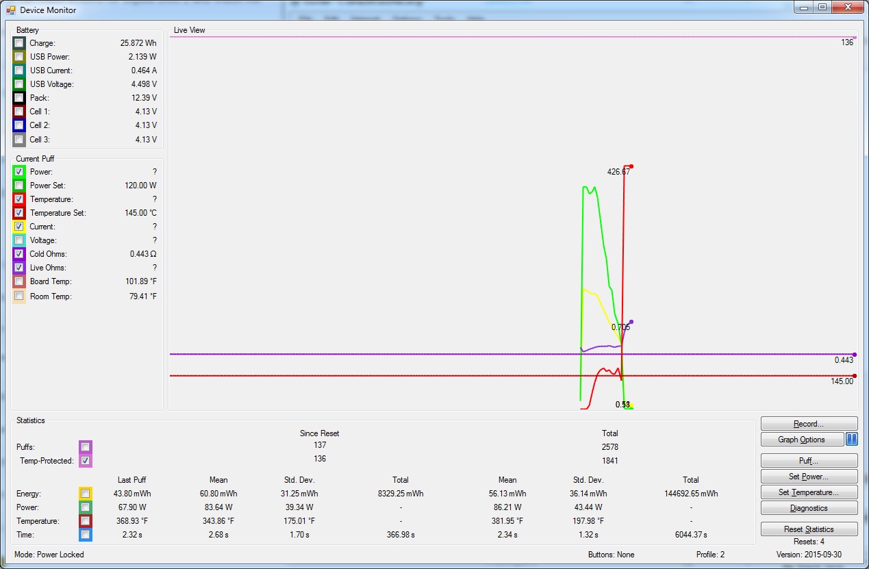

	  [SOLVED] stainless steel resistance instabilityDjMadness replied to DjMadness's topic in DNA 200 and 250 update, i got it working. it was actually the positive pin causing issues, sometimes it screws it's self a little bit lose. happened to me a couple of times, probably due to it being a clone (velocity rda, original is not easy to get atm) I've been using TC without issues for some time now, this device really shines compared to other devices, i can't imagine what evolv's next chip would be capable of, but as long as it has the capabilitiies as the dna200 they have me as a customer (specificly the triple 18650 part and temp curves )

	  [SOLVED] stainless steel resistance instabilityDjMadness replied to DjMadness's topic in DNA 200 and 250 I increased the tempreture to 200C and reduced the resistance manually to 0.42Ohm's and it seams more stable now. Stainless steel seams rather unstable for it to need manual adjustment after coil change. for this i mean ie if i am forced to change coil while at work i would be forced to configure via escribe before its stable. (i did dryburn and leave the ecig for approx 30 mins before locking the ohm's but adjustment was still needed)

	  [SOLVED] stainless steel resistance instabilityDjMadness replied to DjMadness's topic in DNA 200 and 250 connections are down tight, if i tighten anymore it would probably break the wire. The analizer states that its flucturating with 0.001 (quite normal considering its putting power through the coil) The resistance only goes unstable in temp mode, not when tc is disabled.

	  [SOLVED] stainless steel resistance instabilityDjMadness replied to DjMadness's topic in DNA 200 and 250 I seam to be having troubles getting temp control to work as stable as possible. When running in temp mode (i am using csv from steam-engine for stainless steel 316), the resistance jumps up to over 1 ohm when my resistance is at 0.44 cold. after it reached over 1 ohm in temp mode i quickly activated watt mode and it states 0.5 ohm's live, going back to temp mode its over 1 ohm again. Something's wrong and it does not sound coil related, more software related, could someone help me with this ? edit i have a wismec dna200
