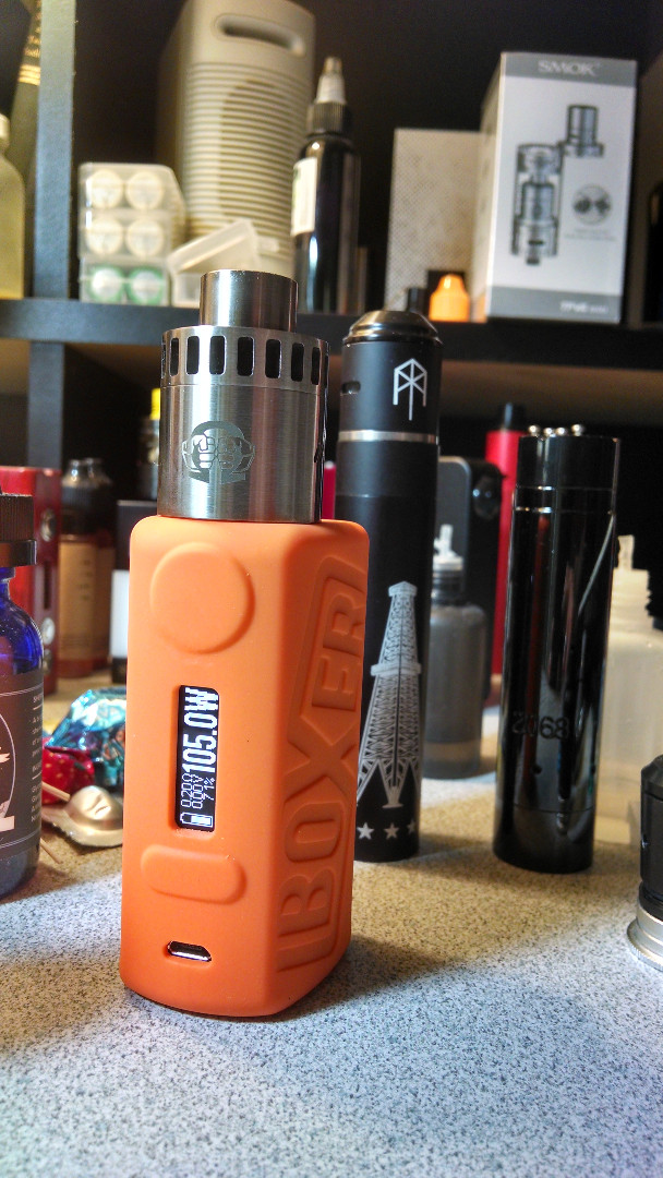

Well as of this typing I'm at 88% charge left and it's performing better than it has since I brought it home a few nights ago. I noticed the contacts were not out enough as to apply good pressure to the cells so I corrected that on all four and checked all the soldering points and wires and wire bends where they are tight and so on. So far it stays where I set it watts wise while firing at the 88% charge point. We'll see what happens but I can already tell it's doing better than it did. Thanks guys. Maybe this is all it needed. I'll find out as the batts drain further.
I got this a few days ago in a trade. Supposed to be almost brand new. New batts fresh out of box are Samsung 25r's. Never used them before but are comparable to LG HE4's. Boxer would not have warranty left I doubt but I can check.
What I'm using they call Hive wire with Kanthal. With the new batts I turned it down to 105W with .2ohm dual coils but unless the batts are fully charged..... Anyway, I get the point. No more reason to talk about it. I understand the board in the DNA250 is made to protect itself and batteries which protects the user so....

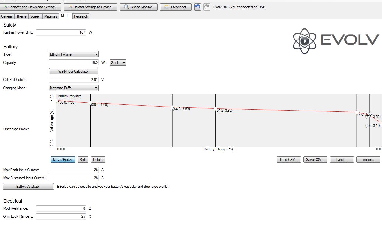

You would have to read my first post in this thread. The reason I started it was to try and find an answer to my question about whether or not I can adjust a setting in Escribe to control how the step down function works.
Well I guess I at least have my original question answered. I gather there is no setting for the end user to curve or turn off the step down on the DNA's.
