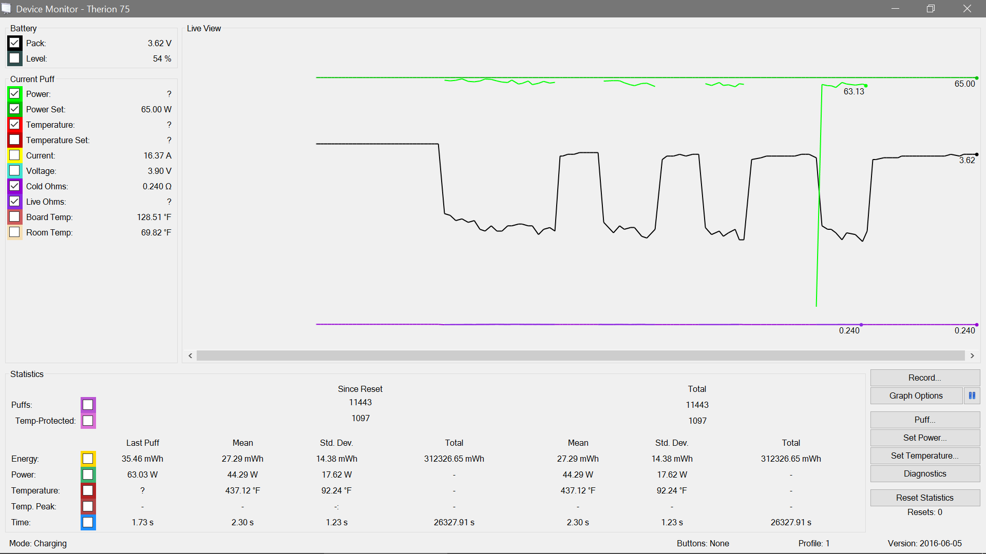

I'll put an order through for some new batteries. What would you recommend? The therion 75 is powered by dual batteries running in parallel. Glad you enjoyed the screen shot ?

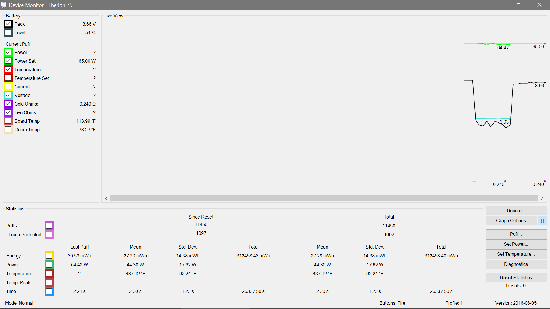

The battery bar seems to flash when the wattage is at a certain point. If I'm using the crown with the .25 coil, the mod reads between .25 and .33 I've read that people have issues with the crown tank on the therion. The ohms will jump around. When I put the herakles plus tank on there with the .40 ohm coil it reads .41, the battery bar will blink if I run it anywhere above 65 watts.. Is the issue that two 18650 batteries have trouble pushing a certain amount of wattage for certain coils?

The voltage for a .24 build at 65 watts is 3.93-3.94

I'm not sure if this question has been answered or if this is even the right place to post this question. I got a therion 75 the other day and it was used. The battery bar will blink when I'm using it. Ive got a herkales plus on it with a 0.4ohm coil and I'm vaping it at 65 watts. Also, the battery is at 68%.... Anyone have any idea to why this is happening. Is there something on escribe that I'm not setting up correctly?? Help would be greatly appreciated. Thanks in advance!
