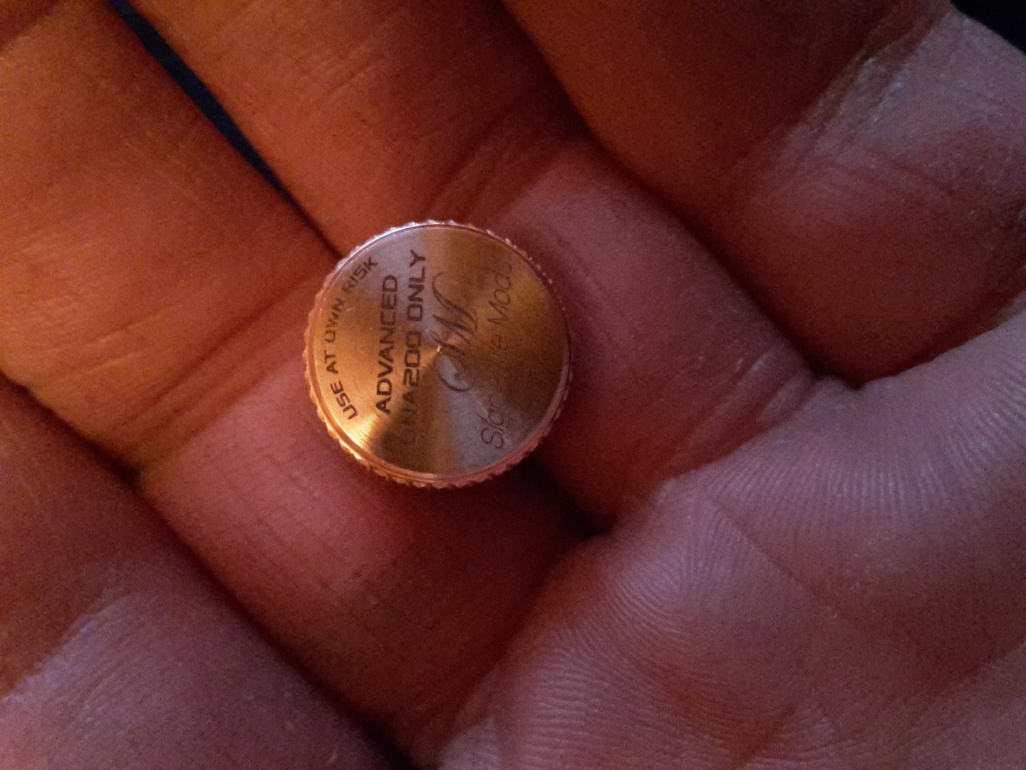

update. All have been to zero, cleaned the 510s again and taken the surface off the copper tool. Its clean. All have been checked prior to reboot, the soft reboot performed and re-run the analyser and the results are wismec Rolo, OE 0.003 before update 0.004 before reboot 0.007 now 0.007 DNA200 before update 0.007 before reboot 0.012 after reboot 0.010 but not holding steady reading its flashing ?-0.010-?-0.011-?-0.012 and only reads ? when fully screwed in. SMY-DNA200 before update 0.004 after update....0.009 after reboot.....won't give a reading now with the copper tool in any position -

I'm having a moment of regret, admittedly the temperature protection has improved. I can now use SS with the confidence I previously only had with titanium. (I just can't get on with ni200). However there seems to be a cost in power mode, I never thought I would say it but at 45w my evic mini now gives better delivery than my DNA200s. I've had to up the power to 65w to reduce rampup, something that I have never had to do. Which brings me to some questions. Why has the internal resistance changed on my mods? Is this part of the firmware smoothing that has improved the response of temperature protection? I have 3 mods 0.003, 0.004 and 0.007. Checked regularly enough but are now 0.007, 0.009 and 0.011-12 Atomiser analyser won't actually register a constant with the copper tool screwed in and only then give a reading as the tool is unscrewed. surely my mods can't have zero resistance now? Is the board now compensating? How do I remove the old material profiles? The old preloaded steam engine profiles of ti, ss and ni200 can't be removed from the system. I've noticed that the ss316 profile is slightly higher than the previous steam engine profile by about 0.02. Reading into this (could be wrong) but this is now a generic SS profile? -
