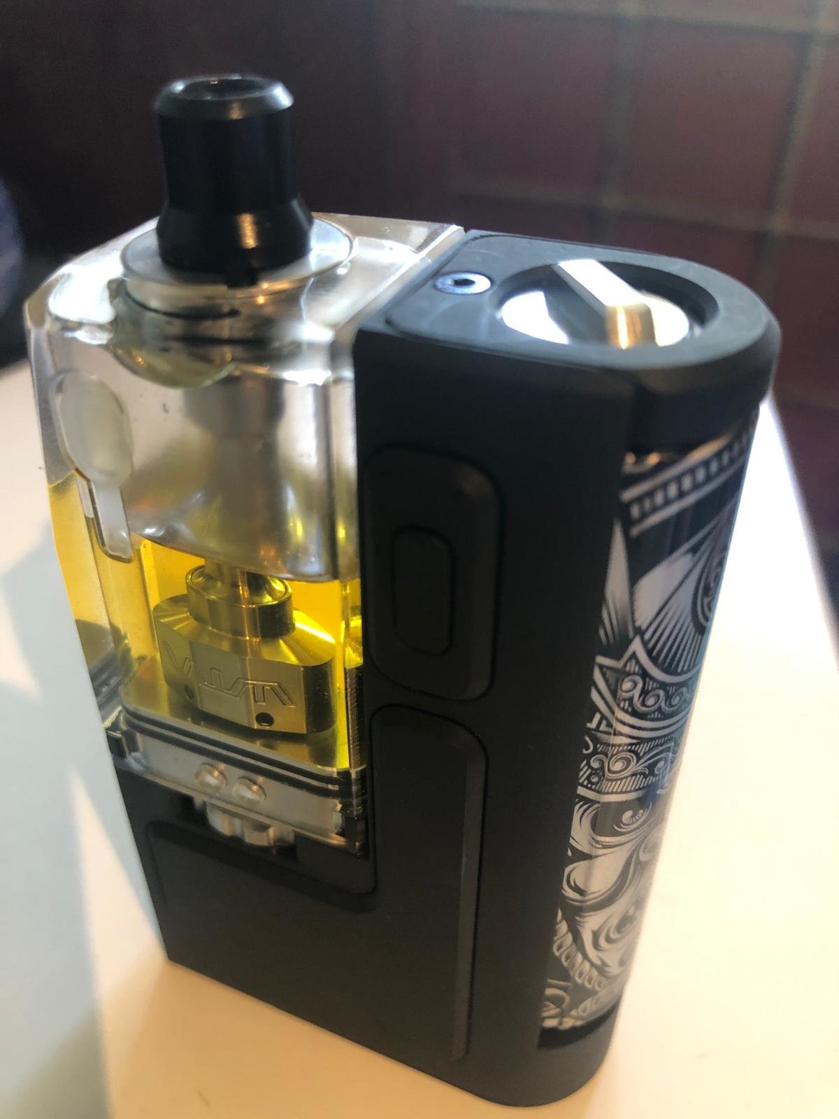

  1. Hussar replaced/repaired the USB C port. It their own design not one like the charging board/USB C that Evolv can supply. I am now able to connect to Escribe using an Apple USB C - USB C cable as supplied with my new iPhone but using a small adapter to allow connection to my PC USB A port, so I have been able to make my usual adjustments to wire types and profiles etc……Hooray! Strangely my USB A to USB C cable from Anker didn’t work.
  2. Hussar are a good bunch, they will figure it out. Annoyingly I bought a decent quality cable from Anker and it didn't work, I did try and flip it. Yes its the Boro type device with the New Cimi connection system
  3. Hi Wayneo The mod is the Hussar C1 - just released. Its a cable issue as far as we can tell. The use their own USB C port and some cables work and some don't they are looking in to it to find out which cable to use. Not ideal but I have been in contact with them and they didn't realise that this was an issue.
  4. I have a new mod that I can't seem to connect properly to my PC or Escribe (its not being seen by the PC). I thought it might be a cable issue as the USB C port is quite tight but I have tried filing down the plastic on one of my cables to allow the plug to go in fully but it still won't connect. The mod does power on when connected but its not connecting fully, the PC doesn't see it. I have tried a different quality cable as well but it still won't connect. I have the latest version of Escribe 2.0 SP57 installed. Other mods connect just fine. Thoughts on this please.
