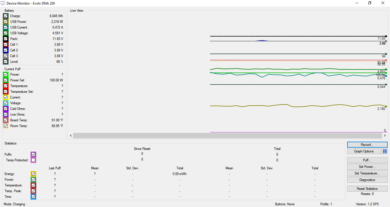

  9. the usb current on this mod is capped at 1a i think but not sure? it is charging sloww.

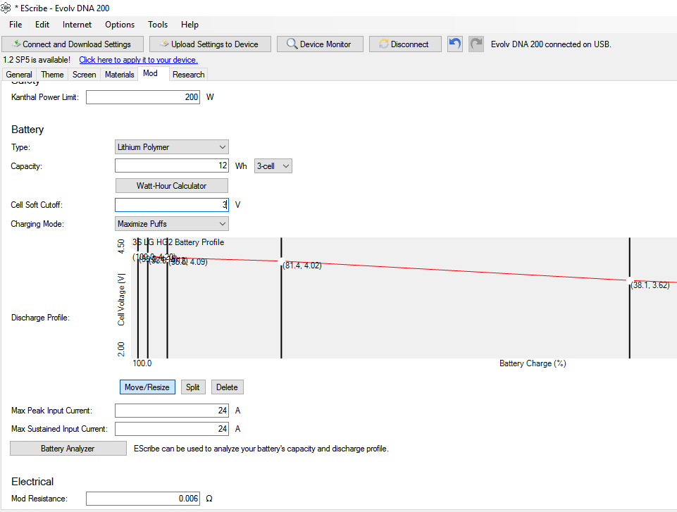

  10. so stick with 12? escribe came up with 12.21 when set at 3 cells and Nominal packk voltage of 11.1?

  12. did those settings. what about the CSV or any of the rest of the settings on the MOD Tab??
  13. I bought the "Player Box Mod DNA133/DNA200 by Starss" and the also the optional "Player Mod 1100mah LiPo Battery by Starss" Does anyone know what Settings to set in escribe once you install the 1100mah lipo battery? I cant seem to find the settings anywhere for doing this.. It comes default with a tray that uses 2 18650 batteries and they sell the optional 1100mah lipo battery pack for $20 that takes it from 133w to 200W if anyone could help with all the settings i need to change in Escribe that would be awesome! Thanks!

  18. i was going by the escribe settings on this page but i am sure they are outdated for the 900mah battery. http://www.volcanoecigs.com/blog/evolv-escribe-use-with-the-lavabox-dna-200.html

  20. I literally received like 5 DNA mods in the past 2 weeks and 3 of them were bad and wont EVEN CHARGE or power on at all and one kept saying warranty The bad unit i plugged upto escribe and they were producing bad battery indicators. 1. LAVABOX DNA200 Received Straight from manufacture Escribe Results Above Received item 12/1/2016 2. SMY SDNA200 Unit would not even power on and had similar results with Escribe as above. 3. HCicar VT200 Would not turn on or charge and had similiar CELL results as above. I have a ton of Sealed lavaboxes in my room and now I am like Afraid of all units with batteries in them might be bad.. I never had a single issue until I switched over to DNA Units with batteries in them then I Started getting mostly Defective Units.. I tired all the USB Recharching thing trick like 10 times and it did not help any of them. Anyhow I was looking here http://www.volcanoecigs.com/blog/evolv-escribe-use-with-the-lavabox-dna-200.html What is the latest EScribe Settings (.ecig) FILE out there that is optimized for the default 900mah Battery? Anyone link me to a download for the best one to use I want to make sure I am getting the most out of my units and the latest one I found was from may 2015 so I am looking for the latest and GREATEST EScribe Settings (.ecig) FILE download for the LAVABOX DNA200 with the factory default 900 battery any it. Anyone can help me out You are the best!!! God Bless and I really hope someone can find the file for me I dont want to brick my units i have 4 open right now and I want the most optimized settings file for them and also the CSV for the battery download file would be great.
