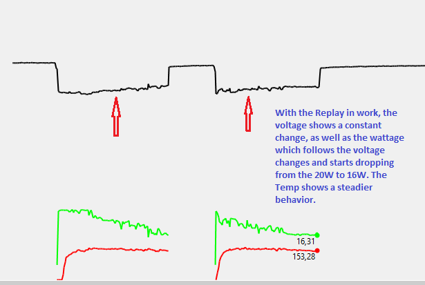

Good day! OK, here you are... The left screen shot is without Replay. Shows Live Ohms, Cold Ohms (purple lines), Temp set (red line) and ranging of the Temp and Watt. Temp is set at 210C and Watt at 17 (without any preheting/boosting) The is rising up to 194C and watt remain almost steady at 17 (during the puff). the increase in resistance is within the normal limits, I think. The right screenshot is with Replay with same settings. That is, Temp at 210C and Watt at 17, without any preheating and warmth at 1. Resistance increases normally, the resistance shows measurable variation and finally drops to 13 giving subdued vaping. Each puff has great differences from the next one, mainly in the variation in Watt, which either drops down to 10 or rises up to 25! -

Thank you @retird Yes I did try. You may see the screenshots in my first post. The top one shows vaping in TC mode, where everything is as it should be, and the below one vaping in TC mode with the Replay function ON. With the Replay function ON, the watt drops down to 9,5 making the vaping impossible. Some times instead, the watt rises to 25-26, making the liquid to boil! A real puzzle, I think... Because I don't get another Mirage to compare, I would like someone who has the same mod to say if he noticed a similar behavior. Even an answer from someone who gets another DNA 75C, would help. -

Thank you @dwgraig1 for your answer. Yes, the other two DNA mods and one VTC Primo mini report the same coil resistance (0,841 - 0844, - 0,851) respectively. The same coil (SS316L) I have tried it in wattage mode, with almost same results. Please see the below screenshots. The leftmost is without the Replay. Watt almost steady at 17. The yellow line is the current. The rightmost is with the Replay On. Watt drops down in a fraction of a second and ranges from 14 to 14.7. Believe me, the two watts make the difference in the vaping! -

Hi All! Can we use the Replay function in TC mode with a DNA 75C or we cannot? Since there is no a clear (and official) Yes or Not, I am totally confused. I own two mods with DNA 75 (HCIGAR 75 nano and SMY SDNA 75). I have a RDTA FODI F2, an RTA SIREN V2 and an RTA HASTUR 24mm. I always use TC with SS316L, 3mm diam, 7 (or 8/7) spirals, 0,78 (or 0,84) ohm and 17 watt. Both mods work very well in TC mode. No problem at all. Few days ago I bought a MIRAGE 75C for its Replay function. The mod works very well in TC mode but not when I try to use the Replay function being in TC. The default theme (original and official I suppose), allows to use the Replay in TC mode. So, I guess there is no "ban"! But... finding the "perfect puff" (the very first indeed), activating the Replay function, the problem appears in two versions: 1st version: Watt rises constantly. Second puff = 18.5 (or so) watt, third puff = 19,3 watt, fourth puff = 22 watt, fifth puff 25 watt! The liquid boils! 2nd version" Watt goes down in every puff. Second puff =15.4 watt, second puff = 13.2 watt, third puff = 12 watt, fourth puff = 9 watt! Vaping impossible! Please see the Escribe screenshots when in TC without Replay function and a Preheat of 20 W. ======= And with Replay function activated (No Preheat). The problem appears (2nd version). If I stop the Replay function, everything is back to normal. I'd very much appreciate your help in this. Thank you Vassilis

Loxias posted a topic in DNA 75 Color and 100 Color
Hi All! A help hand is required to understand the Replay function in a 75C DNA. I will try to give you as much information as I can, so please excuse the big post. I own a Mirage 75C and the Theme I use is that of Frank65. I have created two profiles. One with the Reply activated and one with no Replay. For the time being I use the FODI F2 RDTA with the below settings: SS316L, 28AWG, 7 separated turns on 3mm diameter, 0.78 Ohm, 16W with Punch to 20W and Temp 210 C (Cotton Bacon Prime). Using the non Replay profile, the diagram in Device Monitor is as per below image: What I cannot understand is why the Watt remains on the Punch level of 20 W and don't drop to 16W after a while. Apart that, I'd pleased to hear your comment about the rest of the curves. Are they in the correct limits of a DNA 75C? ======= Using the Replay mode, I have the below diagram: Is this the way the Reply works? That is, the constant changes in voltage supply and the changes in the wattage is because the Replay tries to reproduce the saved puff? What I see is correct or I have done some kind of a mess? Any help should be much appreciated. Thank you! Loxias
