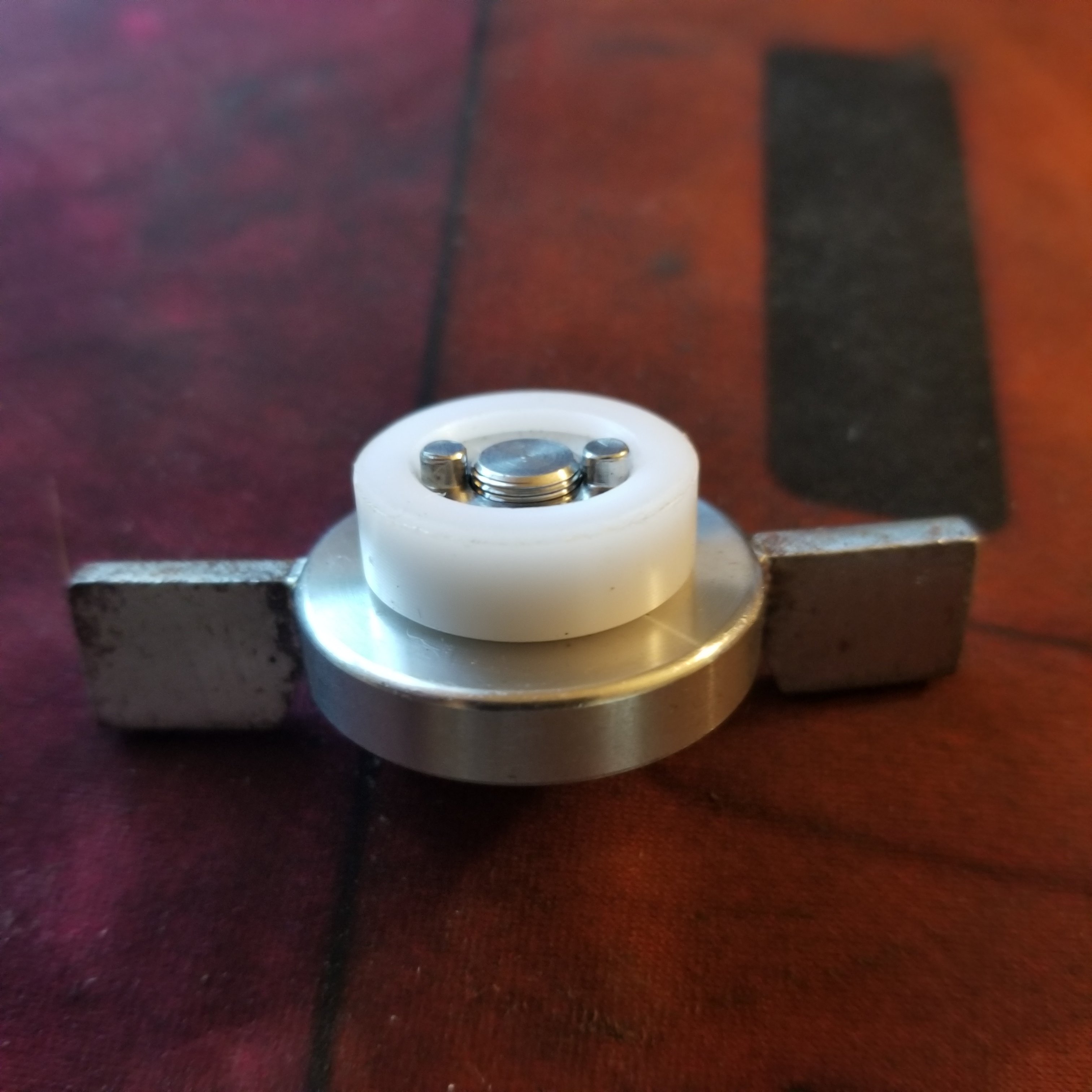

  4. That is correct. It is a Black Nickel plating. We also do not use glue. The sealant is from the locknut down and not interfering with the ground beneath. If it was super glue as I believe someone may have mentioned, you would not have been able to unthread it without heating it up. Still not even necessary on this model. Not sure what you are referring to a plastic or a socket, but our 510 has a peek insulated bushing and cap which screws directly into the 510 collar. Its diameter is smaller than the opening of the locknut. From your pictures it is fully intact and not damaged in any way. During assembly, the locknut in placed in its channel, the 510 collar with pin assembly dropped in from the top and tightened. No force of movement of the locknut. Again, rush or not, this is a mistake made which is simple and no excuse for. Especially when designing a tool costing over $1000 to insure a proper and tight connection. We apologize to the very few effected as we always strive for 100% customer satisfaction and perfection. We've walked through a couple of users in the last 24 hours who's unit's are now working perfectly from the above suggestion as well as duplicated and corrected the issue in our facility.... insuring the issues does not ever arise again.
  5. Thank you everyone here for your helping out. We have isolated the exact cause and issue and have taken the necessary measures to ensure this will not occur going further. The themes are fine. Units ship with the default theme which is Evolv's default simply with a few Boxer and 20700 settings adjustments. The Custom is based upon JakeT and JCB's most popular DNA75C theme with adjustments for Replay and the 250C. It is not the black 510 as the Black is Nickel. Also not the sealant. Simply, and embarrassing, that the 510 was just not fully tightened. AMD, thank you for bringing this to our attention. Glad you are experienced and no, you did not void your warranty.... we stand behind all we sell. Wasn't necessary to go through all the steps you did, but when you did tighten it back together it did correct the issue. If anyone else is experiencing an issue, you can simply from the top of the device (no need to go to the insides as the 510 pin is floating and the locknut secured by the enclosure itself) use either a wide flat screwdriver or a dime in a pair of grips and first loosen the threading a tiny bit and then tighten as much as you can. If you do not have the tools to do so, please contact us at info@gingervaper.com and we will issue a RMA to do so and fully test afterwards. We do have a custom 510 tool that will tighten this connection and again, while only a small handful of the few hundred already shipped, no reason or excuse for even one to have shipped this way. Very sorry for the inconvenience this has caused the few effected.
