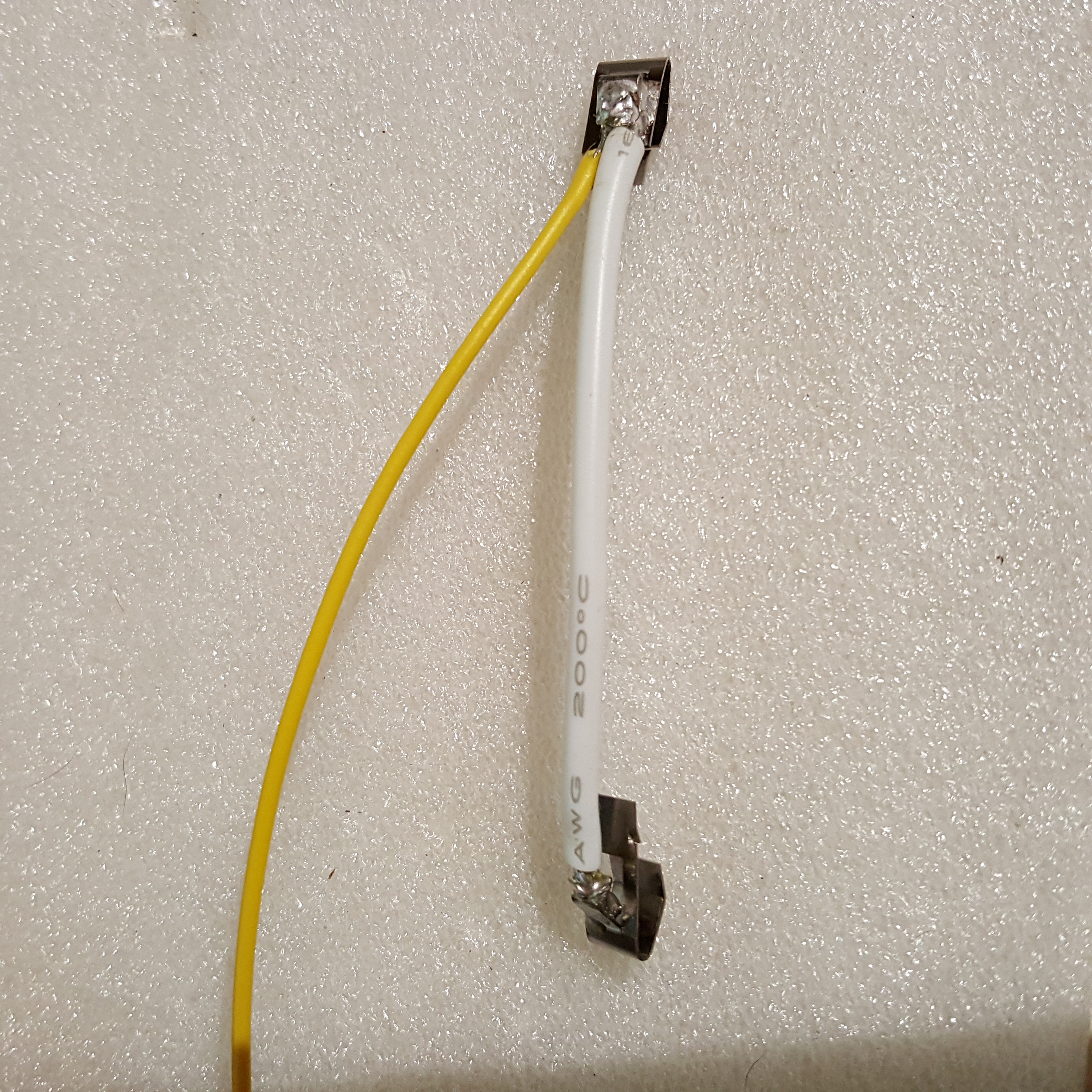

  10. How'd you make out with this @monty72? Although this unit did not come from us, we'd be more then happy to help you. Here are our instructions:https://gingervaper.com/wp-content/uploads/2015/09/Boxer_DNA133_DIY_Instructions.pdf Just from a quick look, I would guess your issue is with the connection of the +/- jumper and yellow JST. We do NOT recommend doing it this way as it will cause this exact issue if not done perfectly. You should make a straight jumper and solder the yellow directly to either side of the jumper's battery clip.
