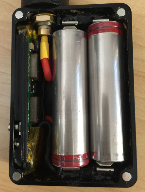

That looks like flux residue that wasn't properly cleaned from the board. Pure rosin flux isn't normally that bad, but you have no way of knowing what type of flux that is and it looks like the flux was burned. There also looks to be some melting on the jst connector where the tip of the soldering iron was pushed against it while either soldering or re-flowing the solder on the positive battery pad and I'm not even sure what the chunk is by the fuse, but I'd get that cleaned off too. I usually use everclear(or any PGA) to clean flux by applying some to a brush and the rest of the bottle to me. I'm not sure if the PCBs ever come clean, but I'm too drunk to care at that point. -
