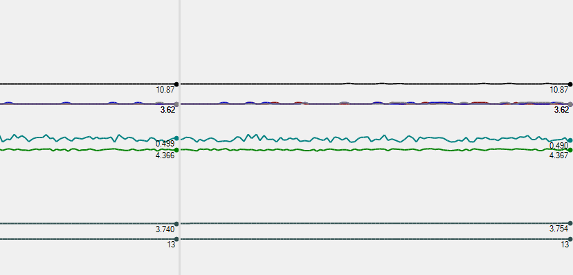

Problem with new Windows 10 1903. The monitoring windows display the value and graph, but after a small time, graph does not progress even if the value on the left part seems updated, and another small time after, the value on the left part also also no more updated (they stay fix). Before, with previous version of Windows 10 (1803), i don't have this problem. Does anyone also have experienced this ? -
