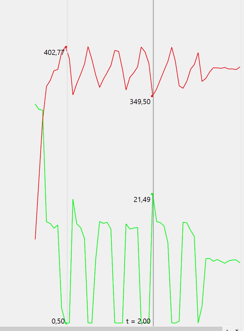

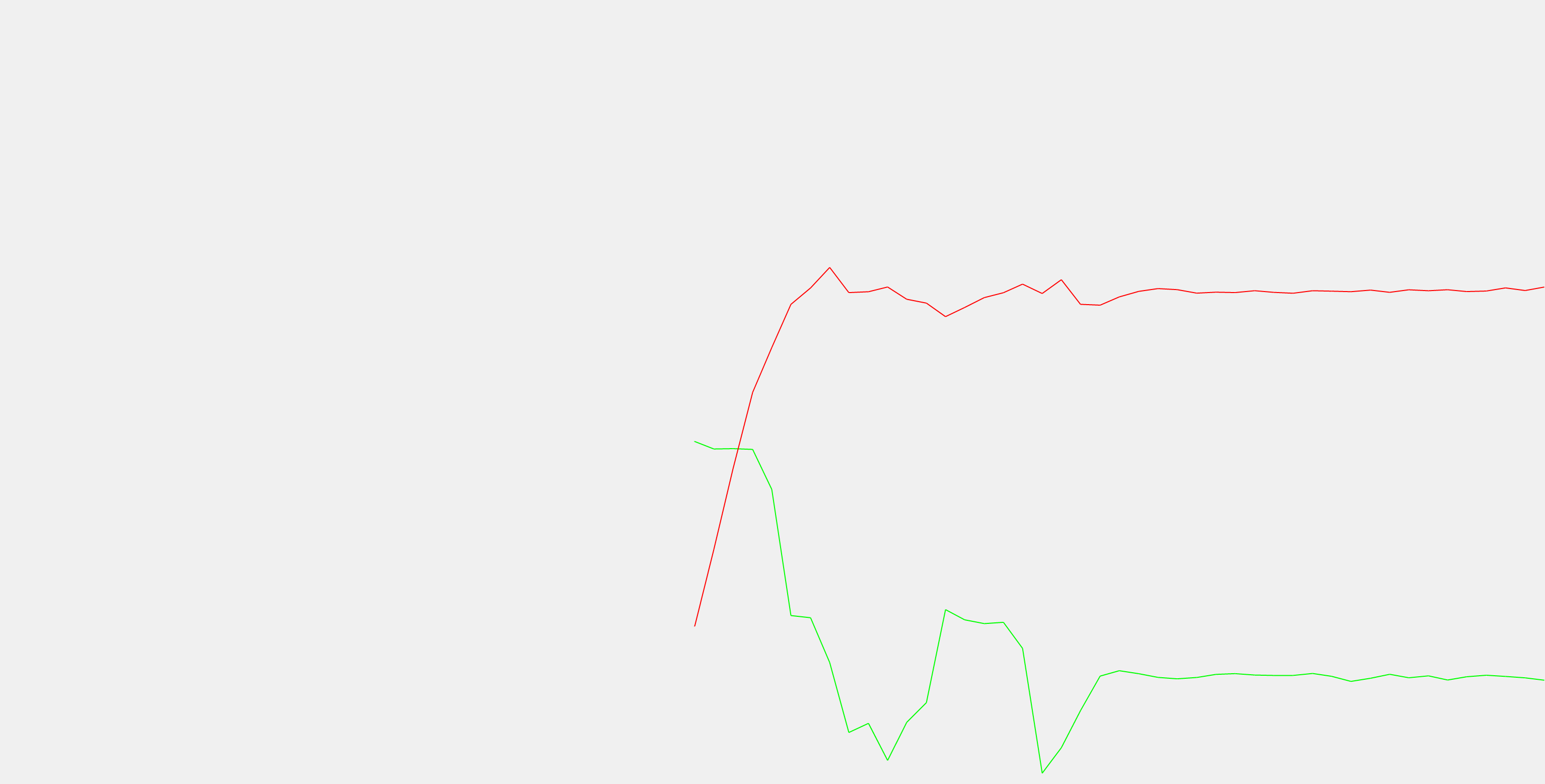

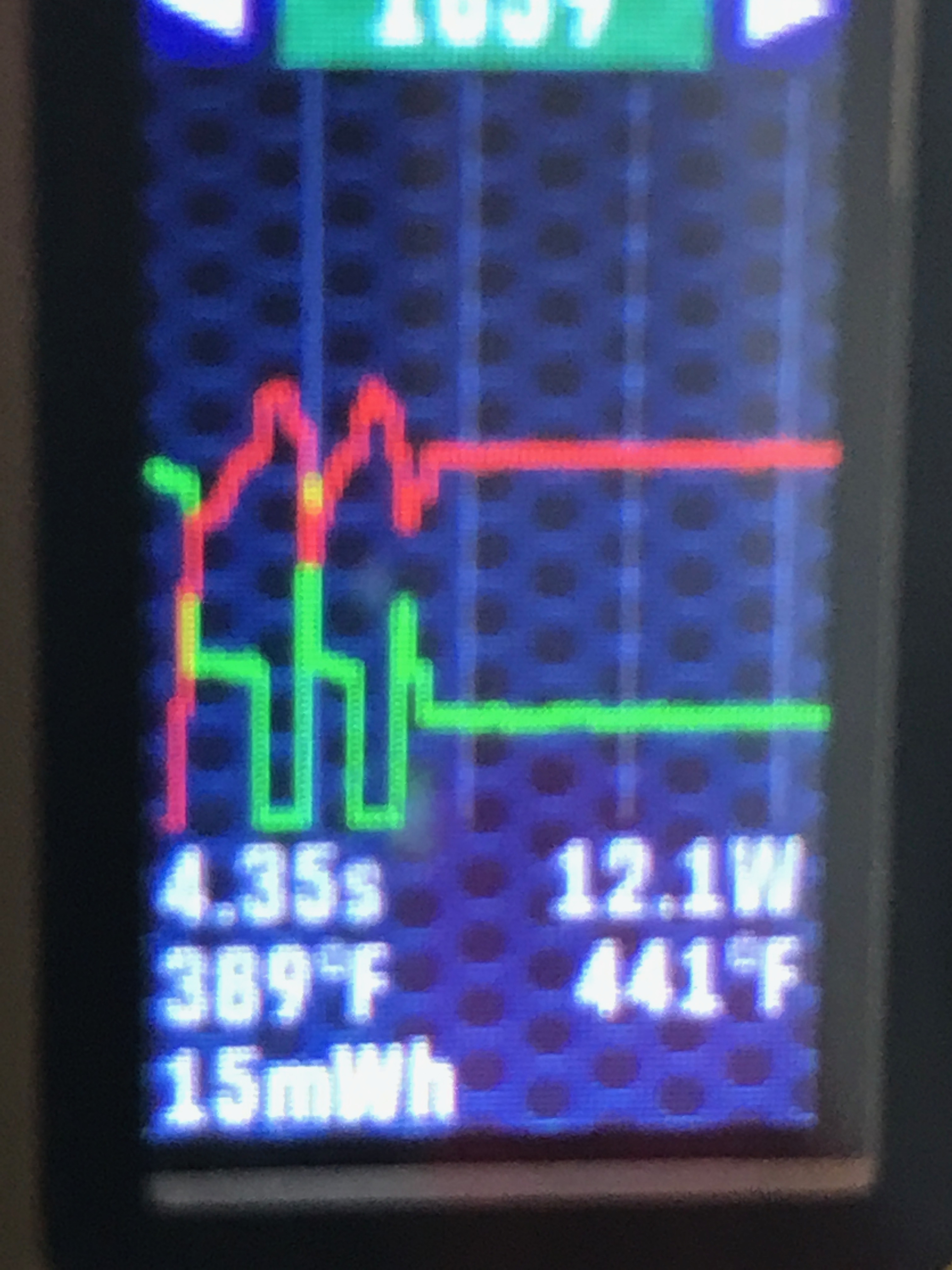

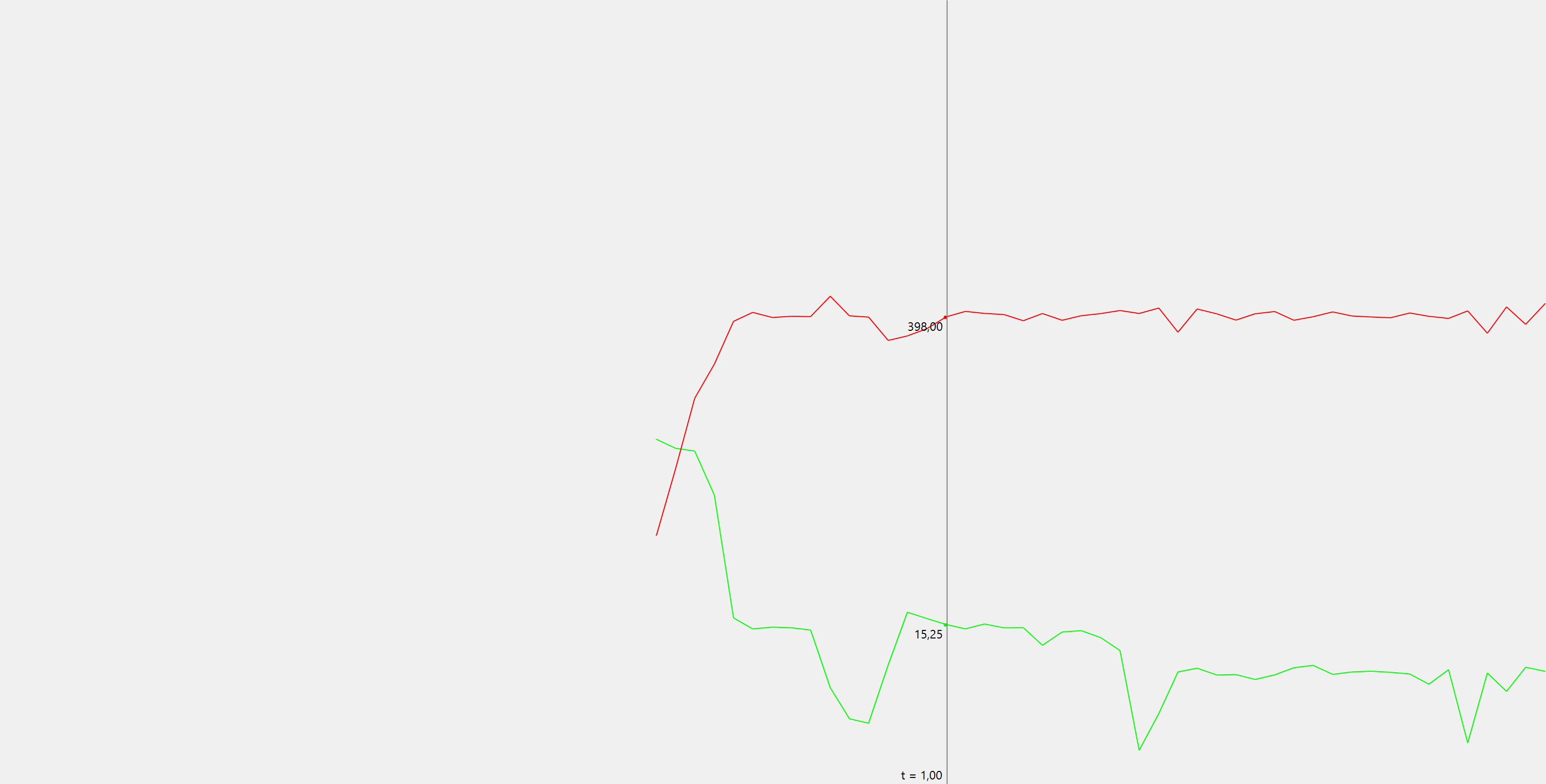

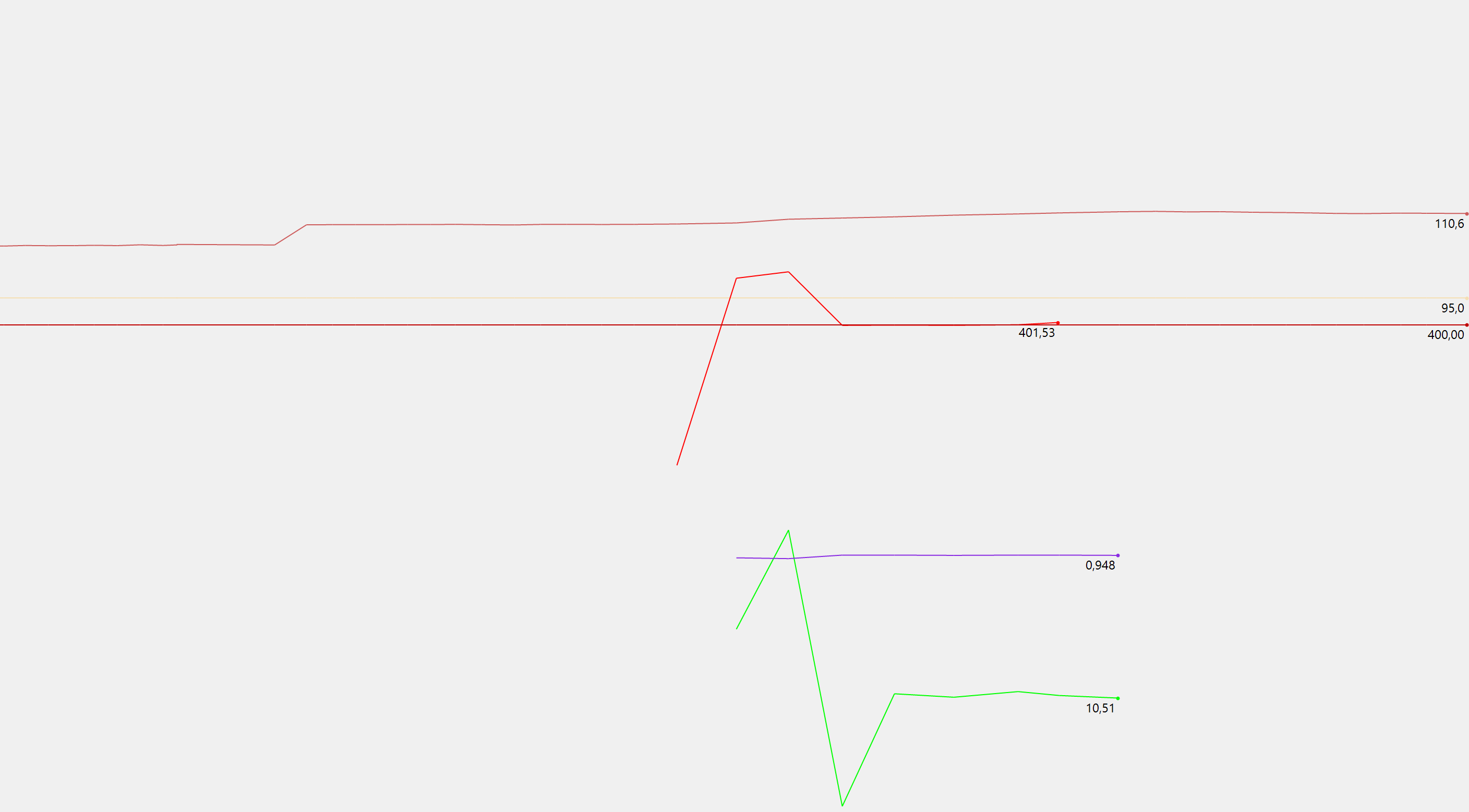

  5. @James, yes you're right. I didn't notice it but the steady state power for COB=0.025 is about 10W, while for COB=0.0625 is about 15W. Both puffs were taken with power set to 16W, TEMP=400F, pre-heat 32W 395F. I tried with COB=0.04 and I got this COB=0.04 The "first" steady power is ~15W (as you can see from the cursor), while the "second" one is again down to ~10W. Tried also with COB=0.05, got a first puff still pulsy, then the following ones were pretty much like COB=0.0625 (with steady power ~15W), but it felt like it was less repeatable and on the verge of pulsiness... As a side note: while on COB=0.0625, for a couple of time I got immediate "temp protection" when trying to fire. Then at the 3rd or 4th attempt it started firing again.
  6. Hi @James, sorry for the late reply but I've been again on the move and couldn't access Escribe until today. Whatever this setting is doing, it works! I just got a bit confused initially because it seemed like it worked just "for a while", then I realized that after a while (maybe when the device locks/unlocks or when I reconnect to Escribe?), the setting reverts to 0.025, as confirmed by X=GET COB. I couldn't really nail down exactly when/why, but I then started to always setting it back to 0.0625 before testing and then I got repeatable results. For comparison, here are two consecutive puffs, the first with 0.025 and the second one with 0.0625: COB=0.025 COB=0.0625 I hope this is what you expected and gives you all you need to maybe prepare another service pack which makes this a permanent setting? Eagerly waiting for your feedback, thanks again.

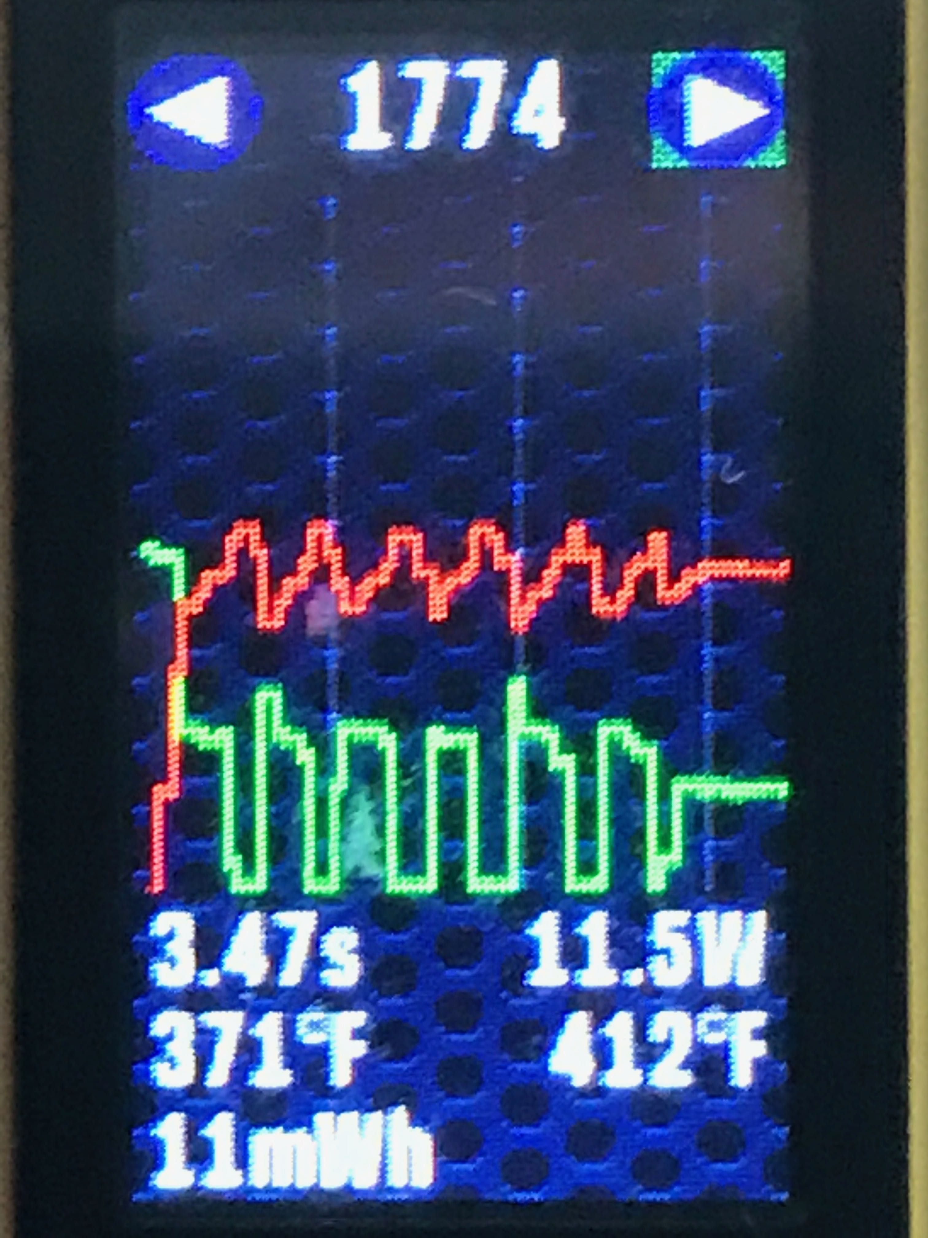

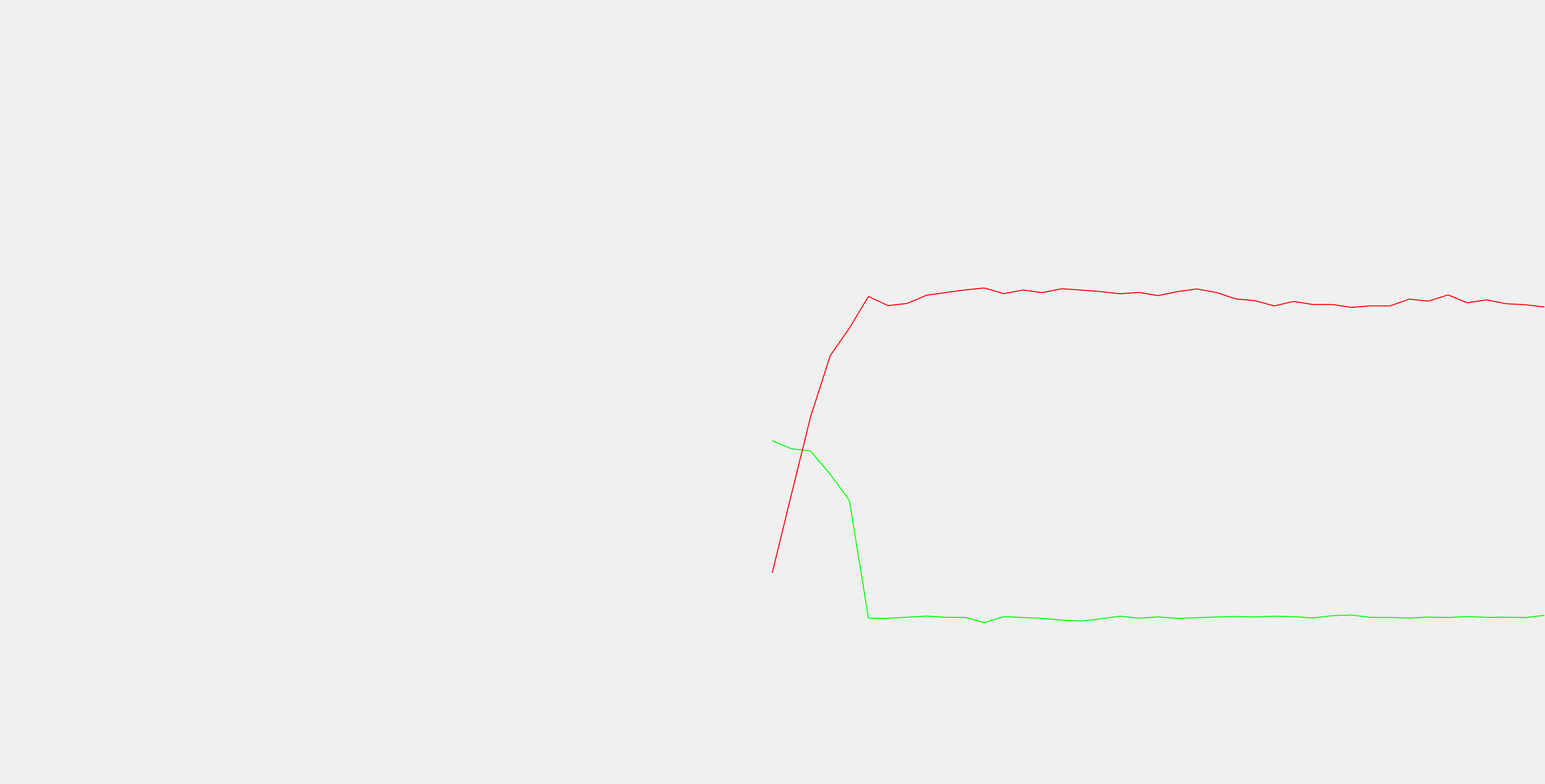

  7. @James I don't know enough to follow your reasoning, but here's the screenshot of the puff#1774 once I downloaded it in Escribe. I've put a pair of peak/valley cursor for you to see the TEMP/POWER levels
  8. @James I did some testing with the last cold values (.08253@83F). I did a series of puffs, approximately 3 seconds each, every 5-10 seconds, giving the "X=READ DEBUG" command after each. The vape parameters where: COIL: SS316L, Steam-Engine profile TEMP: 380F POWER: 17W PREHEAT: 35W, 365F I then saved the log of the terminal session and annotated each result with the classification of the puff it refers to: REGULAR for a good stable puff for the entire puff duration PULSING (PARTIAL) for a puff that pulsed at the beginning of the puff and then stabilized PULSING (FULL) for a puff that kept pulsing for the entire duration Below is the annotated log, and after that, the screenshot taken on the device for the last puff which was the worst in terms of pulsing. (I'm not attaching the screenshots for the other partial as these images are quite heavy and I've no reliable internet connection at the moment, but if you want to see some of them just let me know and I'll upload them too. You can just picture them has being the same as the attached one, with just the power square wave lasting for about just 1/3rd of the puff). Here we go: ANNOTATED TERMINAL LOG: X=READ DEBUG X=-0.050 REGULAR X=READ DEBUG X=-0.097 REGULAR X=READ DEBUG X=-0.101 REGULAR X=READ DEBUG X=-0.096 REGULAR X=READ DEBUG X=-0.098 REGULAR X=READ DEBUG X=-0.129 PULSING #1 (FULL) X=READ DEBUG X=-0.098 REGULAR X=READ DEBUG X=-0.021 REGULAR X=READ DEBUG X=-0.096 REGULAR X=READ DEBUG X=-0.122 PULSING #2 (PARTIAL) X=READ DEBUG X=-0.096 REGULAR X=READ DEBUG X=-0.092 PULSING #3 (PARTIAL) X=READ DEBUG X=-0.100 PULSING #4 (PARTIAL) X=READ DEBUG X=-0.096 REGULAR X=READ DEBUG X=-0.166 REGULAR X=READ DEBUG X=-0.121 REGULAR X=READ DEBUG X=-0.122 PULSING #5 (PARTIAL) X=READ DEBUG X=-0.080 REGULAR X=READ DEBUG X=-0.126 PULSING #6 (PARTIAL) X=READ DEBUG X=-0.224 PULSING #7 (FULL) ON-MOD DEVICE MONITOR SCREENSHOT FOR "PULSING #7 (FULL)" PUFF: Hope this will be of some use...

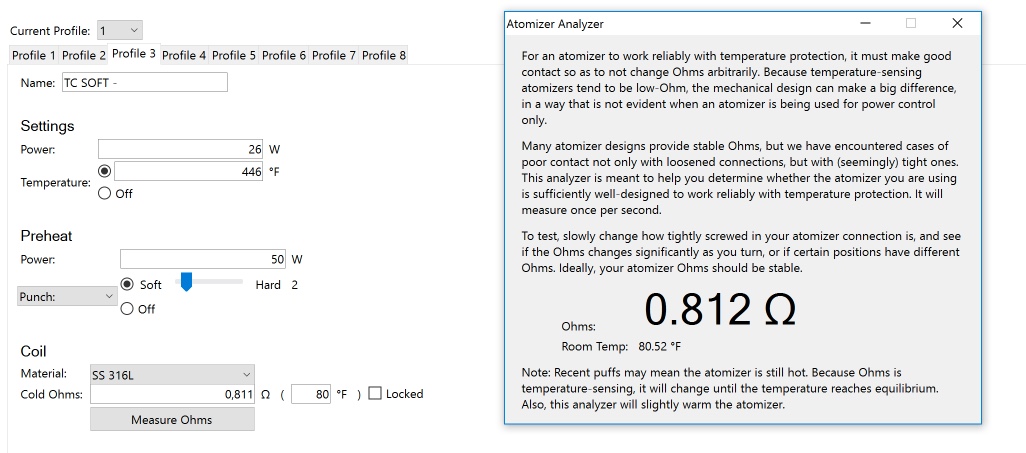

  14. Exactly my concern too Yes, definitively reading cold ohms too low, even after fixing the thermal properties of the meod. That seems to only have fixed the room temperature sensing and yes, it'll probably show the same behavior with other wires as well, although I haven't tried anything else than 316L That's why I'm trying in all ways to get some attention about this issues, hoping Evolv will eventually come back with some explanation/fix. I'm unfortunately not really succeeding for now, gladly welcoming anyone else that might want to voice up...

  22. And exactly the same happens here, on a therion 75C as well. I always have to manually fix-up the cold ohm reading to the value I get from my other DNAs (200 and 75), my SS316L is sampled at around .72 on those, but always less than .71 on the 75C. But as I've reported in another thread, I can see the measured room temperature is around 10F off. I have not tried to run case analyzer to see if that fixes the miscalculation of room temperature and hence fixes the low-ohm reading as a consequence. I'll try as soon as I can get a 3 hours time slot...

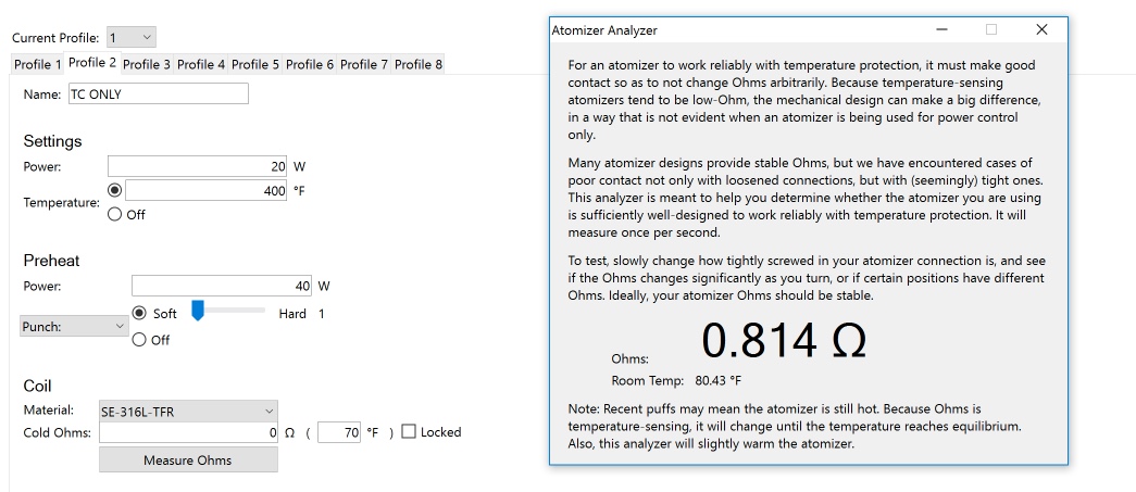

  24. Ok, here I am with another one... Same Escribe 2.0, latest SP2, same lost-vape therion 75C. I'm experiencing an apparently weird behavior with the re-reading of atomizer resistance (see attached screenshot for what part of the interface I'm referring to): If I press the button I can see the resistance being updated (which I suppose is the expected behavior, since we're re-reading it) BUT ONLY ON CERTAIN PROFILES. I'll try to explain: I have 8 different profiles, with 1 for power and the other 7 for different pre-heat setups all of which for TC, with the same temperature-dominant setting and material (SS316L, csv loaded from Steam-Engine). In my particular case, re-reading only seems to update the resistance (and the text field for the temperature, which is another thing I don't fully understand, but let's keep that aside for a moment) on profiles 1 (the watt only) and profiles 3, 4, 5 (all TC, just different pre-heat). I can press it a thousand times on e.g. profile 2 and it never updates neither the displayed resistance nor the temperature. I'm not fully sure about profiles 6,7,8 as I'm again not in front of my pc right now, but I'm sure it doesn't re-read (or at least I don't see the usual behavior) on profile 2, which is again TC, temperature dominant, no pre-heat, SS316L). So my 2 questions: 1) What is this function really doing? Is there something I'm missing that could explain what I'm seeing? 2) As hinted above, I don't fully understand what the reported temperature field should be expected to show. Is it the actual room temperature as sensed by the chip at the moment I was re-reading the resistance? In other words, is that expected to be the "cold" temperature as in "the temperature at which the cold ohm reading is acquired"? Because, on the profiles where re-reading works, the values for temperature that I see there all seem a bit too high for my room temperature, but maybe that can be due to the mod slightly heating up during this procedure and/or the mod (unfortunately) not coming temperature calibrated by lost-vape, and I haven't yet had a chance to complete the case analyzing procedure? I'm a bit confused...
