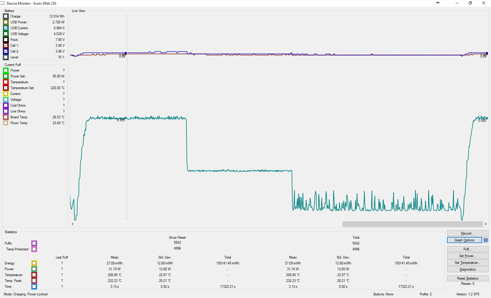

  2. I reuploaded the settings I had when I posted the graph (I received a new ecig file from Sbody in the meantime) and this is how it looks now. The behavior is different but the drop is still there, although now it does it much later (the graph is set to 360 seconds). The starting point of the Room temperature is complete bullshit, it si definitely not more than 20 degrees in the office right now
  3. James, no it was doing the same regardless of the power level and it was the same on USB charger (from a laptop docking station) and on a regular 1A wall adapter. What I don't understand is that after Upload settings to device it was charging at 1A, after cca 45 seconds it gropped to cca 0.48A, and after another cca 45 seconds it fell to the erratic 0.2-ish A. After another Upload settings to Device the whole process repeated in a very similar manner (the graph scale is set to 180 seconds). Both drops to 0A represents the Upload settings to device
