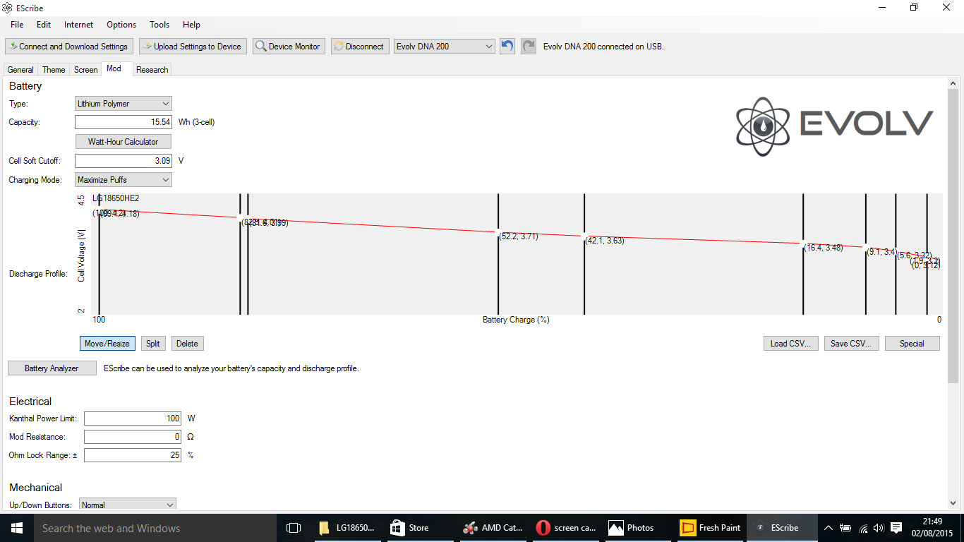

  13. VapingBad you are the man! I must have downloaded an earlier version. Weird because escribe offered me an update.

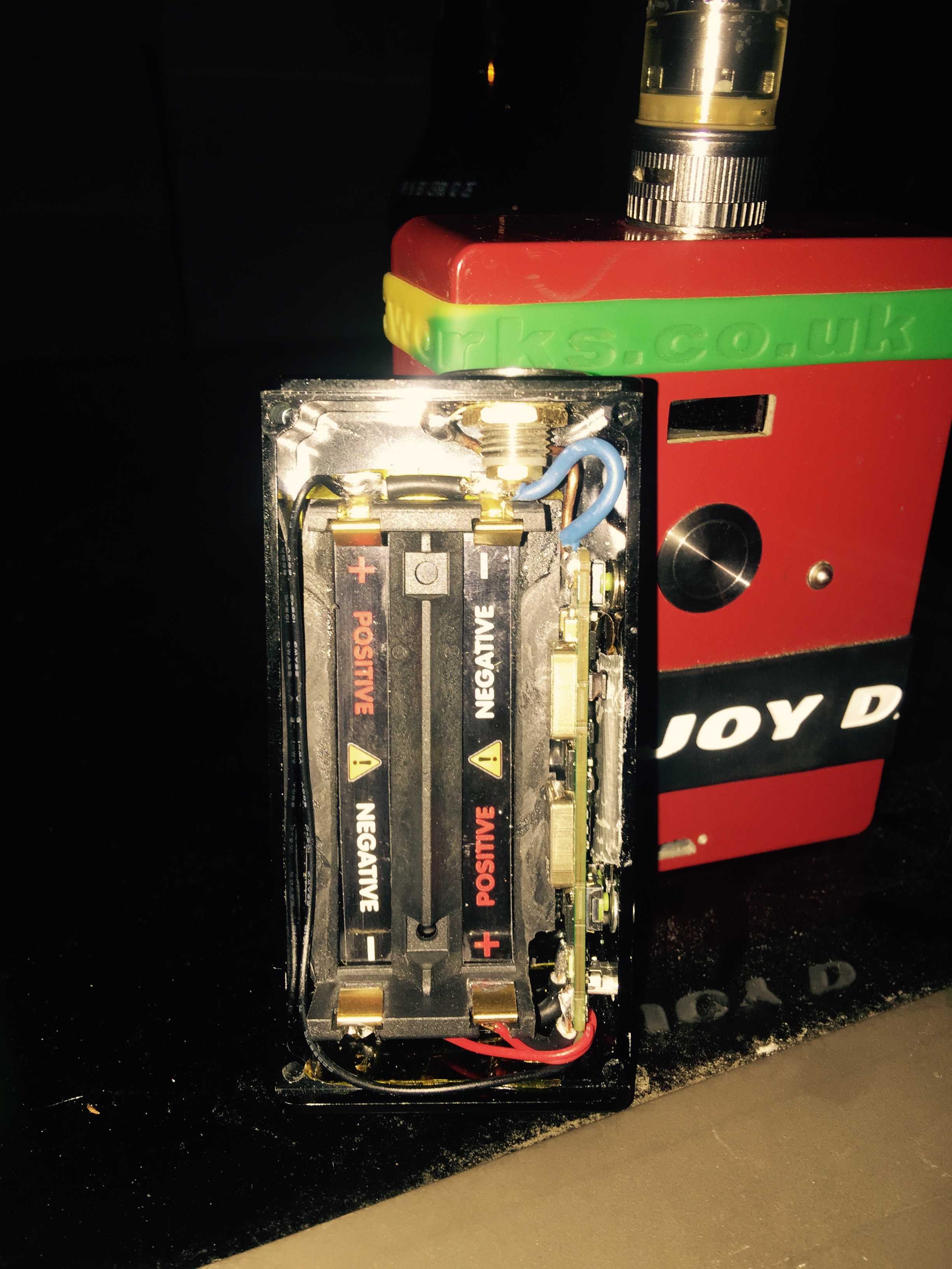

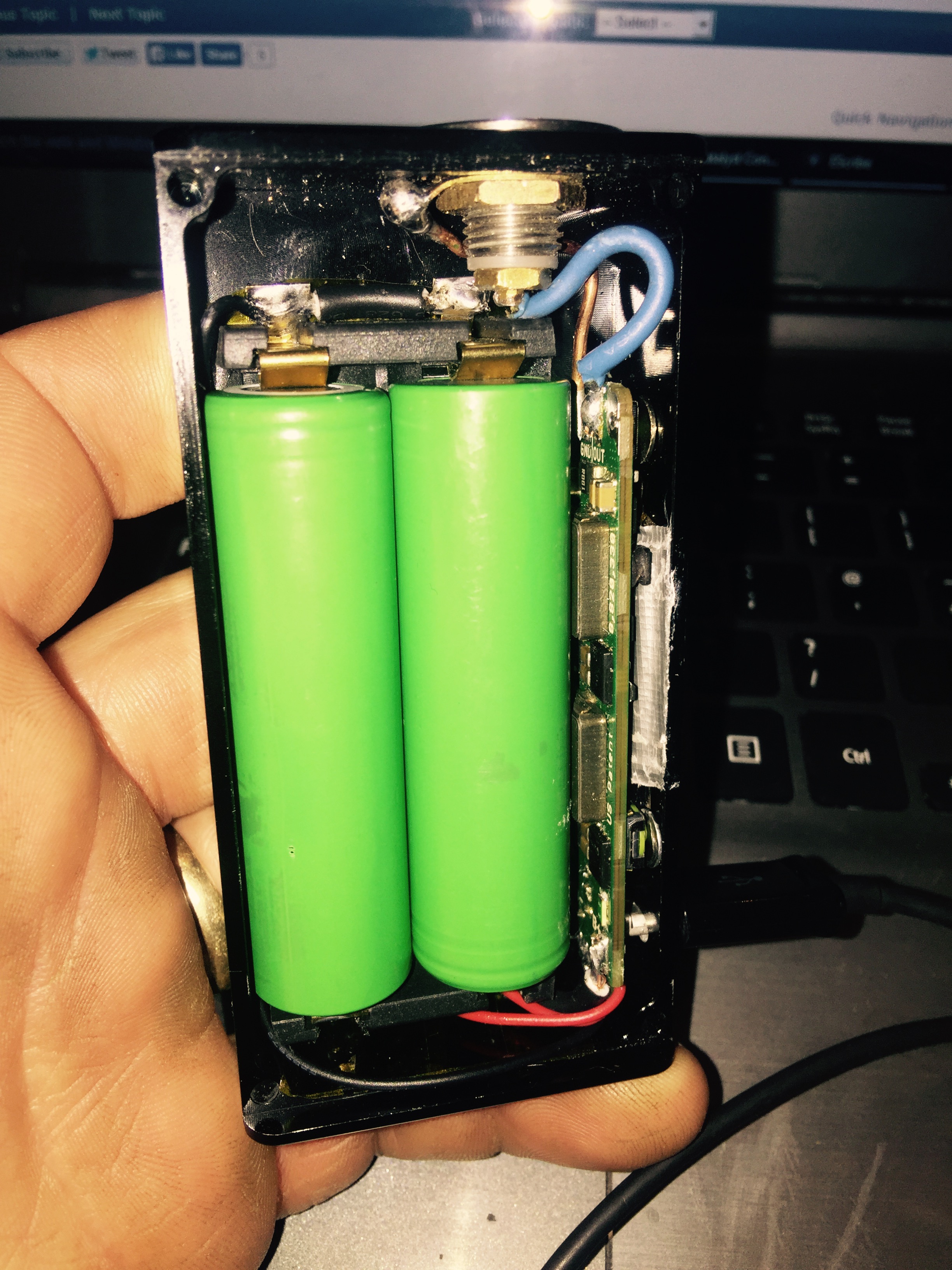

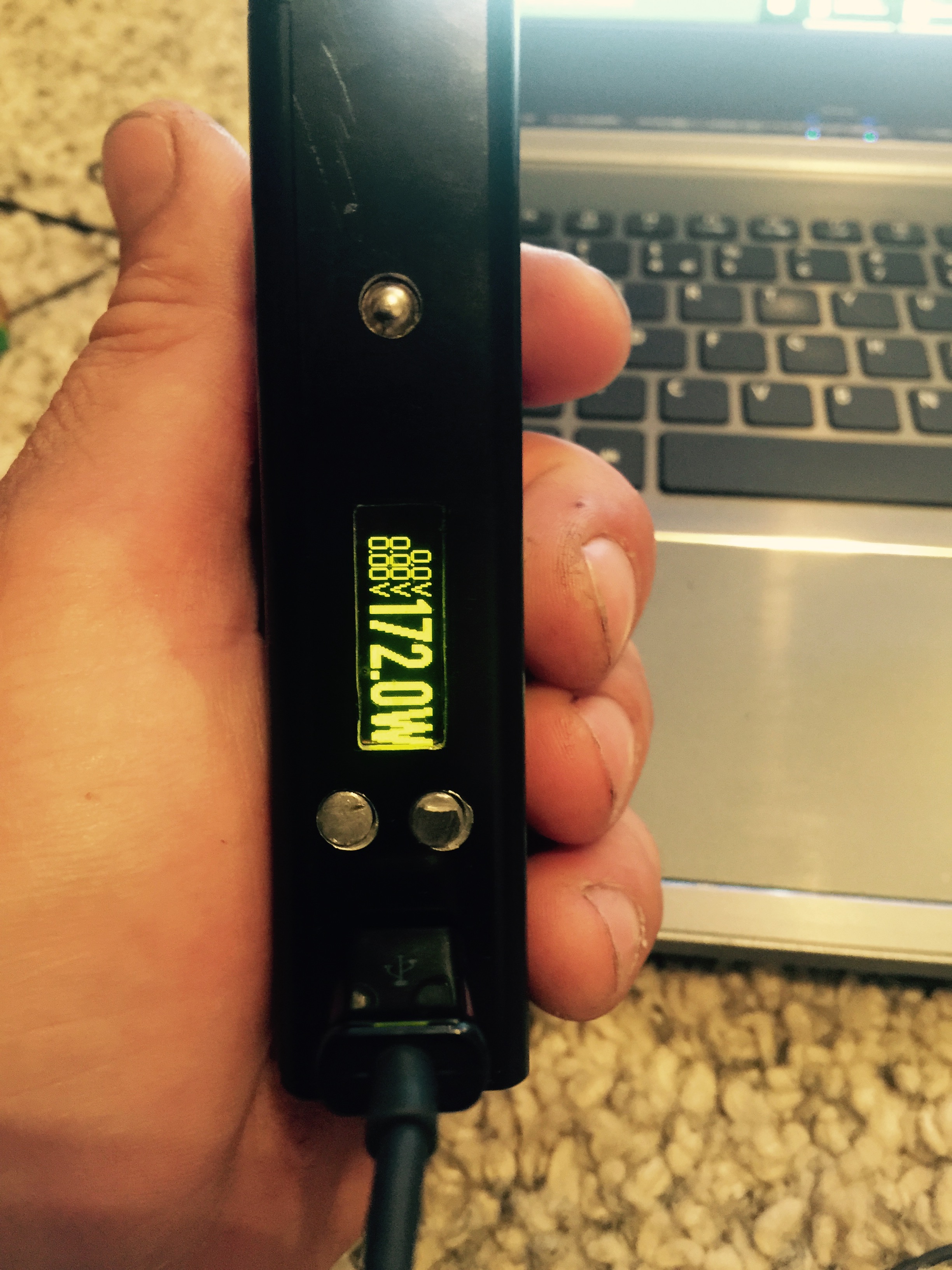

  14. Nearly finished this one. 2s 18650's just gotta glue the magnets and couple of other little bits. Modmaker case, its a squeeze butt it fits!100mmx50mmx24mm
  15. I reinstalled escribe yesterday when i updated to windows 10 and have since updated escribe.
  16. Windows 10. It does nothing when i click on it.
  17. I must be blind can you point it out?
  18. Thanks but I have already done that but it still says 3cell and wont let me change it.
  19. I have built a 2s mod, how do i change it to 2 cells in Escribe? I cant find it anywhere. Thanks

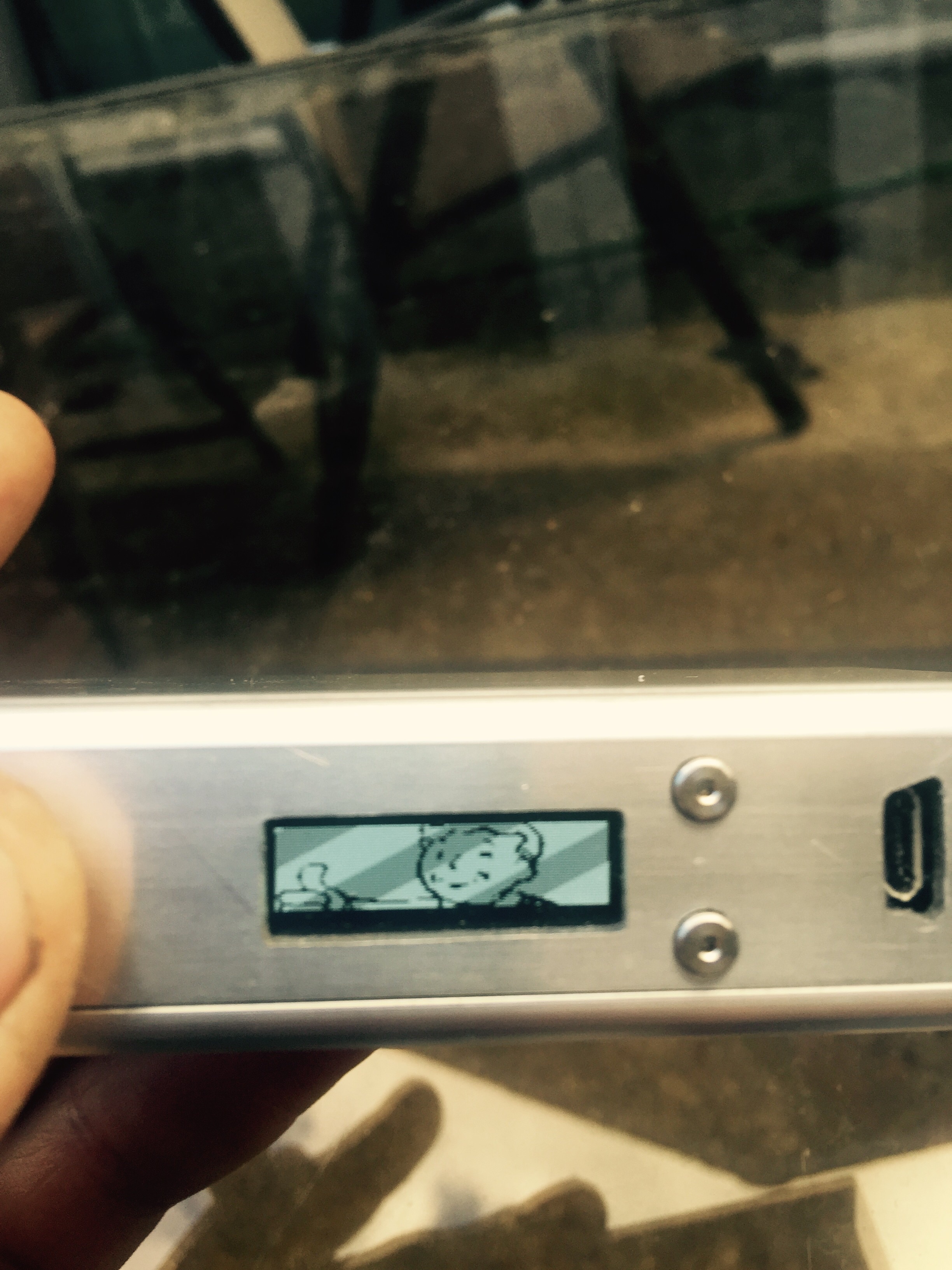

  21. Love that orange screen. I might have to steal that idea!

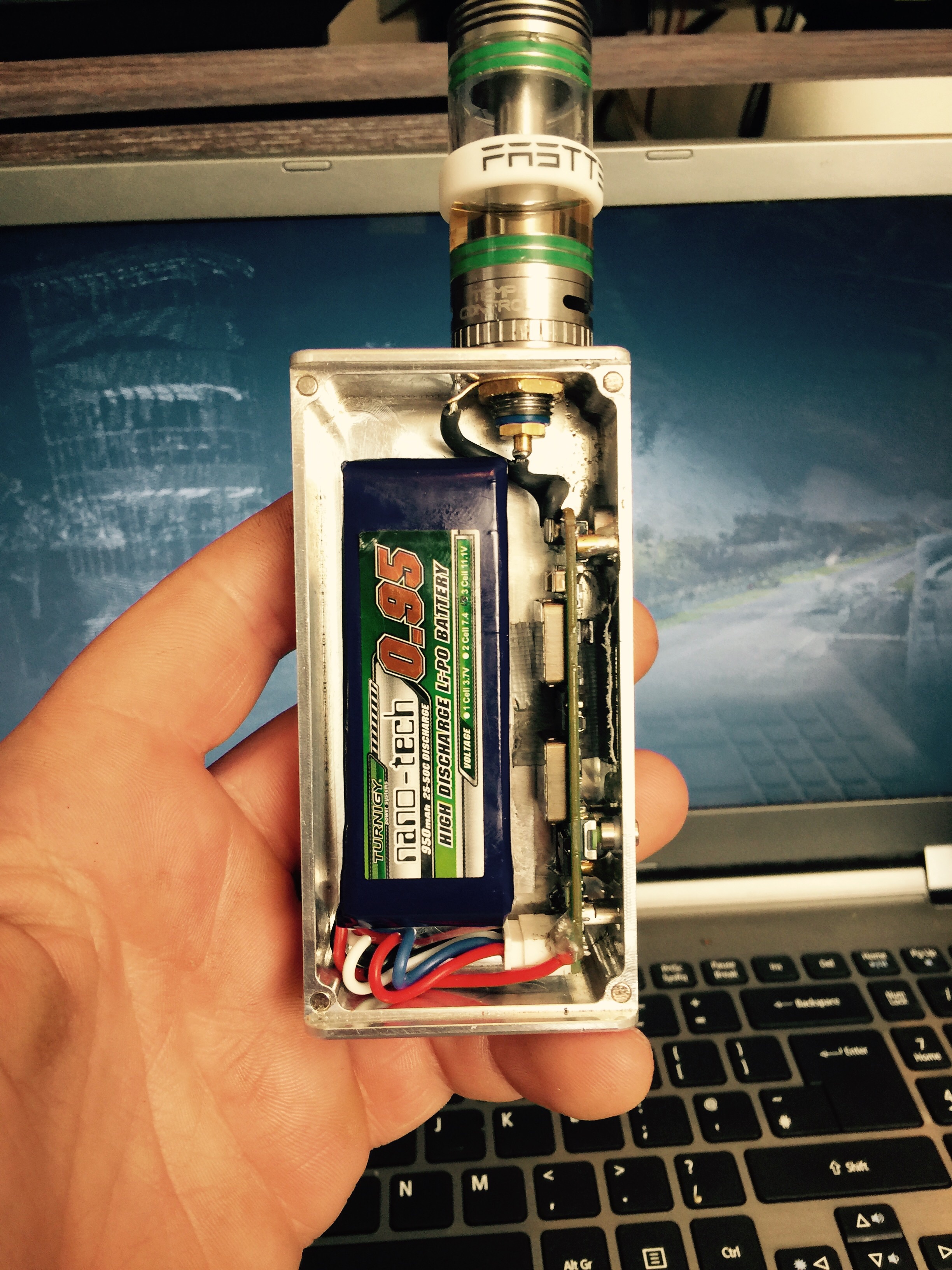

  23. I had the chip mounted in a different box with a bigger battery where all wires were 14awg. Switched to the 950 nano battery and didn't bother upgrading the wires as I think john on here said they were good enough as they are silicone coated.
  24. Finished the internals now
