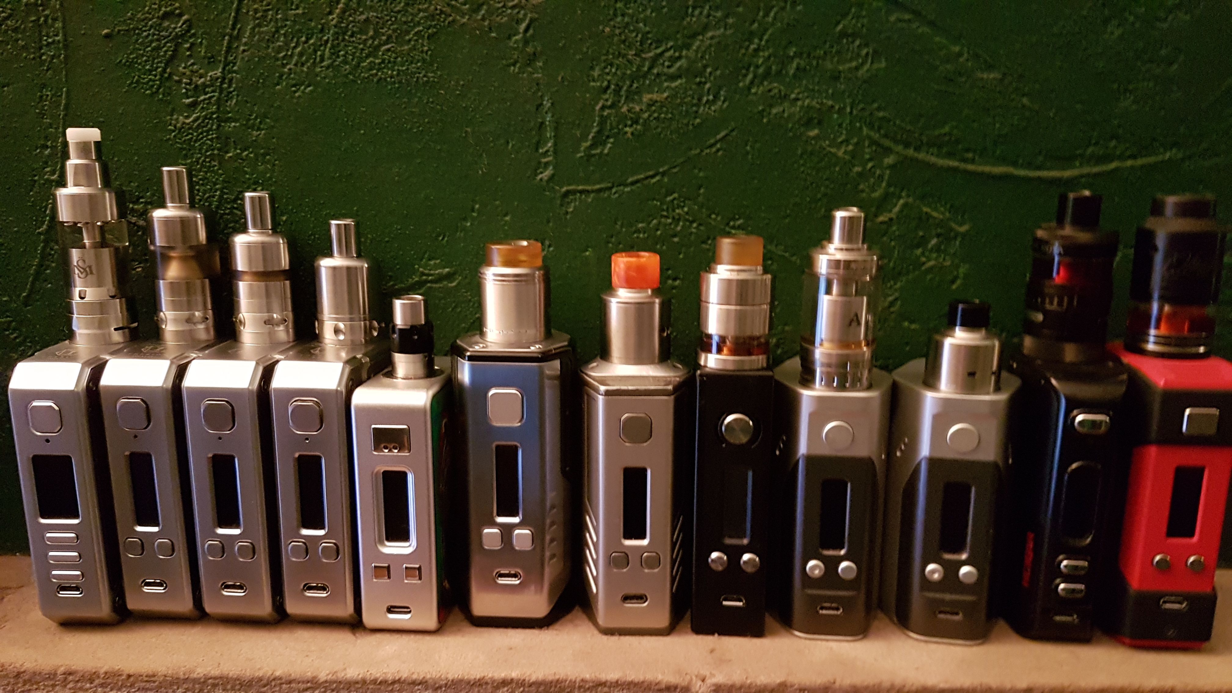

  3. I don't doubt that is true, However I can only speak from experience. I own quite a few DNA devices and have never had a problem with any of them until the 75C. My first one was reading the resistance too low, it still does and when I try and use that mod I am just guessing at temperature because it reads a different resistance to the dozen or so older type DNA mods I have. If I do decide to use it I then have it nag me throughout the day, constantly asking if I have changed the coil. I have run the case analyser countless times before you tell me I need to do that. That was never a problem with the older DNA boards. I bought 2 of the Therion BF 75C's and they now read the resistance too high, so once again I am left to guess at what the temperature might be. I have lost confidence in what was widely regarded as being the most accurate device on the market and wont be buying any more. Whether its reading too high or too low it is no longer accurate, Vaping on a 75C has become a chore. I cant rely on being able to pick up my mod and enjoy a vape. So as a result the 75C devices I have bought wont get used.
