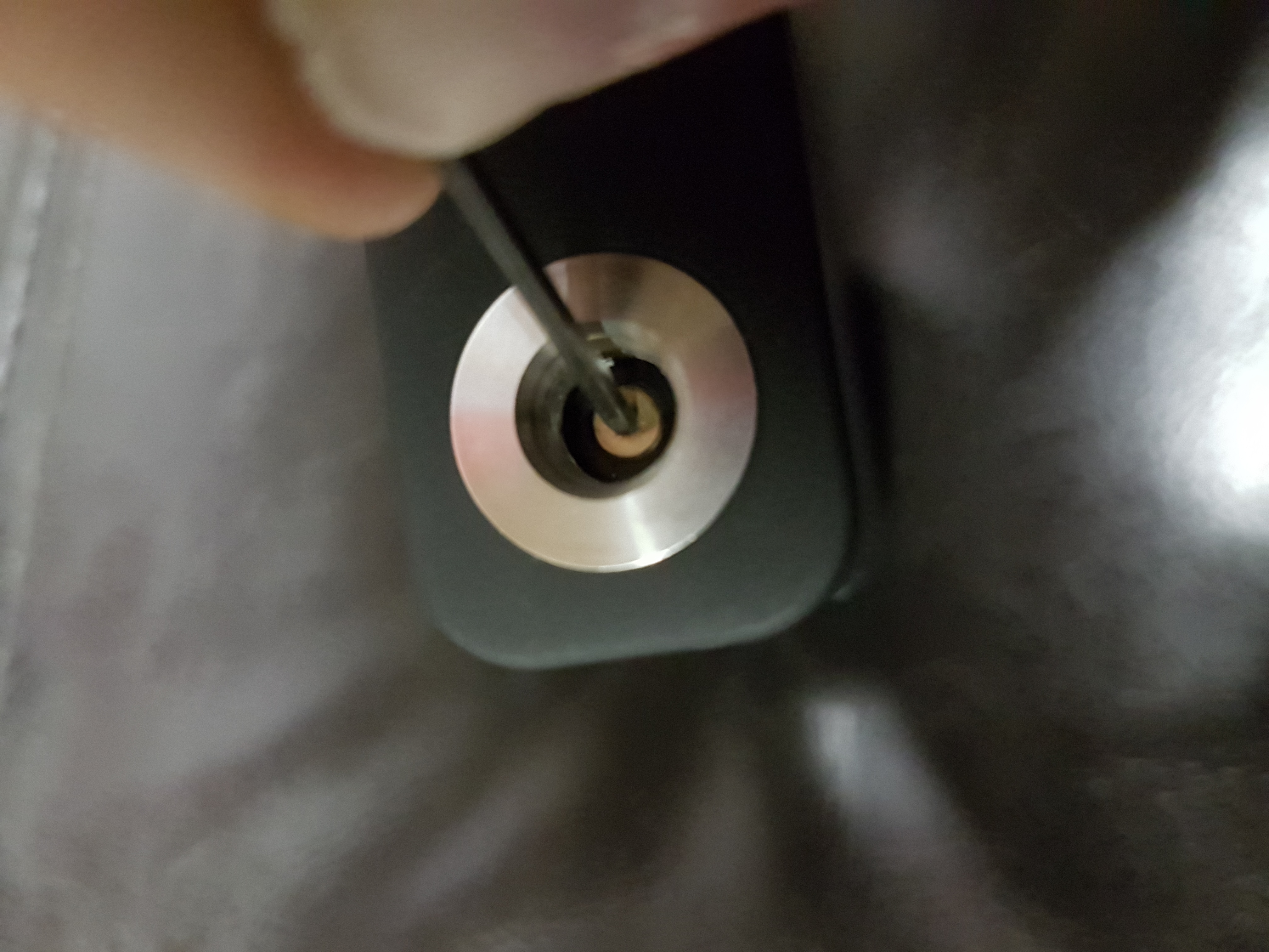

Ya the 510 center pin when pushed in looks like it sits flush with the black part. I screwed in an atty so tight that I had to use vice grips to get it off (old kayfun). Maybe just tighten it down with the vice grips or bad idea? Oooo and I took it apart already day 2 and fixed the screen that sticky tape is crazy strong but now it's perfect.
So just bought the sdna75 by smy and it's not great. None of my attys (5) screw down flush and it looks like it should but won't. I have tried forcing it thinking that maybe it's just the threads and have cleaned the 510 threads and it did nothing. My screen is off not a big deal but not pretty to look at. I'm sure I can take it apart and center it better but who wants to void there warranties and wait even longer for it. Any help would be nice with the 510 I have the bellus the griffin 22mm the g24 rda the azeroth and the crius and none go flush thanks guys
