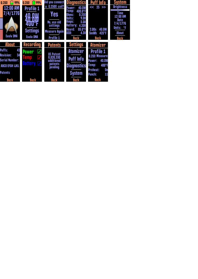

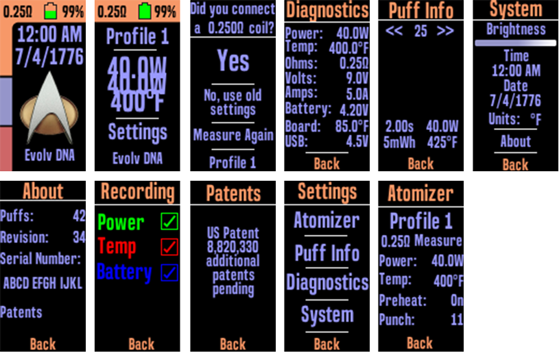

  6. I have made this Star Trek theme for anyone wanting a trekkie theme, the theme was based around Evolv's default theme with a few tweeks. The battery bar, should change colours from green to yellow at 20% and red 10% to better indicate the state of the battery. I have also attached the files I used, they are in Adobe Photoshop and Illustrator CS6 formats feel free to amend as you please and re-post. Hope you enjoy!! DNA75C_ST LCARS.ecigtheme StarTrek LCARS Theme.zip

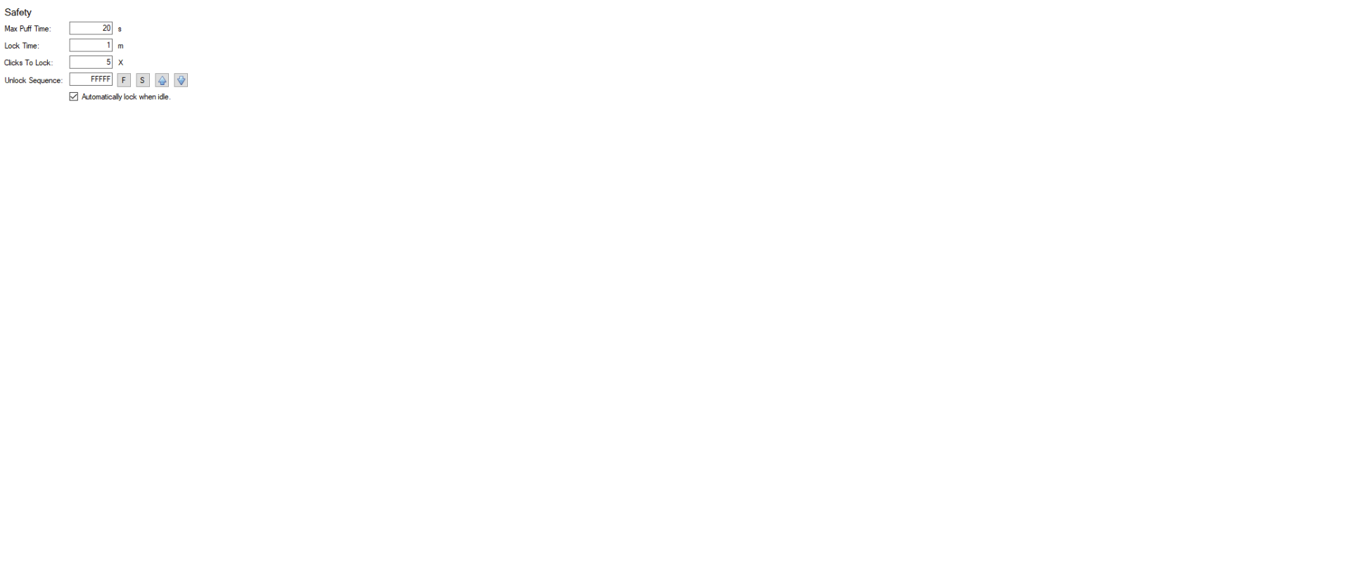

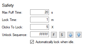

  11. Is anyone else experiencing issues with the auto lock feature? When you un-check the box "Automatically lock when idle" in the general tab, it ignores the selection and continues to lock the device at the predefined time that had previously been set.
