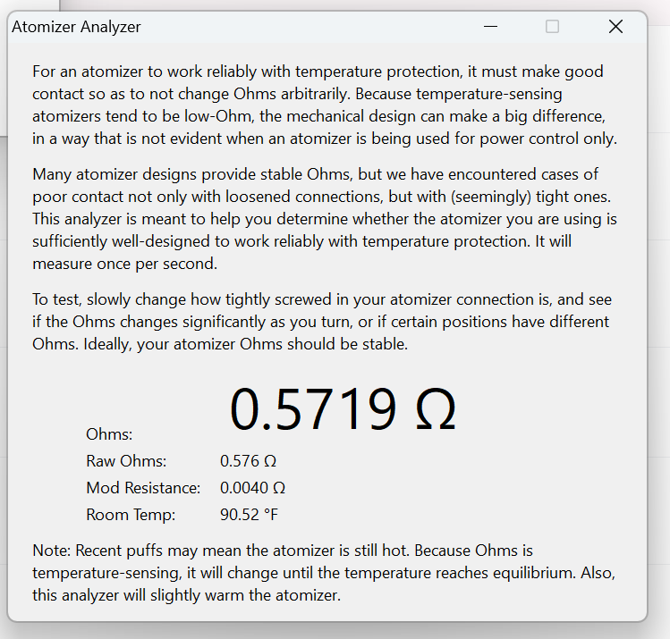

billylangen Posted January 13 Report Posted January 13 (edited) Hi everyone, nice to meet you. I feel like there's something strange about my device. - First, “fill pod,” but that was all resolved after a firmware update. - Second, the ohms on the cartridge have changed. The cartridge I'm using is an antiburn 0.8 ohm, but the device detects 1.2 ohms, and another thing is, when viewed on Escribe, the detected ohms are 0.5xx. With the cartridge now showing 1.2 ohms, the power output isn't optimal, and there's stuttering when inhaling. How can I resolve this issue? FYI, the current firmware version is V130.1, and the Escribe version is 2.0 SP7.1.1. Thanks, friends. Edited January 13 by billylangen add more information about ohm
Wayneo Posted January 13 Report Posted January 13 5 hours ago, billylangen said: - First, “fill pod,” but that was all resolved after a firmware update. Under the escribe 'safety' tab are options to lower or even turn off 'fill pod' warnings. 5 hours ago, billylangen said: - Second, the ohms on the cartridge have changed. The cartridge I'm using is an antiburn 0.8 ohm, but the device detects 1.2 ohms, and another thing is, when viewed on Escribe, the detected ohms are 0.5xx. There are ranges of resistance for what the coil Ω's displays as. Yours is now in the 1.2Ω range by 2 hundredths of an ohm. Your 'wrong ohms' issue is harder to explain but could be due to your coil raising its resistance due to getting crusty/carmelized from use and/or dirty contacts. Those factors or others, have raised the resistance to be in the 1.2Ω coil range My simple explanation - https://forum.evolvapor.com/topic/76108-oxva-xlim-pro-2-dna-resistance-issues/#findComment-945868 More detailed explanation (same post) - https://forum.evolvapor.com/topic/76108-oxva-xlim-pro-2-dna-resistance-issues/#findComment-945933 2
