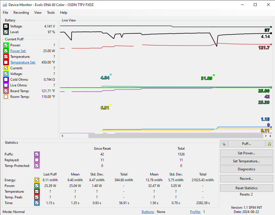

 why is my dna60c always 90.00 up stable board temp compare to my dna60 is 80.00-90.00 getting me confused maybe there's something need to fix for it

Difficult to explain, but you NOT being a TC user THERE IS NOTHING REALLY TO WORRY ABOUT.
The board is sold with default parameters programmed. Quality mfgr's will do their best to guesstimate the Thermal values to use. Some put these boards in a 3D printed housing, some metal, and others wood. Different materials heat and cool differently.
The 2 boards have different default values programmed.
Under 'mod' -> 'thermal' you can see the above differences. You can 'hover over' field names for official explanations.
Unfortunately YOU cannot run 'thermals' on either 60 because of that external/standalone USB charger. There's no communication path.
