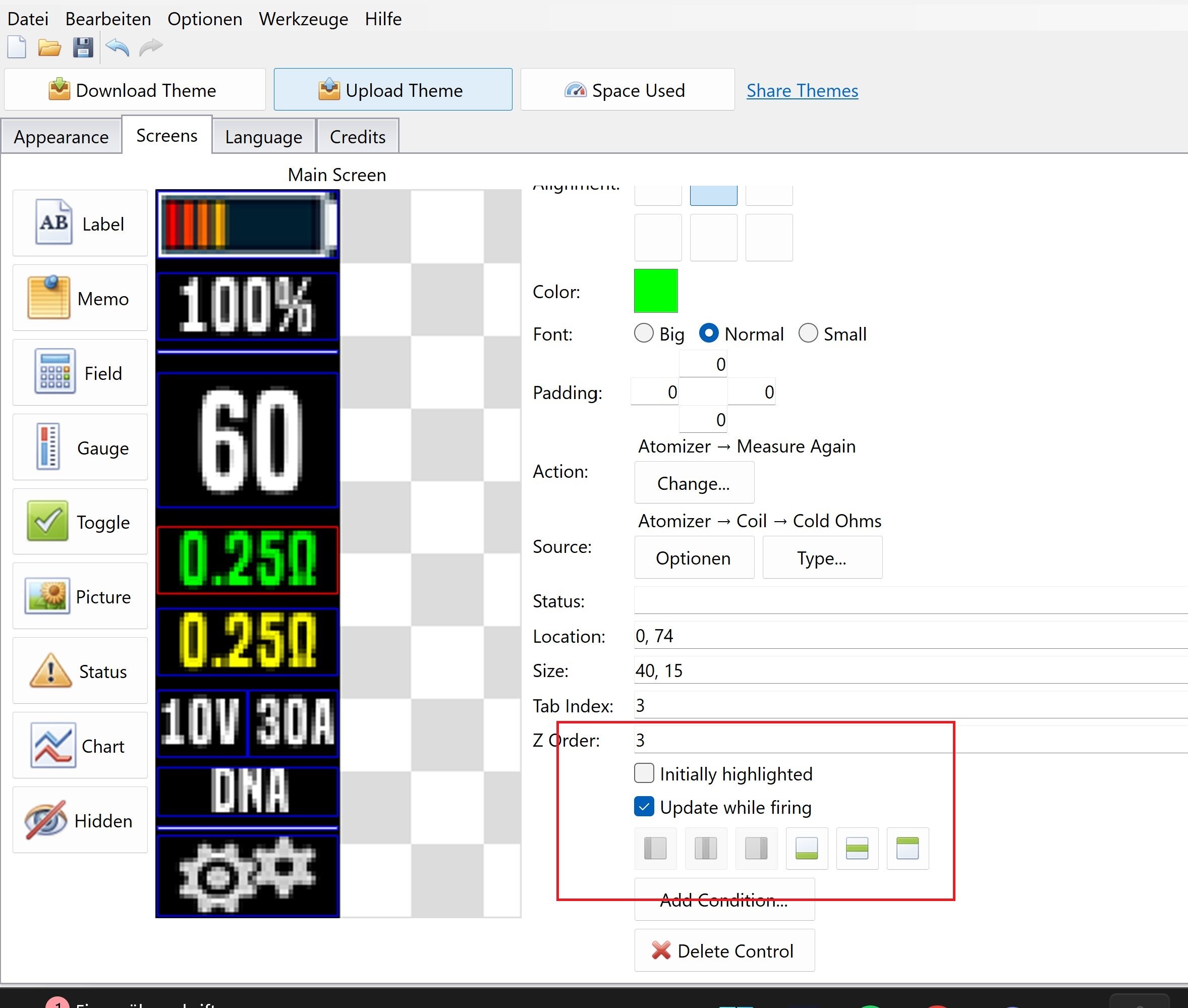

Hoschi2021 Posted yesterday at 08:56 AM Report Posted yesterday at 08:56 AM Hi i want my DNA60C to measure the Resistance while firing like the DNA60 does. How and where in Escribe can i place this Setting? THX in advance...
Wayneo Posted yesterday at 11:16 AM Report Posted yesterday at 11:16 AM That's in 'Theme Designer'. If you go to a field, on the RHS near the bottom you'll see the update while firing box to enable. 1
Hoschi2021 Posted yesterday at 12:08 PM Author Report Posted yesterday at 12:08 PM vor 51 Minuten schrieb Wayneo: That's in 'Theme Designer'. If you go to a field, on the RHS near the bottom you'll see the update while firing box to enable. found it, thank you so much
