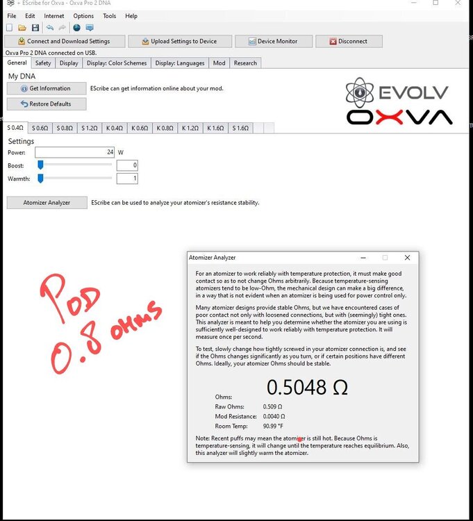

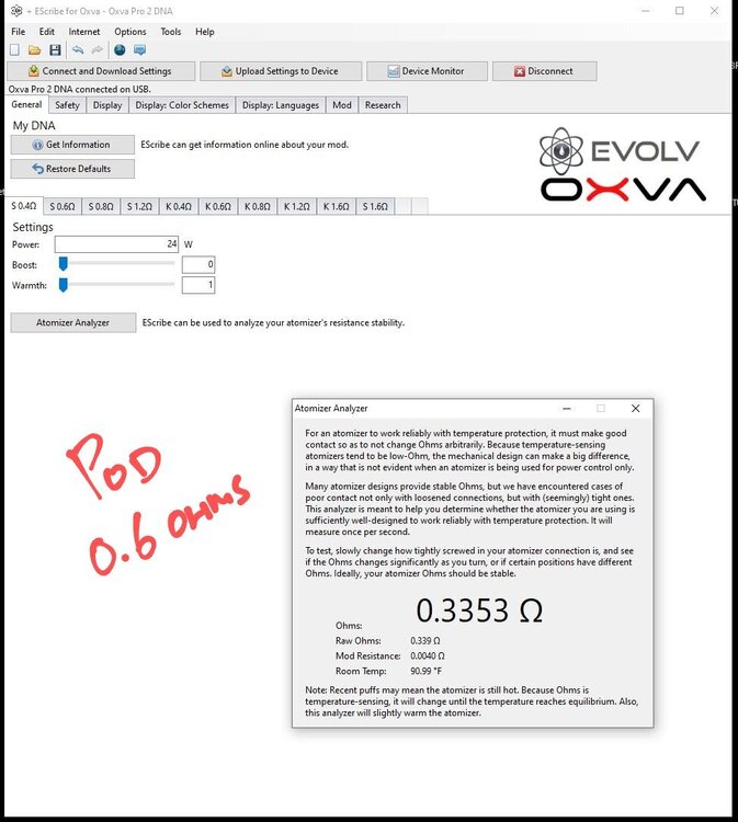

ZobiFun Posted October 5, 2025 Author Report Posted October 5, 2025 4 minutes ago, fp1 said: Sad to hear that man, hope you'll get a proper device with a fully functioning chip. Good luck 🍀 Also, just curious. What resistance readings you get on the software for your pods? In my case, all my pods are supposed to be 0.6Ω and 0.8Ω, but they consistently read as 0.33Ω and 0.50Ω on the official software.
fp1 Posted October 5, 2025 Report Posted October 5, 2025 Cold resistance is the same as yours, it goes to 0.8ohm when hot. 0.8ohm is the hot resistance, while "cold" is 0.50/0.55 You can go to device monitor in escribe and see it by yourself, your 0.8 ohm coil should go from 0.50 to 0.78-0.8 if it goes above that it means that coil is dry and anti burn will kick in.
ZobiFun Posted October 5, 2025 Author Report Posted October 5, 2025 8 minutes ago, fp1 said: You can go to device monitor in escribe and see it by yourself, your 0.8 ohm coil should go from 0.50 to 0.78-0.8 if it goes above that it means that coil is dry and anti burn will kick in. You mean the Live Ohm in the device monitor? My 0.8 pod goes from 0.5 to 0.62 when I vape. That also does not seem right
