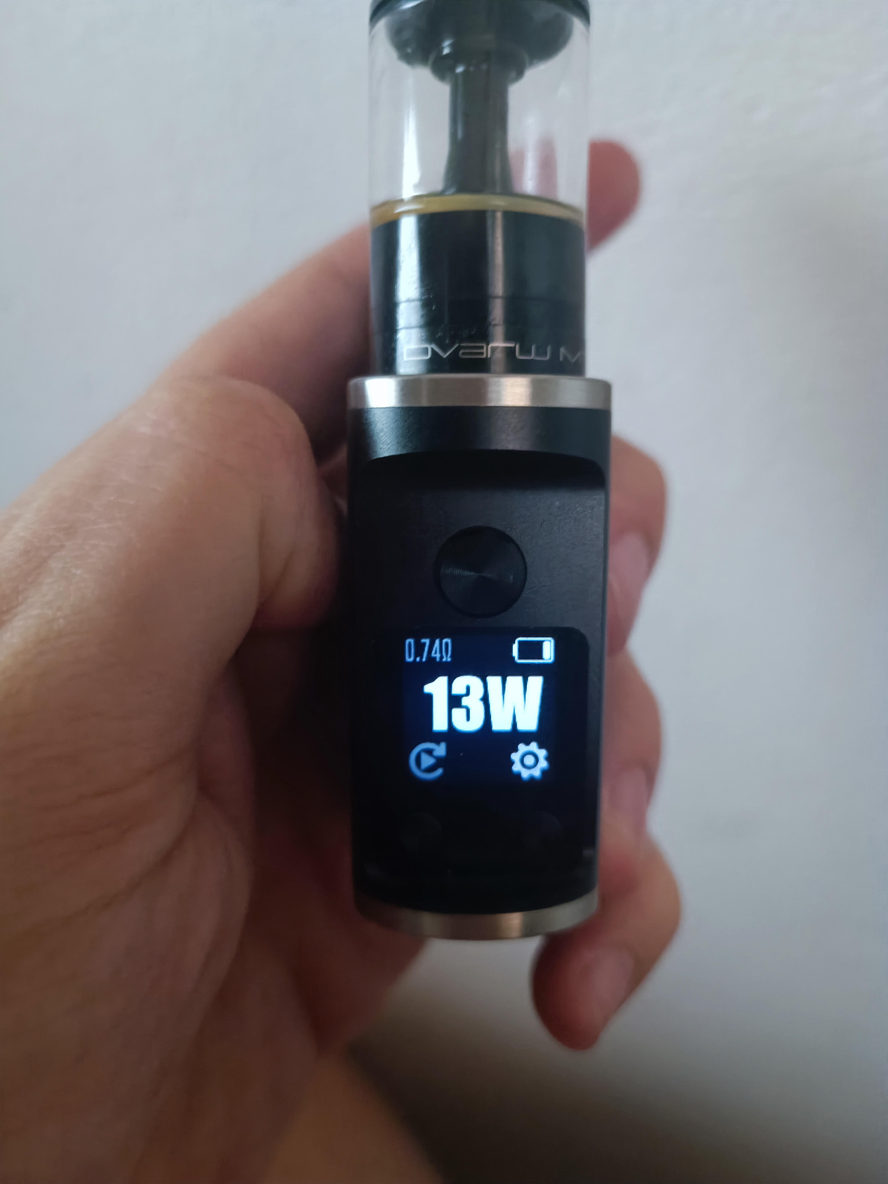

Strnys Posted September 24, 2025 Report Posted September 24, 2025 I bought a paramour sbs dna80c and the battery shows a bad charge level, at about 3.5V the mod shows that the battery is discharged but when I use the same battery in the dna60 it shows me the correct value can you please advise me if it is possible to set or adjust it somehow so that it shows the correct values? it is not the battery I tried to replace it with another one but it is the same situation

Strnys Posted September 24, 2025 Author Report Posted September 24, 2025 (edited) 1) nope... discharged not check battery 2) not icon only status of batery (show 0 of 4 part of batery) 3) value is around 3,5V in echternal charger or dna60 i tried batery molicell P42a(4200mah 30A) samsung 40T(4000mah 35A) golisi s35 (4000mah 40A) using only MTL around 13W if i using Escripe batery status is discharged and i pufs it shows right above 3,5V in test pufs Edited September 24, 2025 by Strnys

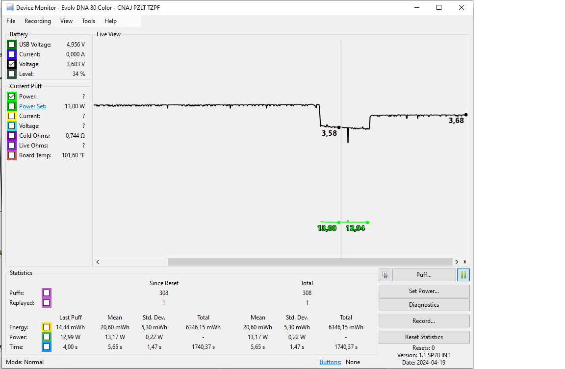

Wayneo Posted September 24, 2025 Report Posted September 24, 2025 If you start Device Monitor and enable volts and power, you can see how each mod is operating with your batteries. Here, with an almost 10 year old Sony 18650, for my 30 watts, the voltage drop is ~.55V (not good). When the lowest V (middle vertical line hits ~3V) I'll need to recharge.
Strnys Posted September 25, 2025 Author Report Posted September 25, 2025 (edited) my problem is this drop to 3,5 V seems good but on mod i see only 1/4 battery level which does not correspond and if V drop under 3,5 mod shows 0/4 baterry level but sill working normaly Edited September 25, 2025 by Strnys
Wayneo Posted September 25, 2025 Report Posted September 25, 2025 20 hours ago, Wayneo said: In the 80C you cannot adjust the battery curve which controls the icon or the low cutoff value, as you can in the 60 and 60C. You can open a 'Help Desk' ticket and ask them to fix it. Link in my signature line
