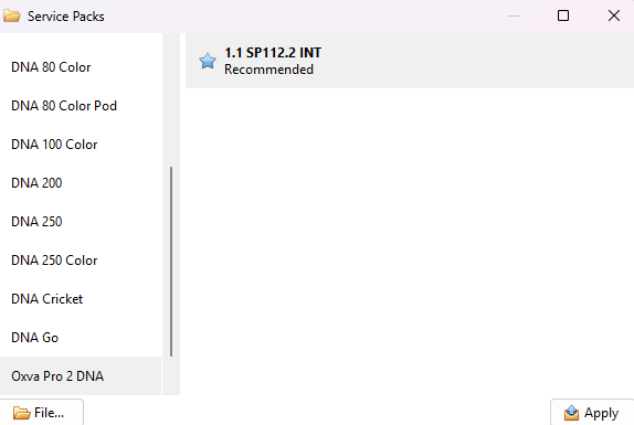

Wayneo Posted 20 hours ago Report Posted 20 hours ago Start escribe with mod plugged in. It's the bottom option of 'Tools' called Apply Service Pack.
timinho111 Posted 20 hours ago Author Report Posted 20 hours ago vor 3 Minuten schrieb Wayneo: Start escribe with mod plugged in. It's the bottom option of 'Tools' called Apply Service Pack. I did and nothing changed.
Wayneo Posted 20 hours ago Report Posted 20 hours ago Did you see the Oxva folder, and upload what was in there? Show me a screenprint please.
timinho111 Posted 20 hours ago Author Report Posted 20 hours ago (edited) vor 9 Minuten schrieb Wayneo: Did you see the Oxva folder, and upload what was in there? Show me a screenprint please. you mean this? Edited 20 hours ago by timinho111

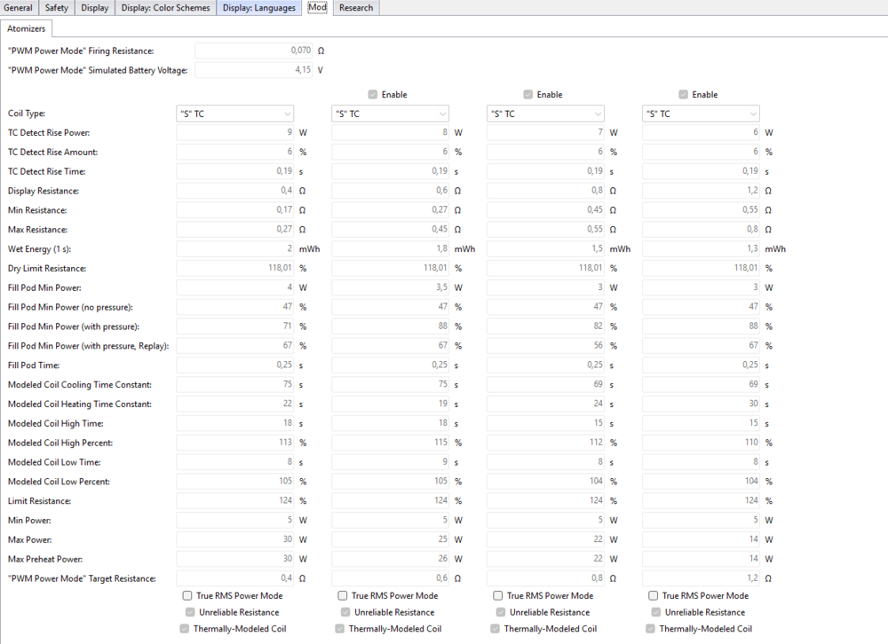

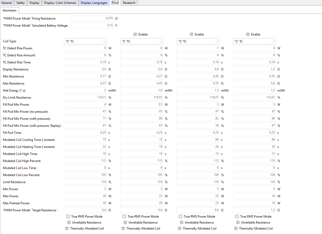

Wayneo Posted 20 hours ago Report Posted 20 hours ago Yup, and great. That/this version will now update you to to future firmware updates. Now go to 'About Escribe'. Click the teardrop in the logo 7 times. It'll like flash the screen. Go to the Mod tab. The last line under each column shows the 'coil resistance'. The 4th one from your diagram shows 1.2Ω. Go 7 down from the top 'Max Resistance'. Change .78 to .88 The SS1.6 is the last one, of 10 Go 7 down from the top 'Min Resistance'. Change .78 to .90 Might as well change Max Power (near the bottom) to 14. Upload settings to mod. Lemme know the results. This hould als fix 'fill pod'
timinho111 Posted 19 hours ago Author Report Posted 19 hours ago (edited) vor 34 Minuten schrieb Wayneo: Yup, and great. That/this version will now update you to to future firmware updates. Now go to 'About Escribe'. Click the teardrop in the logo 7 times. It'll like flash the screen. Go to the Mod tab. The last line under each column shows the 'coil resistance'. The 4th one from your diagram shows 1.2Ω. Go 7 down from the top 'Max Resistance'. Change .78 to .88 The SS1.6 is the last one, of 10 Go 7 down from the top 'Min Resistance'. Change .78 to .90 Might as well change Max Power (near the bottom) to 14. Upload settings to mod. Lemme know the results. This hould als fix 'fill pod' You have been a great help! It works! THANK YOU VERY MUCH! edit: ok was too excited a little early it now shows "Fill Pod" every time. It correctly detects it as 1.2 Ohm now, but directly shows me fill pod when drawing. Edited 19 hours ago by timinho111

Wayneo Posted 18 hours ago Report Posted 18 hours ago Alrighty then. If you look at the 3 pressure settings, the ones for the 1.6Ω coil are different than all the other SS's. I'd change those to match the others. Starting from 'Fill pod, min power. and down' to 47, 88, 67. I can't vouch if those are accurate so your 'fill pod' might be off for the 1.6Ω Edit: I'm not comfortable doing all this without working with a person, like I've done with you. If you don't mind, at the end I'd like to hide this post.
timinho111 Posted 18 hours ago Author Report Posted 18 hours ago vor 23 Minuten schrieb Wayneo: Alrighty then. If you look at the 3 pressure settings, the ones for the 1.6Ω coil are different than all the other SS's. I'd change those to match the others. Starting from 'Fill pod, min power. and down' to 47, 88, 67. I can't vouch if those are accurate so your 'fill pod' might be off for the 1.6Ω Edit: I'm not comfortable doing all this without working with a person, like I've done with you. If you don't mind, at the end I'd like to hide this post. Will try this tomorrow (from Germany so already 8pm here and need to bring my kid to bed haha). The hiding is totally fine for me. I get your point. I also saw you replied on reddit to my comment. Will delete the link to this topic also from there to have no links to this post on there.

timinho111 Posted 5 hours ago Author Report Posted 5 hours ago vor 13 Stunden schrieb Wayneo: Alrighty then. If you look at the 3 pressure settings, the ones for the 1.6Ω coil are different than all the other SS's. I'd change those to match the others. Starting from 'Fill pod, min power. and down' to 47, 88, 67. I can't vouch if those are accurate so your 'fill pod' might be off for the 1.6Ω Edit: I'm not comfortable doing all this without working with a person, like I've done with you. If you don't mind, at the end I'd like to hide this post. Perfect, this was the final adjustment needed. I matched the Fill Pod settings from the 1.2 and 1.6 and now I can do 12W with the detected 1.6 and its not telling me to "Fill Pod". Thanks a lot again!!! You can hide this now I think
