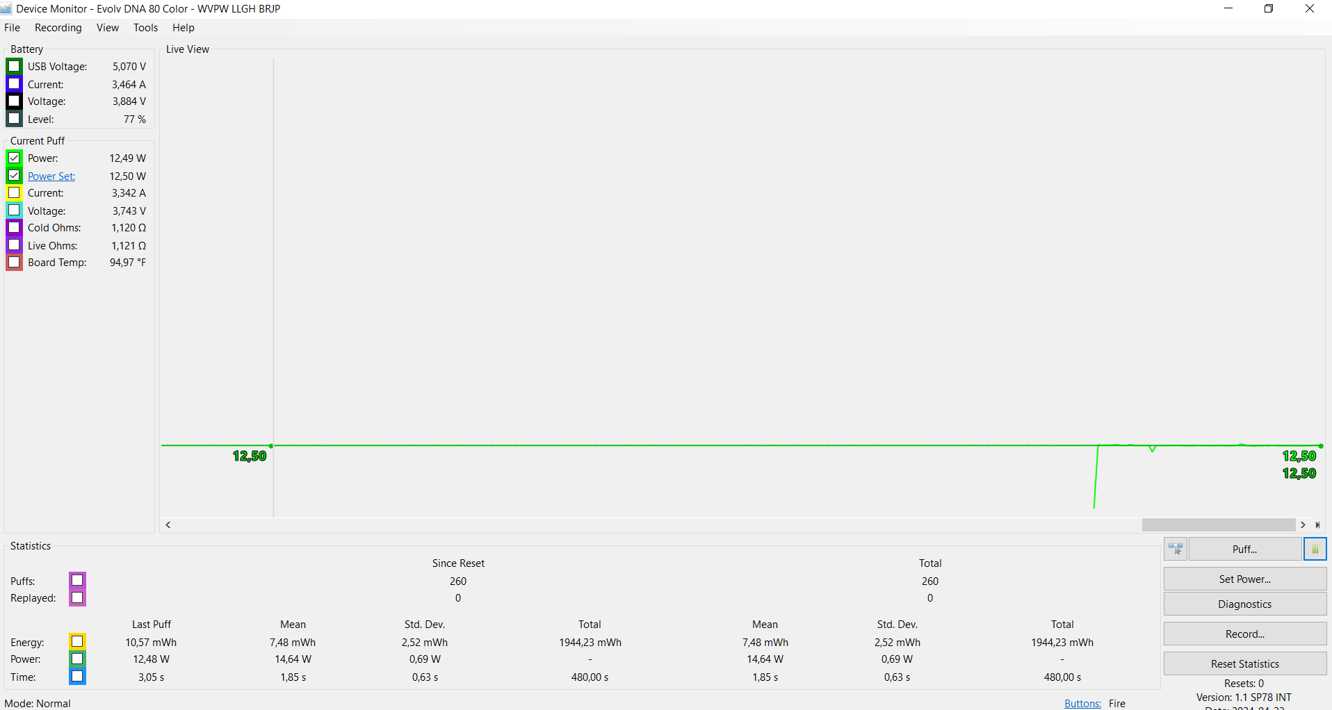

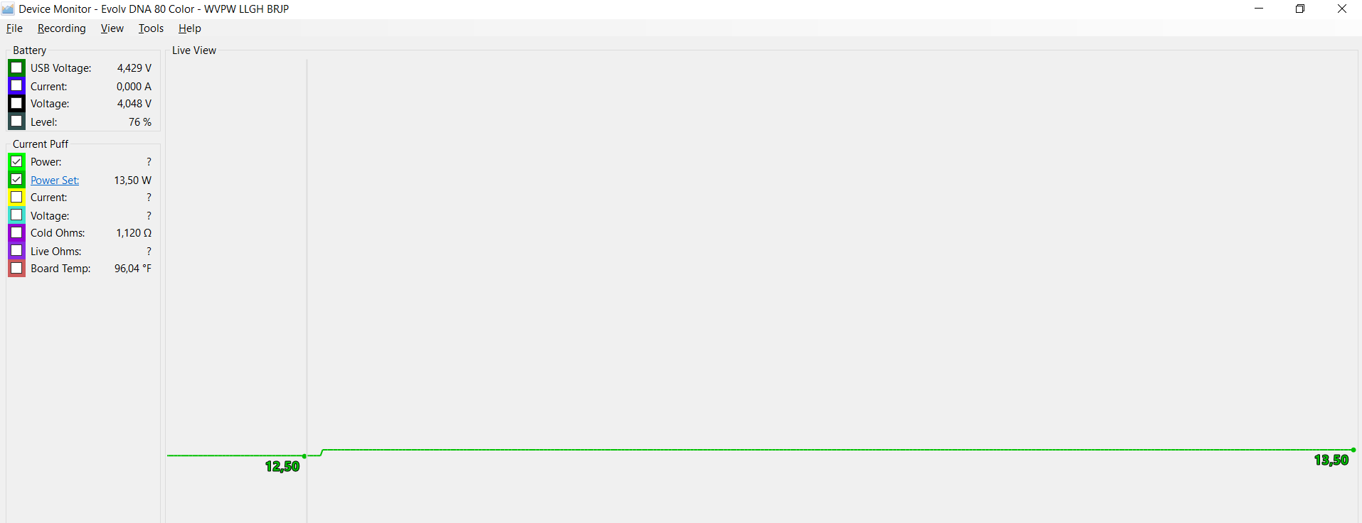

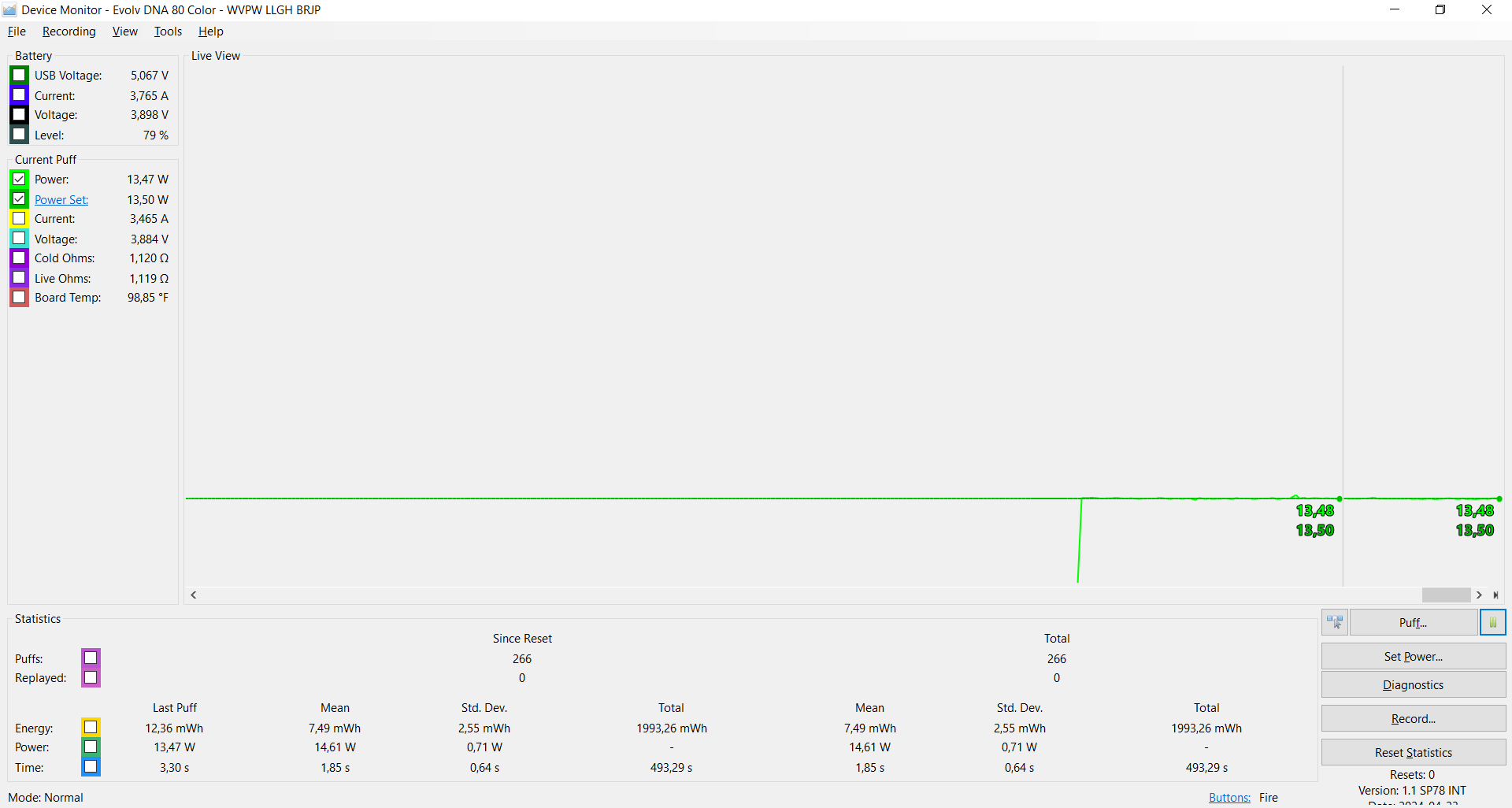

Wayneo Posted July 30, 2025 Report Posted July 30, 2025 3 hours ago, Zsee said: So does it mean that currently there is no option or workaround to change the increment value to other than 1? Yes. 3 hours ago, Zsee said: I tried to set decimal wattage value in EScribe, for example 20.5 W, EScribe accepts that value, I can also upload it into the device. Turn off boost/warmth on mod. Start 'Device Monitor', only enable 'power' 'power set', <- that shows what is set, take a puff, hit pause, hover mouse over the lines. 1
Zsee Posted July 31, 2025 Author Report Posted July 31, 2025 (edited) I uploaded 12.5W value via EScribe (maybe my regional win settings swapped the dot to comma in the input box) but I couldn't zero out the Warmth. It seems that board accepts and can handle that value I increased the wattage with 1W on the mod, it keeps the decimal value (but mod's display cuts it off). And I cannot set the fractional increase anywhere. Edited July 31, 2025 by Zsee 1
