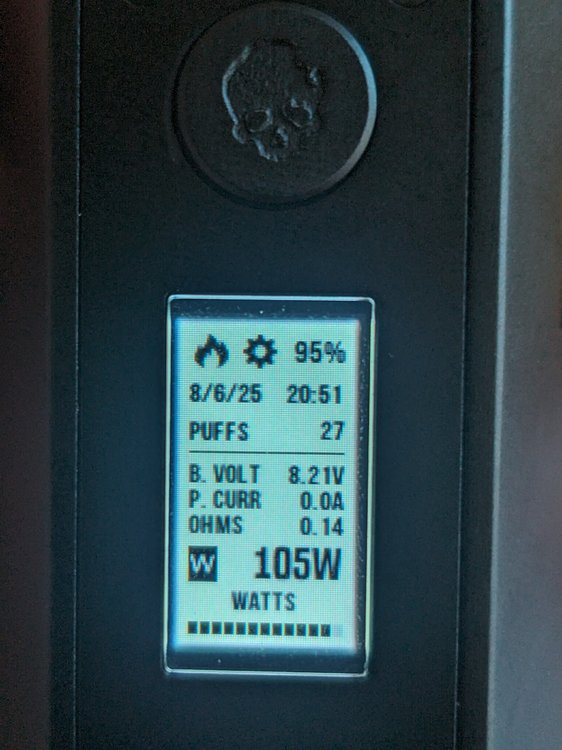

3n3rg3ia Posted June 8, 2025 Report Posted June 8, 2025 Greetings to the forums Some days ago i purchased a brand new Odin v2 with DNA 250c and it came to my attention that, when changing the brightness of the screen from lvl 5 up to 10 it doesnt increase at all, zero notice even in dark environment, i can barely see the screen on the mod when outdoors, and i dont mean under direct sunlight of course. Same situation was happening on another brand new unit as well, and im curious if this is normal for this model or is it a faulty screen? The chip itself works like a charm on both devices that i tried and vaped with. Just the screen and a little bit of flimpsy fire button Thanks in advance.

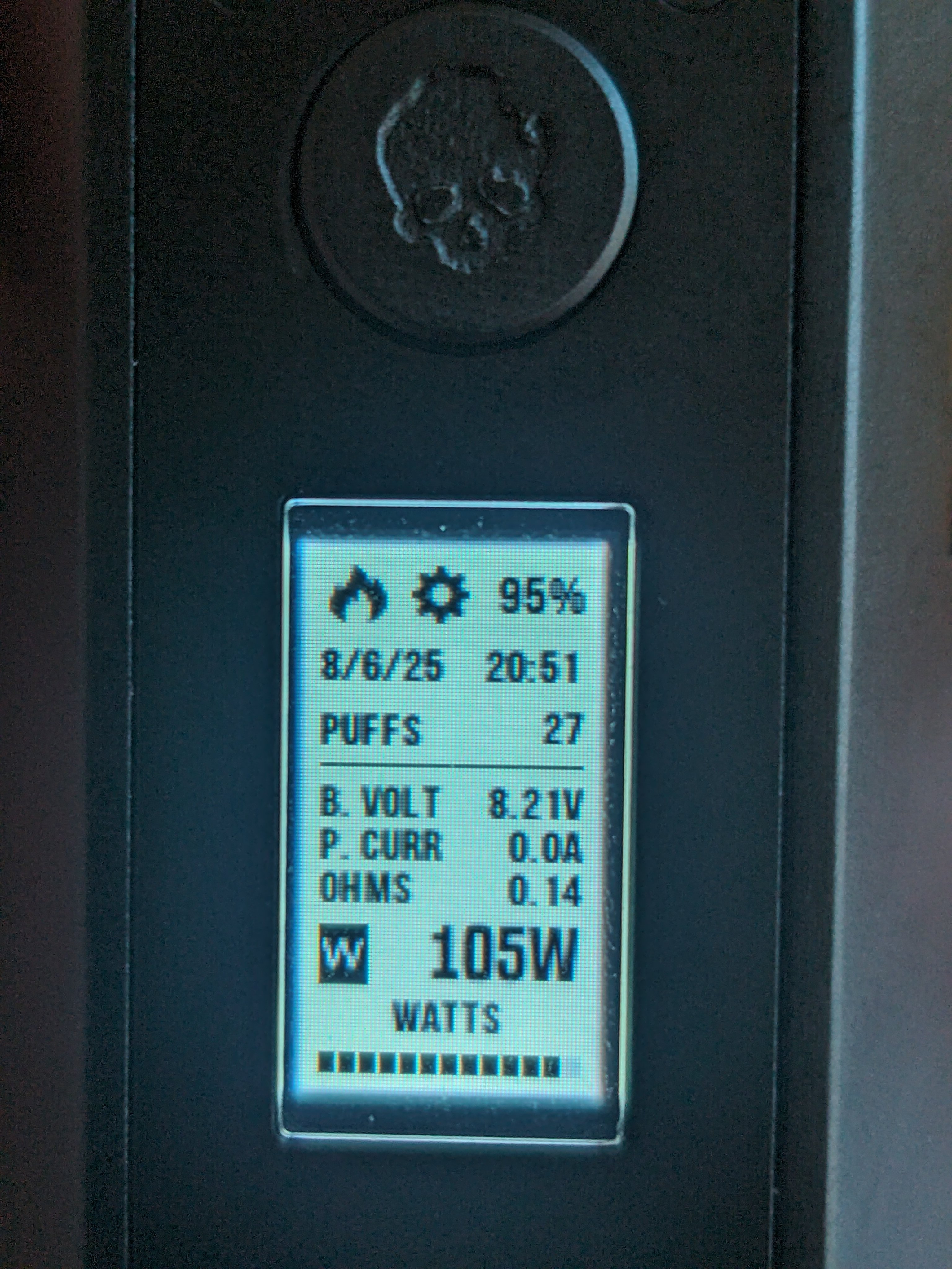

3n3rg3ia Posted June 9, 2025 Author Report Posted June 9, 2025 6 ώρες πριν, Wayneo είπε: If you're wearing polarized sunglasses you'd have to turn the mod sideways outdoors, but certainly should be visible in a dark environment. Or perhaps a 'cleaner' theme for better clarity. The theme I use has no 'wallpaper' so it's solid black background. Have yourself a good Sunday also. I'm not wearing any glasses at all, and i did tried some themes from the forums as a first thing to do with a DNA since it's a unique and amazing feature, and the brightness is the same to all the ones i tried. now I'm using a white theme with no colours and tweaked some labels to match my preferences. I made no other changes to anything else on escribe, i wouldn't touch something without knowing since i have no experience with DNA chip. i felt the people on the store wasn't very positive to replace the mod again because one of them told me that i shouldn't use the brightness above 5 because it drains a lot of battery 🙂 I have no idea what i must do. But I'll ask them again tomorrow. The photo i attached is captured in a very low light room and I don't mean sunlight, it was 8 afternoon and it really feels dim. No stealth mode at all.
