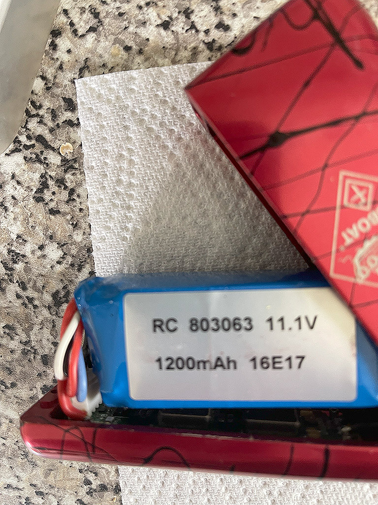

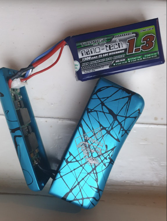

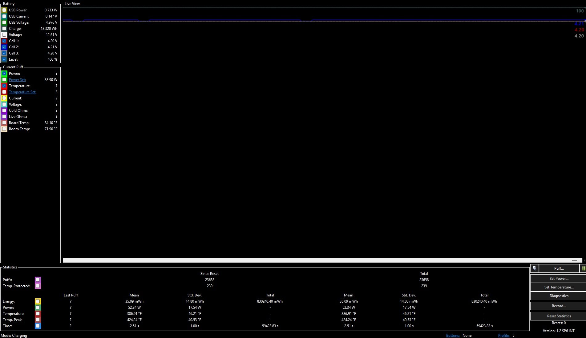

u8myufo Posted June 1 Report Posted June 1 Hi, I posted this on POTV yesterday and was advised to join up here and get some advice. I am thinking I may well need to replace the lipo on the Tugboat DNA250. The battery was showing 80% this morning, vaping at 0.3ohm from around 38 watts, it then went down to almost 25% within a few hours, and that was not vaping constantly. I am assuming the battery is wanked or maybe there`s a fault elsewhere in the circuit causing it? Anyhow, has anybody had some experience in this so they can advise on a brand of battery I should be looking for that will fit? I am wondering if the pic of the battery that is in it is even an original, or has perhaps been replaced at some point. It was also suggested that the Lipo could be out of balance and needs checking, I`m thinking then that if that is the case it simply equates to one of the cells being shot, in which case I need a new battery. Not having a meter to test it with I`m hoping an RC shop could perhaps do that for me. I have seen how it`s done but as there are two wires soldered to the board, could it still be checked just by pulling off the white connector? Any help or advice appreciated, the red mod is mine and the blue one is from an old post, that I assume would have been an original battery.

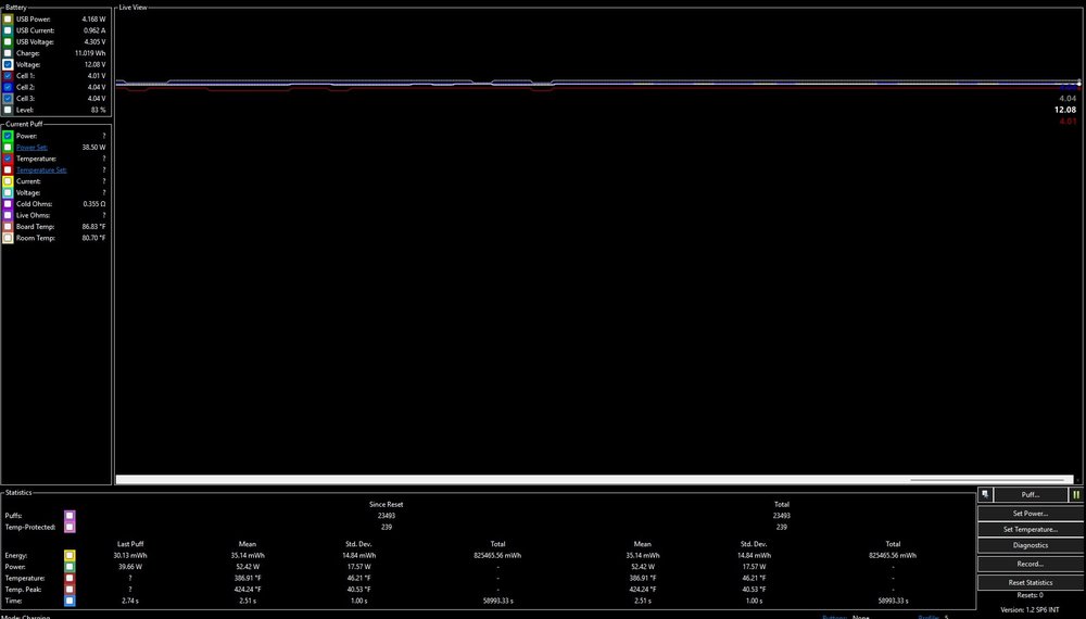

Wayneo Posted June 1 Report Posted June 1 Let's first check if the battery is out of balance. No meter required as cell voltages are shown in 'Device Monitor' Start escribe with your mod plugged in, then Device Monitor. Only enable/click the ‘cell 1’, ‘cell 2’ and ‘cell 3’ fields as shown on the left hand side. Post a full screenshot. ⬇️ Screenshot instructions in my signature line. ⬇️

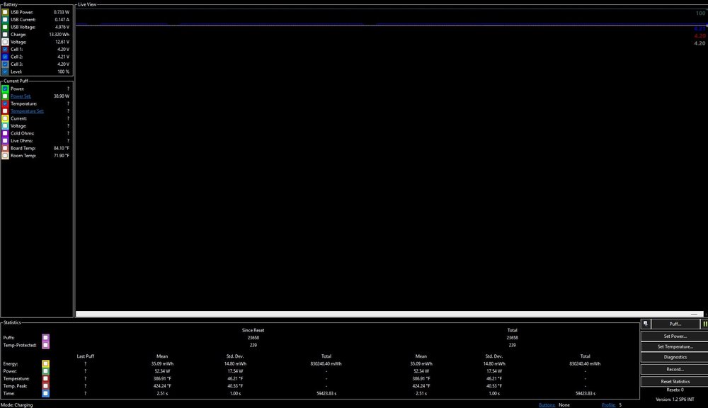

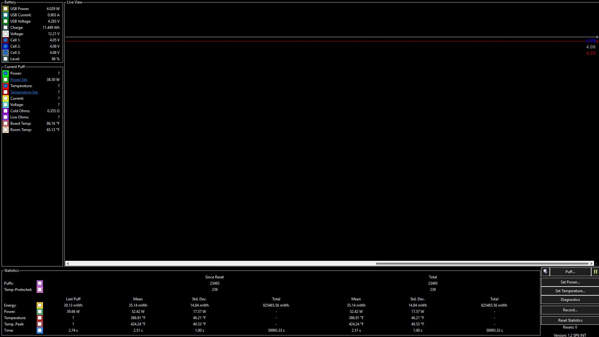

u8myufo Posted June 1 Author Report Posted June 1 Here you go @Wayneo, themonitoring just kept going so was not sure if it had to be done for a certain time or not.

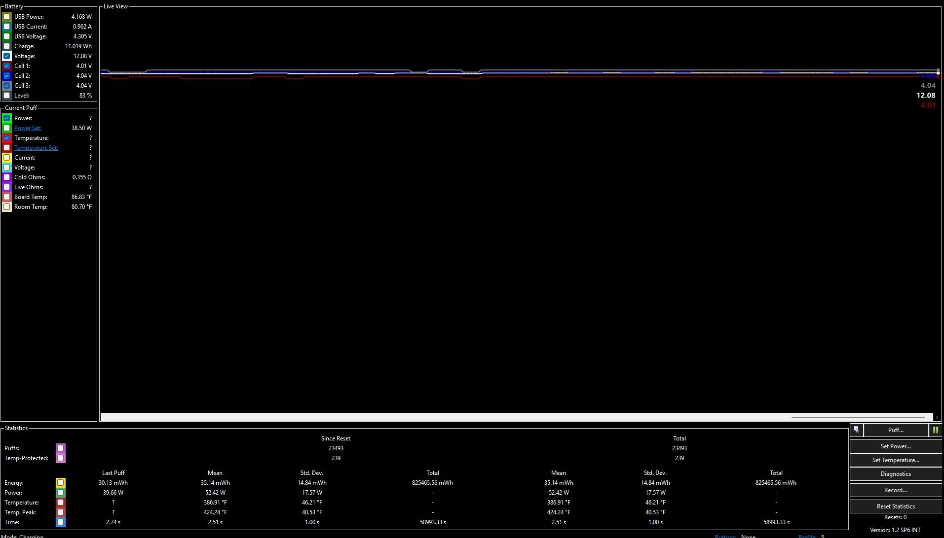

u8myufo Posted June 1 Author Report Posted June 1 I just noticed that the voltage box was already checked on the first pass, so unchecked it and ran it again. Not sure if I should have or not though.
Wayneo Posted June 1 Report Posted June 1 12 minutes ago, u8myufo said: ...... voltage box was already checked on the first pass, so unchecked it and ran it again. Not sure if I should have or not though. Did not matter at all. It's just the sum of the 3 cell voltages. If you look, they're all pretty much the same and your mod is charging ~1A. All looks good. At lower voltages that charging would be closer to 2A, and will now continue to decrease from 1A the closer it gets to full. Full could be 4.1V or 4.2V, depending on how the mod was setup. After it's fully charged, while plugged in, you could also enable 'Power' and 'Power set', take a puff, pause the screen and that will show how each individual cell is operating. You could post that screenshot if you want us to look at it. 1
u8myufo Posted June 1 Author Report Posted June 1 (edited) 28 minutes ago, Wayneo said: Did not matter at all. It's just the sum of the 3 cell voltages. If you look, they're all pretty much the same and your mod is charging ~1A. All looks good. At lower voltages that charging would be closer to 2A, and will now continue to decrease from 1A the closer it gets to full. Full could be 4.1V or 4.2V, depending on how the mod was setup. After it's fully charged, while plugged in, you could also enable 'Power' and 'Power set', take a puff, pause the screen and that will show how each individual cell is operating. You could post that screenshot if you want us to look at it. Ok thanks, will do it later as I`m going out. So my question would be then as it is the only Lipo mod I have, am I expecting too much from the battery regarding longevity for the day? I guess I am considering it`s only a 1200Mah battery. Is it possible to get a much higher Mah Lipo to put in or is that out of the question? Thanks once again for the help though. Edited June 1 by u8myufo
Wayneo Posted June 1 Report Posted June 1 3 hours ago, u8myufo said: ...... I guess I am considering it`s only a 1200Mah battery. Is it possible to get a much higher Mah Lipo to put in or is that out of the question? It's a 3 cell battery. That's 3@1200mAh, so 3,600mAh total or about a single 21700 battery. Your vaping habits will dictate length of usage. LiPo's will have lower voltage sag overall compared to a round cell (all things being equal). You are limited by the cavity size for what will fit inside. If you're lucky you might find a bigger cell but it would probably only be an extra 100-200 more mAh. Hobbyking has a LiPo sizer. I'd look at the dimensions of that Turnigy and use the sizer for other 3S batteries, or Amazon or an RC store. Edit: Your picture of yours looks like an OG 'Fullymax' battery, used by many vendors, including the Steamcrave Hadron Pros, but hard to find at retail. I have 6 LiPo mods and can say they like to be used, as they can easily get out of balance a little. Like your cell 1 which in all screenshots is 0.03V lower. That might add 10 minutes extra charge time. 1

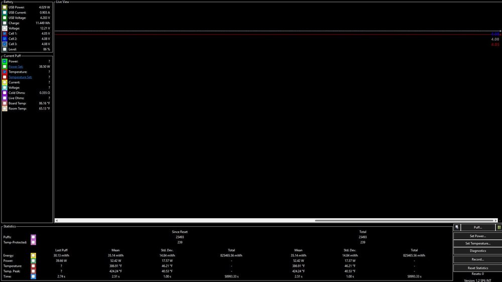

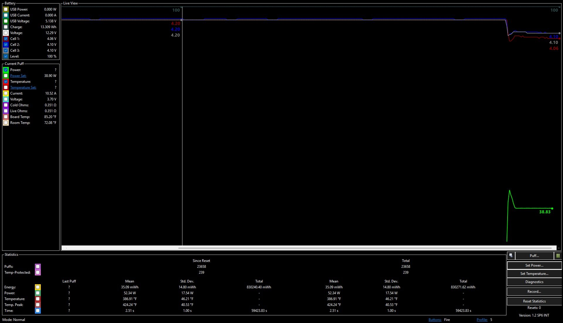

u8myufo Posted June 1 Author Report Posted June 1 Good evening @Wayneo, ok first screenshot is of fully charged, second screenshot is whilst taking a quick draw. 1
Wayneo Posted June 1 Report Posted June 1 I can see them all charged up in your first pic. In your 2nd you see cell 1 is 4 hundredths of a volt lower than cell 2 and 3. I'd say that's fine for that battery. Nothing new required. Earlier I said this and yours charged to 4.2V. From evolv's testing and mooch, by setting the charge limit to 4.1V you can save on battery life. You might want to make that change when you get a new battery, or I can explain now. 8 hours ago, Wayneo said: Full could be 4.1V or 4.2V, depending on how the mod was setup. Enjoy your mod, the search bar works, and now you know where we are. 1

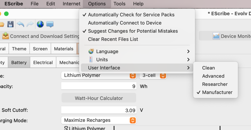

u8myufo Posted June 2 Author Report Posted June 2 Thanks once again for the help @Wayneo, ok that`s cool then. You can explain how to set the charging voltage up if youget a moment, and I`ll take a look. Seems like there`s no panic to install a new cell yet then so I can take me time searching one out for when the time comes, although the way me body is feeling nowadays it`ll be me who packs in first 😁

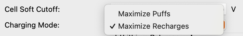

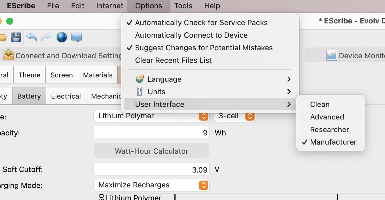

Wayneo Posted June 2 Report Posted June 2 Here you go, in 2 screenshots. 1st one opens up battery details, 2nd maximize puffs (4.20V) or Recharges (4.1V). Followed by Upload settings to device.
