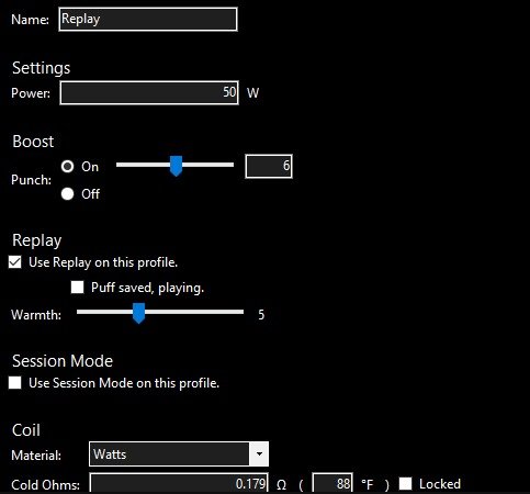

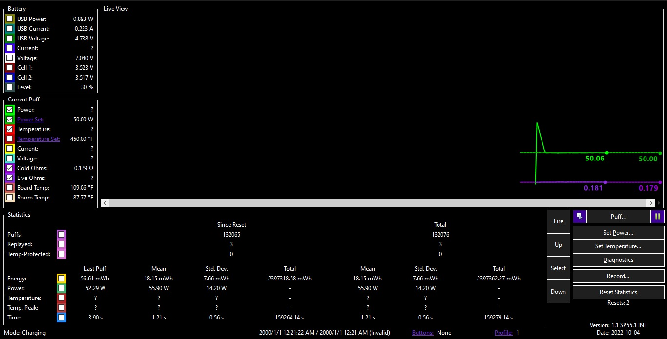

Wayneo Posted April 11, 2025 Report Posted April 11, 2025 Follow these steps and report back. In escribe (with mod plugged in), check you are in a 'profile' that has 'use replay on this profile' checked. Make sure for coil material it is 'watts' or something like that. (Not SS) Remeasure the resistance of your coil on the mod. Take a couple puffs and see if you can enable replay. If you cannot start replay, post an escribe screenshot of that profile. Start Device Monitor. On the left, click these checkboxes only. Power, power set, temperature, cold ohms, live ohms. And a full screenshot after taking a puff and pausing the screen.
