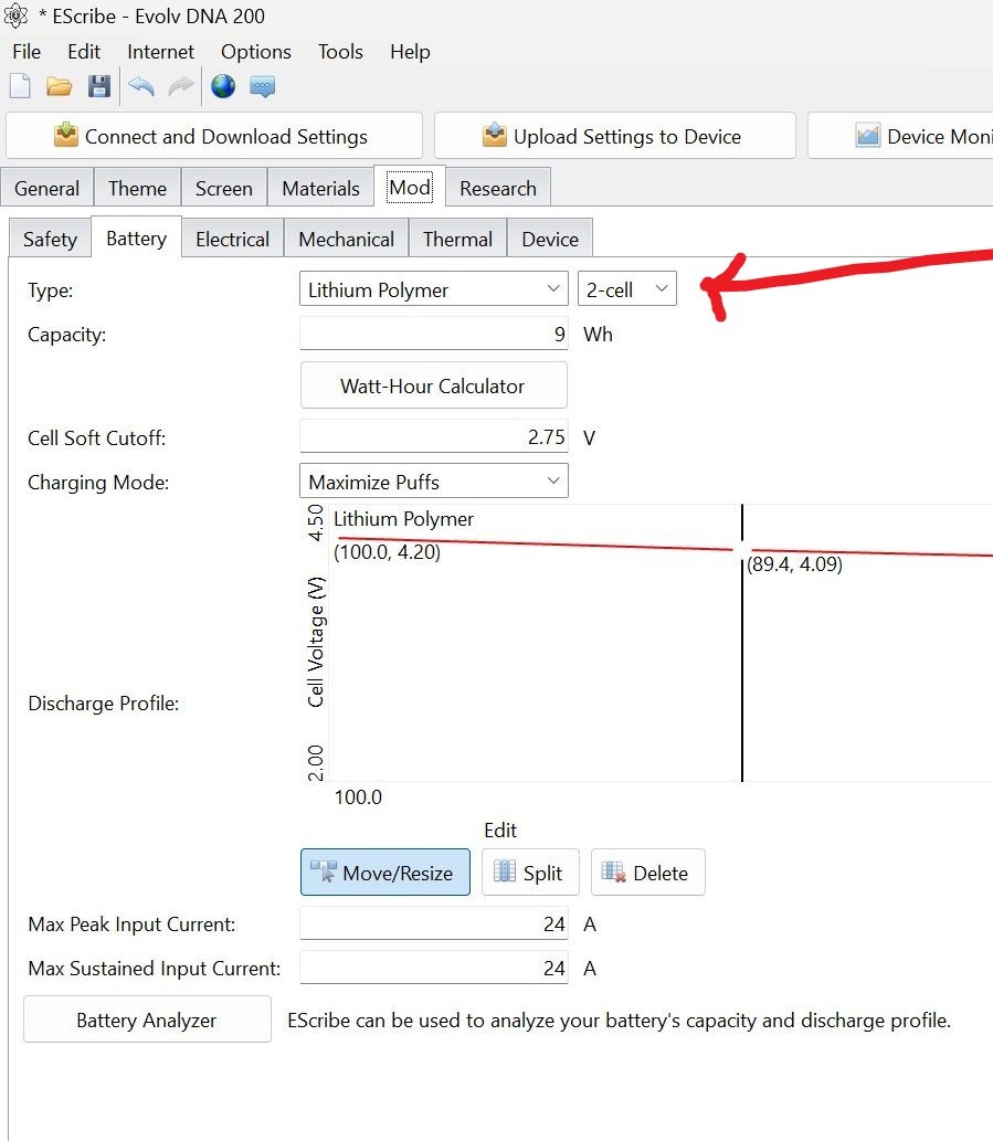

dwcraig1 Posted February 27, 2025 Report Posted February 27, 2025 Your battery settings in EScribe should look like this when using 2 cells. Does the mod still work?
Conanthewarrior Posted February 27, 2025 Author Report Posted February 27, 2025 (edited) 11 hours ago, dwcraig1 said: Your battery settings in EScribe should look like this when using 2 cells. Does the mod still work? Yes the mods battery settings in Escribe are set to that for dual 18650 use. The mod turns on with batteries in, but just shows an empty battery and will not fire a tank or RDA. Edited February 27, 2025 by Conanthewarrior
