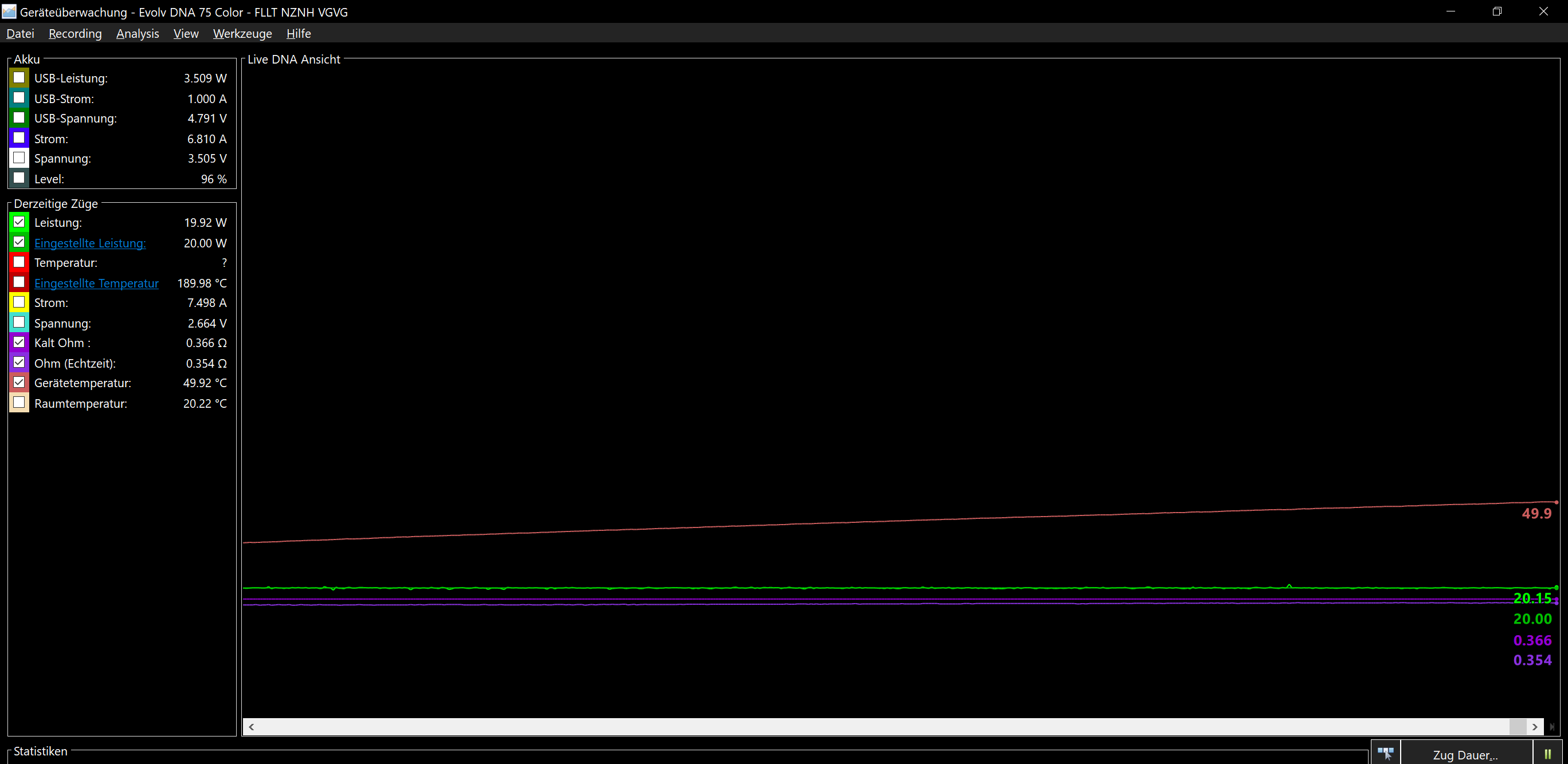

cloudzey Posted December 19, 2024 Author Report Posted December 19, 2024 vor 20 Stunden schrieb Wayneo: NO. What atomizer would that be? Can you do an escribe 'Device Monitor' screenshot while firing with only Power, Power Set, Cold Ohms, Live Ohms enabled Like this? I set the power at 20 Watts with temperature control, but the temperature control doesn't work so it just goes full power the whole time. The board temperature was going up even at this low power?
Wayneo Posted December 19, 2024 Report Posted December 19, 2024 What atty is that? Have you tried a different one on that mod?

Wayneo Posted December 20, 2024 Report Posted December 20, 2024 Yes, I understand the problem, but in my opinion you should focus on the board temp primarily. Afterwards we'll look at resistance. Plug in the 75C mod (nothing attached to the mod) How much does the board temp rise just sitting there and not being used? Note down temp after 2 minutes and 20 minutes after being plugged in. Leave mod and escribe running. Attach Bakx. How much does the board temp rise just sitting there and not being used? Note down temp now and 20 minutes after being plugged in. Report back those 4 temps like below , and battery description. 75C Nothing attached 2 minutes (temp here) 20 minutes (temp here) 75C bak attached 2 minutes (temp here) 20 minutes (temp here) 2
