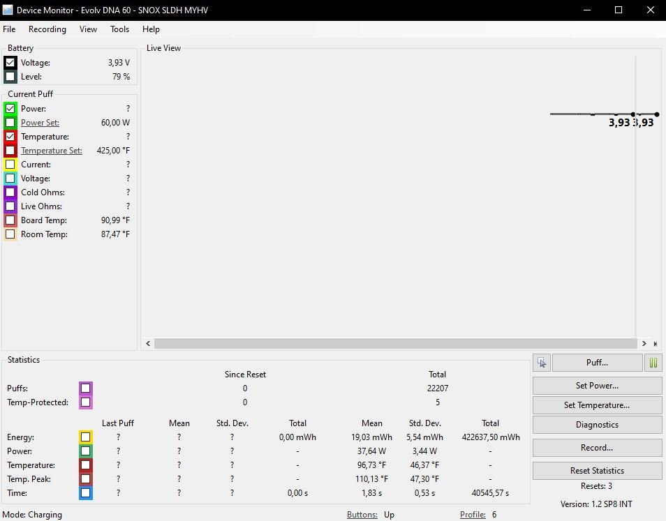

my device keep presing up button, even though i change the orientation, its still pressing power up button, how do i repair this guys ?

I'd start by pulling the button cover and check for juice ingress. Wipe down the silicon cover and button pcb with Isopropyl alcohol. While it's off check if Dev Monitor still shows pressed.
Then the same thing for the board itself. Use a soaked QTip to press the buttons many times.
