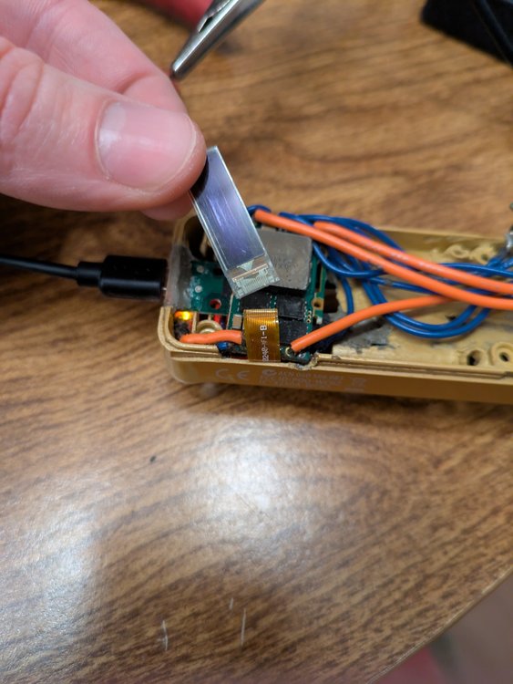

8bit Posted November 17, 2024 Report Posted November 17, 2024 (edited) My screen has disconnected from the ribbon cable and I'm wondering if it's possible to fix it. It doesn't look like the cable slides in to a slot on the screen. Is it attached with glue on one of the sides? If it's not possible to fix at this end is it possible to replace it and re attach to the board? Edited November 17, 2024 by 8bit
Wayneo Posted November 17, 2024 Report Posted November 17, 2024 At some revision the DNA40 screen connection was upgraded to a ZIF connector. You ought to open a Help Desk ticket (link in my signature line).
8bit Posted November 17, 2024 Author Report Posted November 17, 2024 Done. That does sound more secure. Would be nice if I could fix this one though so I don't have to go through the trouble of taking the board out.
