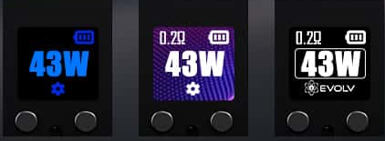

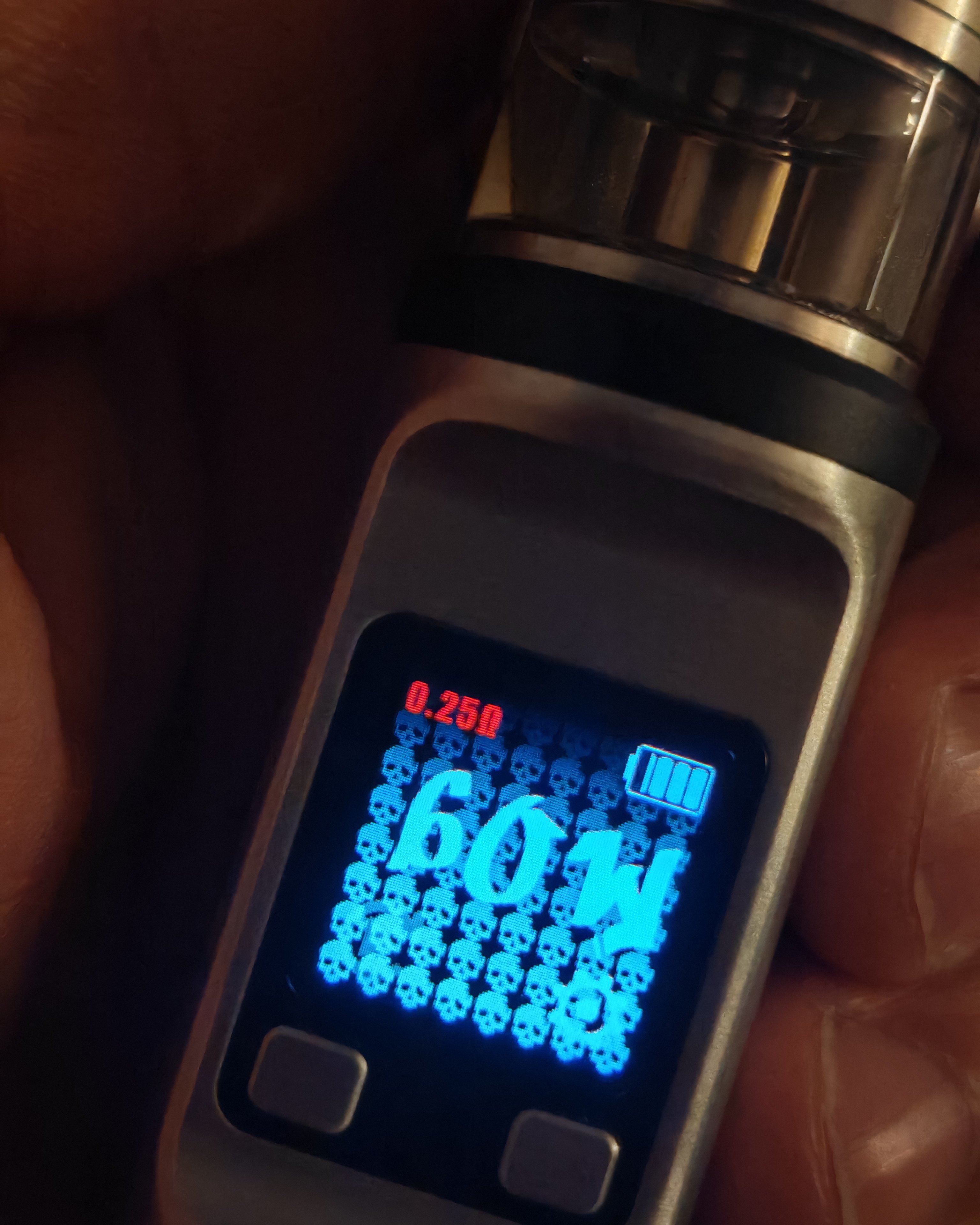

xu7jp4 Posted November 9, 2024 Report Posted November 9, 2024 I'll test it 👍🏻 Cheap chipset are very Bad for vaping.... Mine is Parsons Vaperz cloud Sbs with Taifun Gx 60w/70w 🫣 If anyone Can share theme tita X2 veepon or original theme dna80c 👀
Wayneo Posted November 9, 2024 Report Posted November 9, 2024 You can download the default theme from within escribe while your mod is plugged in, when it first starts up. Why do you want to remove 'Replay'? I use it with my 3 Taifun GX's just fine, even with Nichrome, SS, and Titanium.
xu7jp4 Posted November 9, 2024 Report Posted November 9, 2024 (edited) I have my original theme but not the others I use ni80 and replay don't work.... Edited November 9, 2024 by xu7jp4
Wayneo Posted November 9, 2024 Report Posted November 9, 2024 1 hour ago, xu7jp4 said: I use ni80 and replay don't work.... Try taking a longer puff, like 3 seconds. Describe your coil? I run my GX's at mid 40's, 2x24/32 n80.
