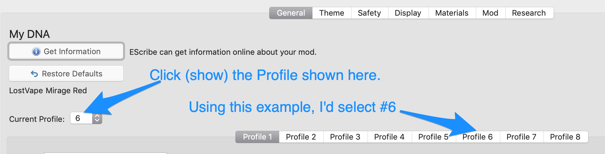

Ok like this ?
And about turn down the watts you mean while vaping or wicking cotton ?

Yes, excellent. And turn down the watts while vaping.
From your Profile 2 settings, with the DRv2 you are using everything basic. Any/every mod with no sort of boost, with fresh batteries should be almost identical at 55 watts.
