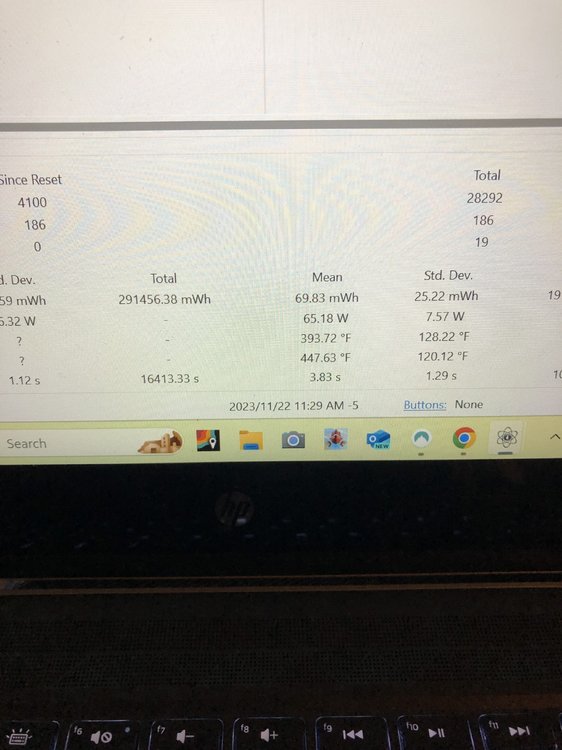

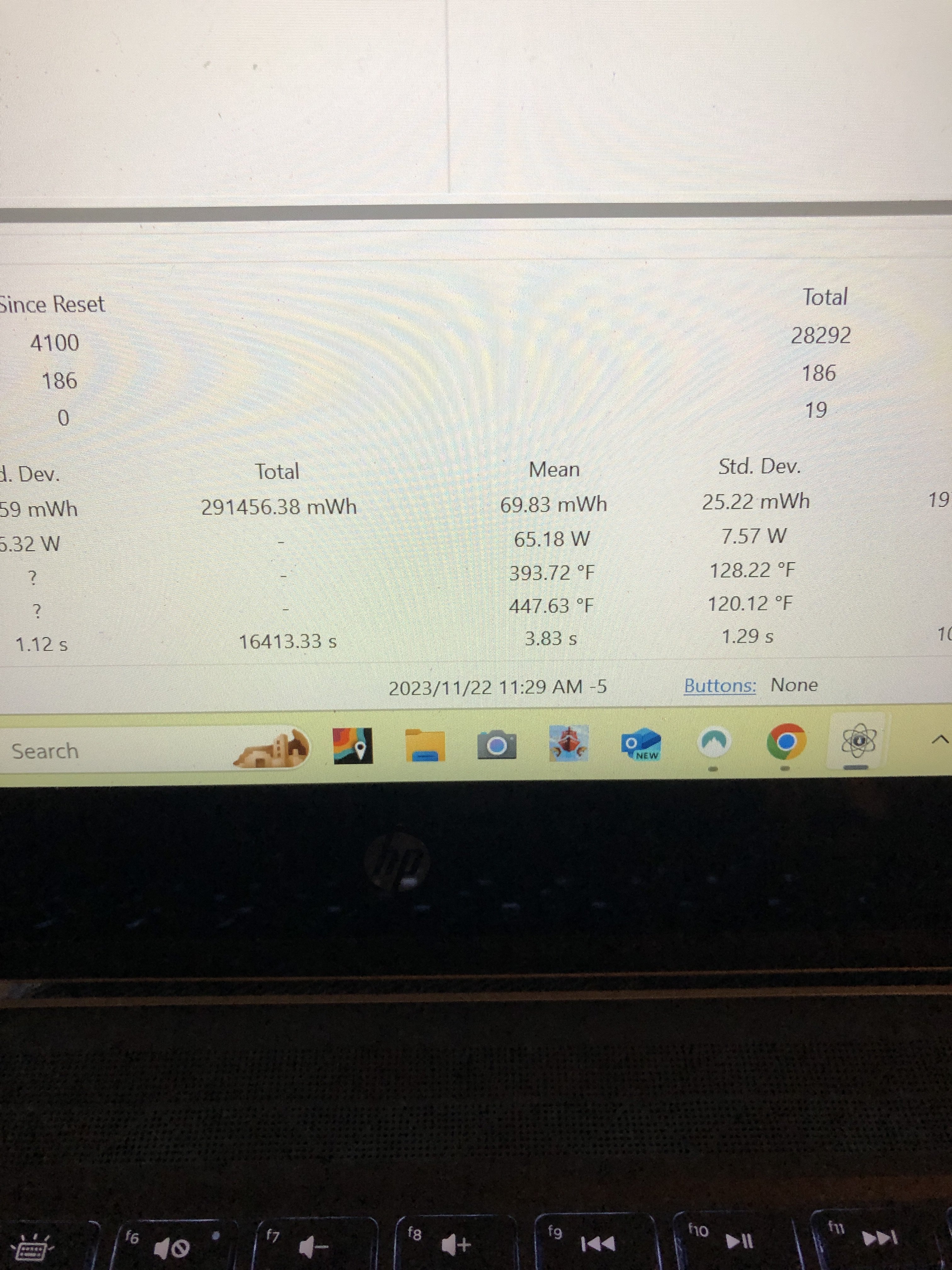

BlueALtra2013 Posted November 22, 2023 Report Posted November 22, 2023 I had changed the theme on my DNA250c and my puff count to 4100 since reset, I want my screen to reflect lifetime puffs 28292. It's been a long time since using Escribe and can't remember how to do it.
Wayneo Posted November 22, 2023 Report Posted November 22, 2023 If you were to look in theme designer at that field it should show 'Statistics -> since reset -> puff count' with a tick mark. Change that to 'statistics -> total -> puff count' then 'apply' when you're done making changes 1
